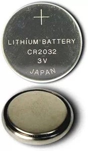

  • CR2032 battery
  • CR2032 battery holder

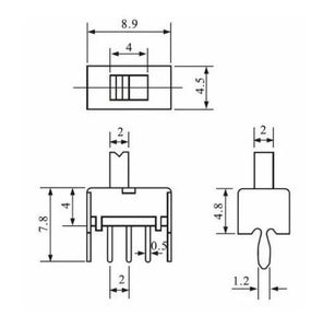

  • Microswitch 2 positions

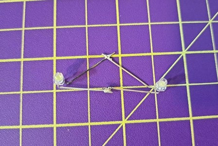

This circuit uses a 180 ohms resistor to limit the current. The two leds are in paralel.

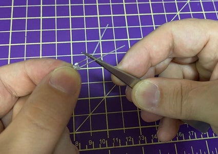

Bend the pins and solder in the way showed in the pictures:
1 - bend the longer leg to make it inclined
2 - bend the head of the led to make it perpendicular
3 - make a "U" format in the shorter pin.
4 - in the end, the two leds must be in a triangle shape

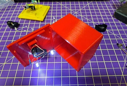

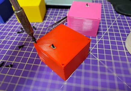

Step 4: Glue Everything and Close the Box
Test the leds before closing.
Step 5: Enjoy!
PS.: The pink and red look almost the same in the dark.
