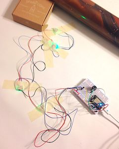

Step 3: Soldering the Neo-Pixel
Cut wire by approximating the distance between each NeoPixels
Solder all the +ve's of the NeoPixels using red Silicone Cover Stranded-Core Wire - 26AWG wire (Note: this wire is more flexible and thinner than normal bread boarding wire)
Solder all the -ve's of the NeoPixels using black wire
And follow the arrow marks on the NeoPixels to Solder the blue wire as shown in the picture.
Step 4: Uploading Code to Spark Core to Test Soldered NeoPixels
Connect the +ve red wire of the NeoPixels to the +ve rail of the bread board and the black wire to the -ve rail of the bread board.
Connect the blue wire to the D4 pin of the Spark Core.
Follow the documentation on the spark.io web site to setup and claim your spark core with your WiFi router at home http://docs.spark.io/start/
Once you have successfully claimed you core , use Web IDE https://www.spark.io/build
  1. Create a New App
  2. Copy and paste the code in the web IDE
  3. Include the NeoPixel library as shown in the screen shot above
  4. Use flash button to upload the code to your core (flash button on the top left hand side of the web IDE)
Step 5: Completing the Circuit- Adding a Pizeo
Connect the one pin of the Piezo to D0 pin of the spark core as shown in the picture above
And connect the other pin to ground rail
Inactivate the code in the loop section of the code that you use to test the NeoPixel library
Step 6: Tape the Neo-Pixels to the Poster
Adjust the NeoPixel's to fit the holes you carved out
Using electrical or normal tape stick the NeoPixels to the poster
Connect the Spark core USB cable to you laptop to check for loose connections and validate that all the NeoPixels light up
