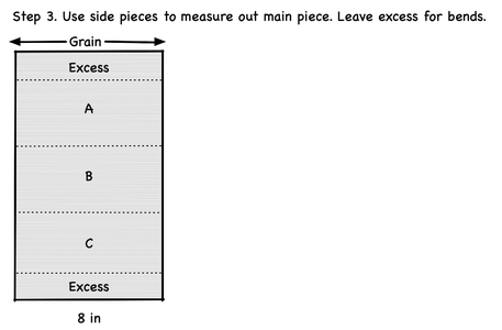

Step 3: Measure Out Main Piece
Use side pieces to measure out main piece. Leave excess for bends.
1. Mark out where you want to make your first bend
2. Make that bend, hold the cardboard pieces in position and mark out where you want your second bend
3. Make the second bend and check the fit
A note on bending cardboard: You lose some length when you bend cardboard, because some of the cardboard gets crushed and compressed. In the pictures above, I drew lines for both edges of the top piece. Then I made one of the bends and re-drew the line for the second bend. As you can see from the picture, the new bend location was about .75 inches away from the original bend line.

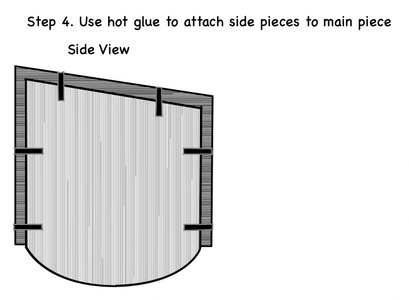

Step 4: Attach Side Pieces to Main Piece
Punch holes for the nails before you start gluing!
Use hot glue to attach side pieces to main piece
1. Glue the side pieces to the top and let it dry
2. Insert nails in the top (2 on each side)
3. Glue the side pieces to the front and let it dry
4. Insert nails in the front (2 on each side)
5. Glue the side pieces to the back and let it dry
6. Insert nails in the back (2 on each side)

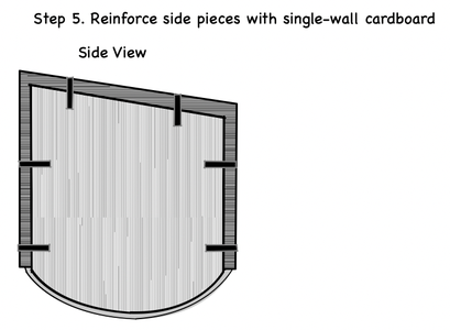

Step 5: Reinforce Side Pieces With Single-wall Cardboard
1. Use side pieces to measure out two pieces of single-wall cardboard
2. Glue single-wall cardboard to side pieces using white glue
3. Use masking tape to keep the single-wall pieces in place until the glue dries.

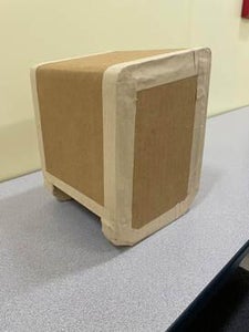

Step 7: Edging
You need to seal off the edges to help keep water out. I use gummed packing tape. You can look at this video from the Adaptive Design AssociationYouTube channel
