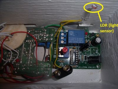

Step 3: The Light Sensor Circuit
I purchased a Light sensor circuit from maplin
http://www.maplin.co.uk/light-sensitive-switch-kit-28574
That was the one I used. I soldered all the components down and attached the 12V DC mains adaptor. This sensor is suitable for morning use and night use.

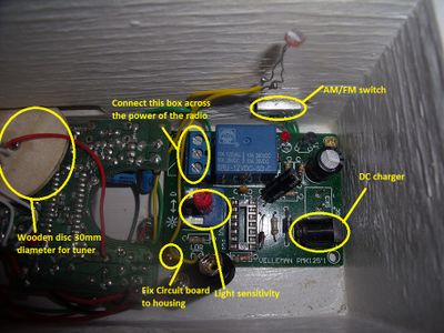

Step 4: Putting the Rest Together.
Next you will want to disconnect the speaker and place it in the speaker hole in the front which you have already cut out, and re-solder and apply an adhesive. Insert the volume control and staple to the side. Insert the AM/FM switch. it shud fit nicely in its holder, just trim the legs off if you are using a sony radio. for most of my seals I used white tack.
On the lid drill a hole and attach a piece of ribbon so that the door can be opened easily
The final picture is the LDR which uses the light to turn the radio on.
