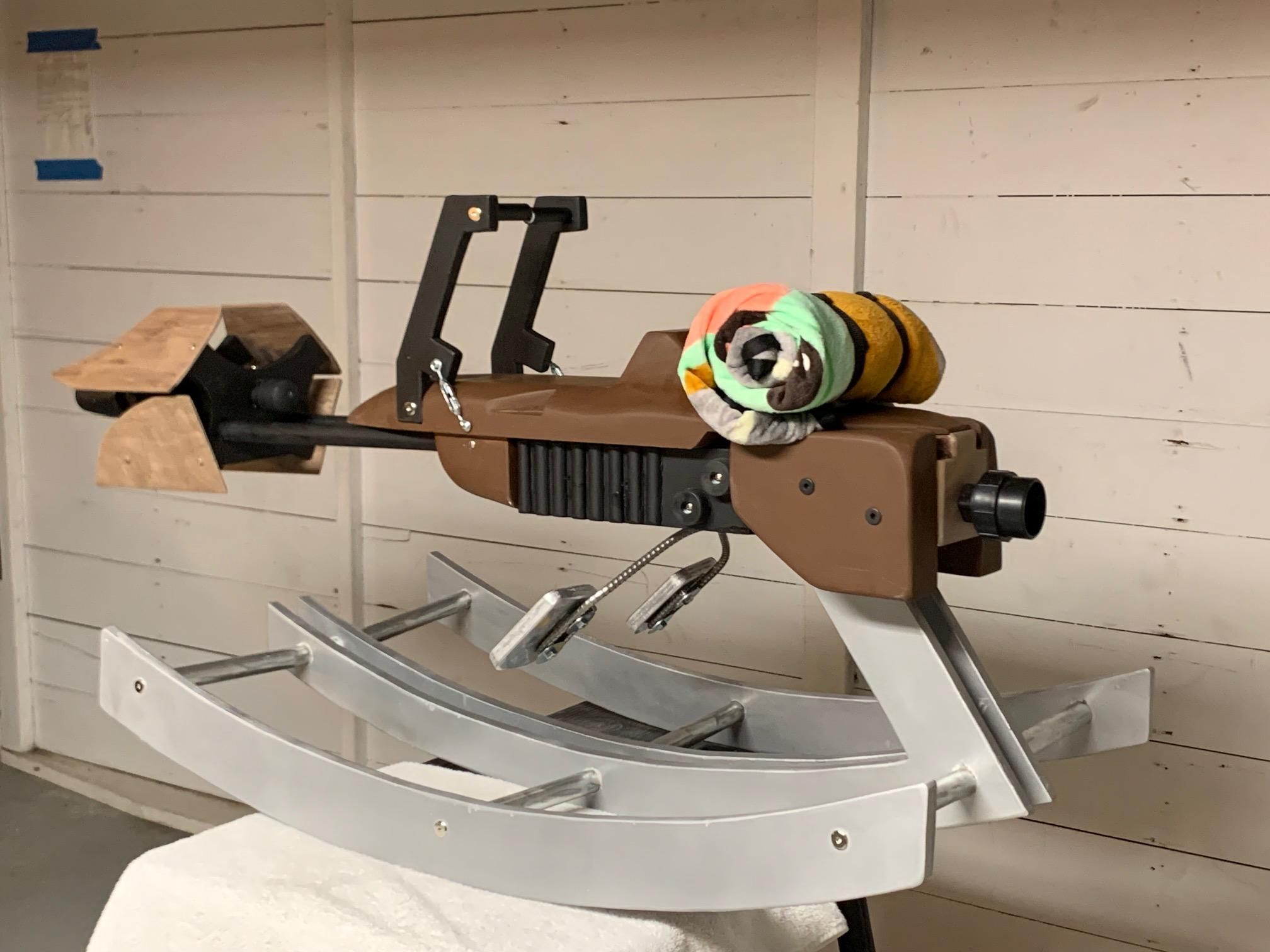

Step 1: Design
For the most part, the facade of the speeder is based on the original concept drawing for the movie prop I found on the net, while using photos of ultra high quality scale models to fill in the gaps. Customizing the design to suit its purpose as a child's rocker (sturdy with no small breakable parts).
I see the overall design as three main parts, firstly the speeder bike its self (the hull etc); secondly the rocker arms/frame and thirdly the electronics.
  • My first consideration was strength and stability for the safety of the little ones, as though this project is for my 1y/o, I also have a 5y/o who no doubt will want a turn. The need to be strong enough to handle a beating led me to the first part of my design, a rigid backbone with a solid plywood top for the seat platform. This gave me a good foundation for things like the handles and outrigger to mount from, and somewhere to fix the 3D printed hull shell.
  • The rocker arms were the source of great deliberation (as you can tell by the multiple sketches above) as the effects of the weight of the speeder bike and a toddler over a guessed center of gravity was quite a challenge. My solution was to use the two center rocker arms to clamp either side of the speeder bike's timber backbone but still have clearance to slide the rockers back and forth 50mm or so to find the center of balance. This design also has scope to easily replace the rocker arms with maybe a (motorized?) rolling mobile base..... I'm just thinking out load.... stay tuned....
  • In terms of the electronics I am not going to go into too much detail as I feel it is a little out of the scope of this instructable and I would recommend doing an Arduino setup (where as I used bits and pieces I had laying around).I wanted to end up with an LED blaster canon with the sound of the blaster and another button on the control panel that spun the turbine on the power cell. My initial idea was to use the guts from a toy blaster but it turned out the circuitry in the toy blasters were very fragile and I managed to damage the sound chip while assembling. So I ended up using a simple 555 timer flashing LED for the blaster and a sound recording/playback module I had laying around from another project. The power cell turbine is a simple circuit and I just used a small DC motor I found from a car windscreen washer pump.

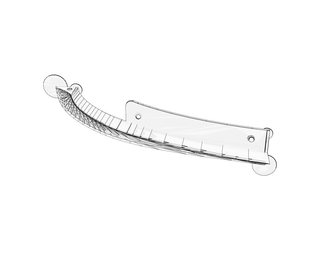

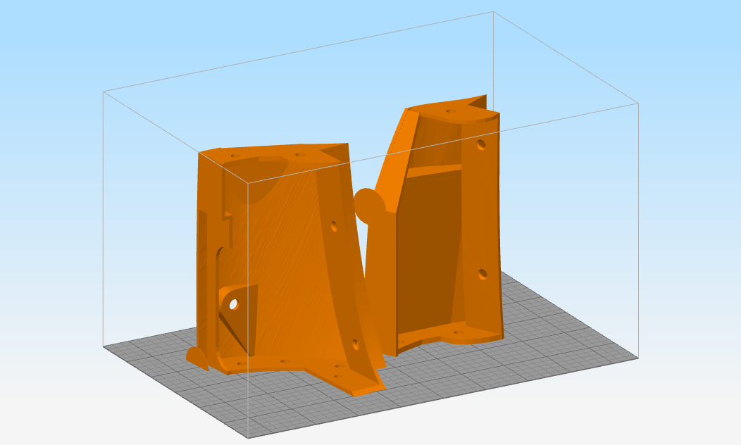

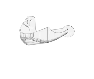

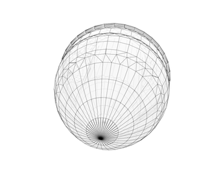

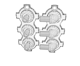

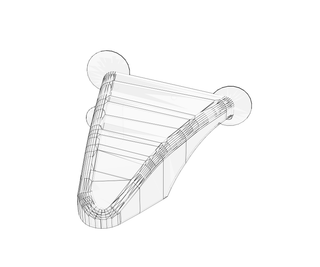

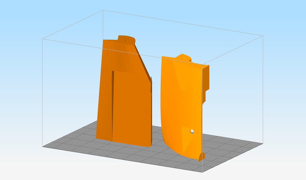

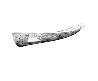

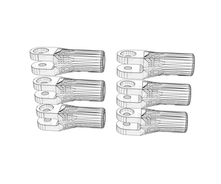

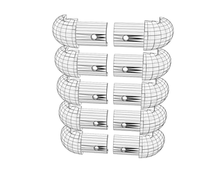

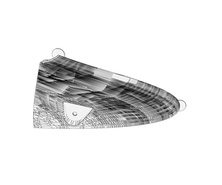

Step 3: 3D Printing
I would suggest to get the 3D printing underway asap as some of the main hull pieces could take 10 hours+ to print. I printed in fairly low resolution as I knew the parts would be painted and also to save some time.
I printed using a Makerbot Rep 2
Infill 10%
Layer Height 0.3mm
Number of shells 2
Feedrate 90 mm/s
Travel Feedrate 150 mm/s
Print Temperature 230c
Material: Solid grey 1.75mm PLA
*Note: The main hull parts will need supports.

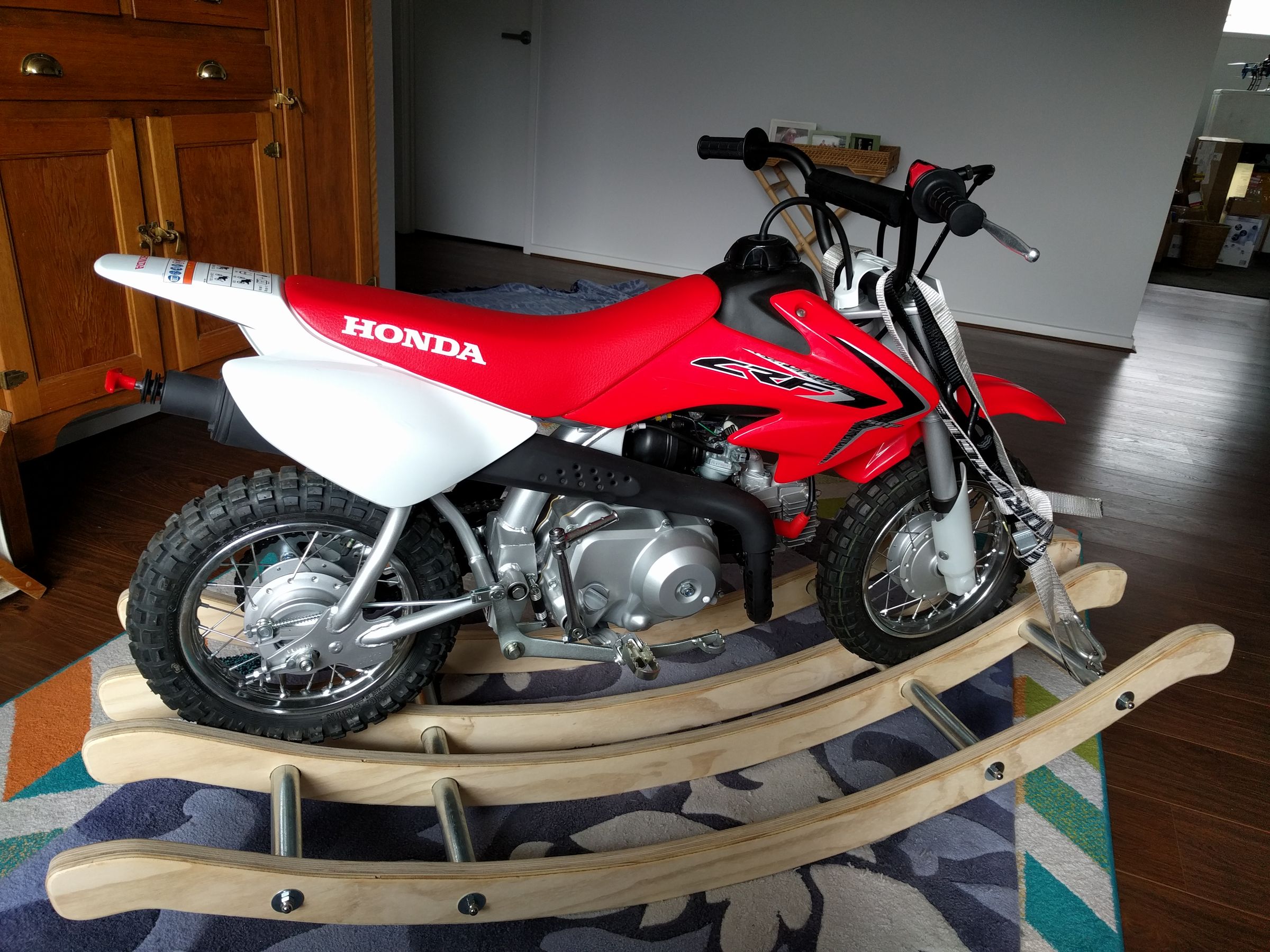

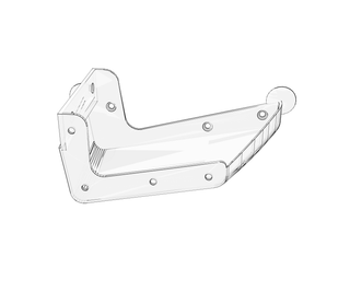

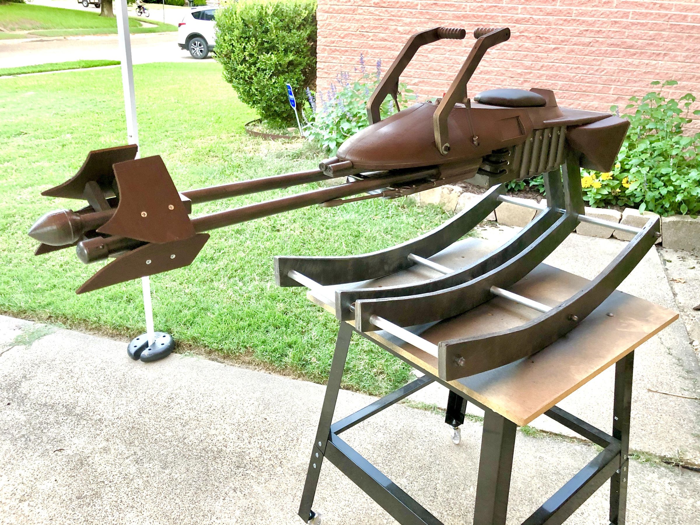

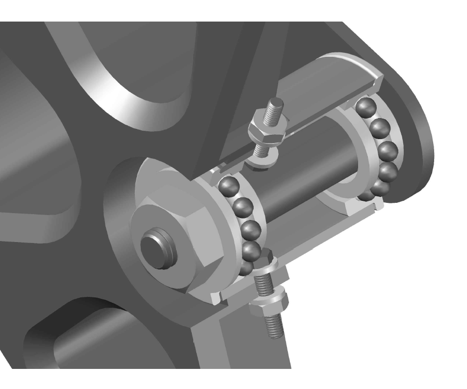

Step 5: Rocker Arms
The rocker arms are a very strong 18mm plywood spaced using 32mm stainless steel CHS tube and clamped together with M10 thread bar, washers and dome nuts.
The two middle arms are actually 10mm shorter in height which brings them off the ground so only the two outer arms rock on the floor surface.
Be sure to take a high level of care while drilling the holes for the thread bar cross members to ensure they will line up perfectly upon assembly. Unfortunately this is one of the components you will need to assemble -> check -> disassemble for painting.
When counterboring the holes for the spacer tubes to seat into, use a forstner bit in a drill press to ensure the seating area is dead square. Also use a depth gauge to ensure each bore is exactly the same (most drill presses have these built in).
Remember not to bolt the rocker arms into position through the timber backbone until you have temporally clamped them into position to try them out during the dry run.

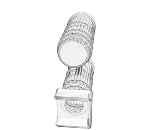

Step 6: Handle Assembly
The biggest challenge with the handles was giving them lateral strength. My solution was to craft the arms from a stiff 12mm marine ply and install rigid steel brackets that fix right back to the timber backbone. Also use some nice big o/d washers to spread the load.
It is important to install the washer that is sandwiched between the plywood arm and the hull shell, this separates the arm from the hull shell and clamps the handle to the mounting bracket ONLY. If this washer was omitted the little lateral flex there is in the handle arms would get transferred to the 3D printed shell and eventually crack. Refer to drawing No.:14016 - 08.
Be sure to use dome nuts on all exposed nuts to avoid injury to the younglings.

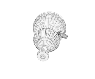

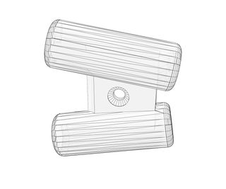

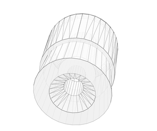

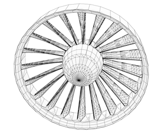

Step 7: Power Cell
As a novelty for the younglings I decided to make the power cell turbine spin. I found a small DC motor from an old car windscreen washer pump and incorporated it into the design which is mostly 3D printing and PVC tube. Refer to Drawing No.:14016 - 09.
The construction sequence is important with this part and is as follows:
  1. Install mounting thread bar with curved washers onto PVC housing.
  2. Bolt motor front shroud / mount.
  3. Attach wire tales to motor (long enough to get to electronics junction box)
  4. Install front shroud with motor attached to PVC housing & fix in place with blind rivets.
  5. Insert wires through the inside of the rear body spigot.
  6. Push rear body into position and fix in place with blind rivets.
I would suggest to do the above assembly after paining but you just need to touch up the heads of the rivets as they will still be raw.

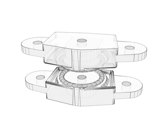

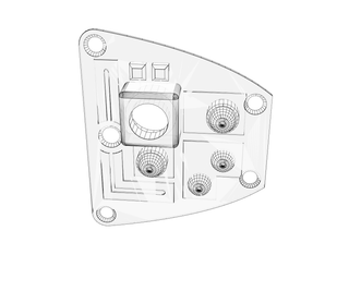

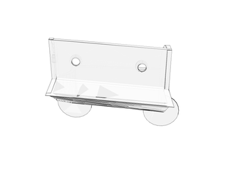

Step 8: Outrigger Assembly
Mounting plates

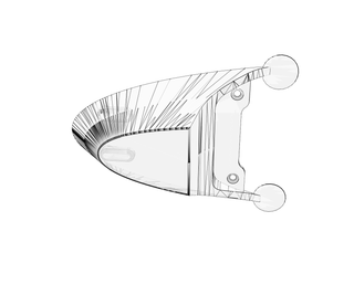

The outrigger adapter plates were the source of a great deal of deliberation as they needed to mount the outrigger tubes in a solid fashion but there was not a lot of meat (timber) below where the tubes land on the plywood outrigger mount due to the large radius fillet on the underside of the mount. My solution was to run the plates right across and offset the mounting screws inboard where there is more meat to fix to. Thrown into the mix is the stabilizer lugs that needed to hang out in roughly the same location so it made sense to incorporate all the above into one mounting plate.
Blaster Wiring Path
Be sure to drill the hole through the outrigger mount for the baster LED wire at angle toward the electronics junction box and not vertical as it will run into the under side of the timber backbone. Refer to section image above.

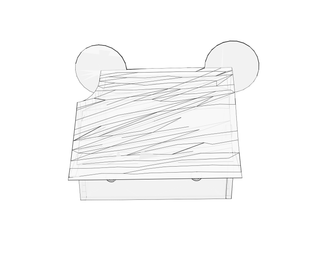

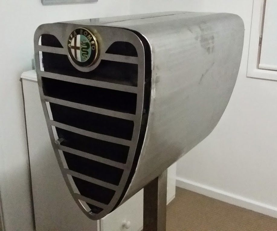

Step 9: Engine Cover
The engine I designed to not only replicate the original speeder bike look but to also double as a removable shroud over the rocker arm to backbone connection. It can be easily removed with 2 small screws at each of the 3 angle bracket connections.

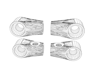

Step 10: Rear Pod and Thrusters
The construction sequence I would suggest for this part is as follows:
  1. Bolt the front and back halves of the rear pods together.
  2. Fix the pods to the underside of the rear top panel.
  3. Now with the pods in place you can hold the rear panel in position and check its profile to be sure its flush all the way around and sand off any excess prior to fixing in place.
  4. Install exhaust panel.
  5. Install thruster flaps with small hinges.

Step 14: Dry Run
Clamp the timber backbone to the upper rocker arms and ensure the rocker is sitting and rocking how you would like before fixing in place with M6 coach bolts as shown on drawing No.:14016 - 03.

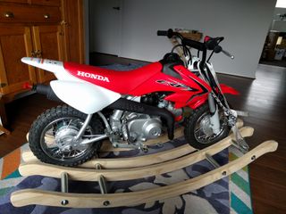

153 Comments
0
GlueGun_RaR
GlueGun_RaR
6 weeks ago
This is beyond fantastic! Genius! I see this was seven years ago. Definitely going to follow you and see what amazing things you've done since then.
0
mac1310
mac1310
Question 4 years ago
Do you have the templates of the rocker arms. I don´t find them!
0
obiwansean
obiwansean
Answer 4 years ago
I have also been looking for the templates for the rocker arms, I wish someone would share the file or point to where to get it.

Hi All,
for your benefit, I tryed to print the "Hul Mid" section as designed by TEZ but it was too big for my printer so I splitted it in two parts. I've already printed them and they are working fine.
I uploaded them on thingverse: http://www.thingiverse.com/thing:1120421
Have a nice day

It will be an easy matter to sand (reshape) the front plywood stabilizers rounder a bit, so they are not at all sharp or poky, also the stabilizers are so far forward on the toy that no child could fall forward and end up on the front of the craft, they would land on the smooth tubes, if the handle bars did not retain them on the craft! The Craft looks like it would be a little over 2 feet tall.
SPINE length
I had an office supply store (USA - Staples) print the images full size on there large printers. It appears the spine is 29 13/16 inches long x 3 1/4'' wide (back) x 1 7/16 inches wide (front). I hired someone to print the 3D parts but I have not assembled the star speeder yet so will let you know. it will be awhile before I can work on this.
Convert to metric on line if needed.
0
martinezj92
martinezj92
Reply 2 years ago
Do you have the actual dimensions of this rocker??? I am trying to rebuild out of wood. And im a little lost (Also not a carpenter lol)
