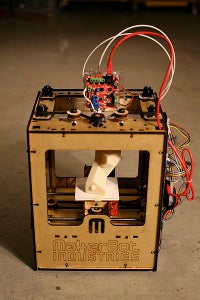

  • 3D printer: I have only tested this with my ultimaker 2. If you don’t have access to one, you can also order your rocket parts from an online print shop.

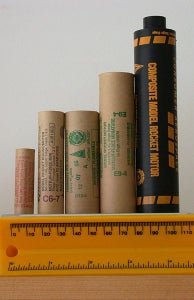

  • Rocket Engines: You can purchase engines these from most hobby shops online. It’s important to configure and size your rocket based on the engine size. Many of the the rocket’s dimensions are automatically calculated based on the engine’s physical size.

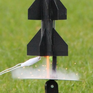

  • Launch system: Launch pad, rocket igniters, electric launch controller. You can tweak the rocket’s launch lug size and configuration.

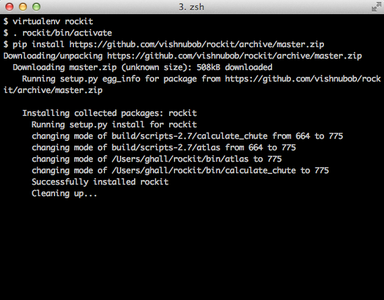

Step 2: Software Installation
Follow the installation instructions posted on the rockit wiki. It will step you through downloading the python package and installing it on your computer.

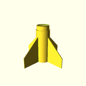

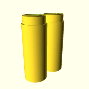

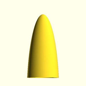

Building your first rocket is easy. The package ships with a number of pre-defined templates that you can use to get started with. Let's run the atlas command, and make the parts for a rocket that accepts a mini-sized engine.
atlas -t mini -p -s
This command will generate .STL and .PNG files for the various parts of the rocket. You can use these .STL files to print on a 3D printer. You can read more about building rockets over at the rockit wiki.

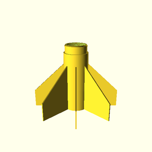

Using the JSON configuration file, you can change the configuration of your rocket. Let's try changing the tail. After you make the mini_engine rocket from the previous step, make a copy of the mini_engine.json file, and call it "my_mini_engine.json".
  • $ cp mini_engine/mini_engine.json my_mini_engine.json
Open your favorite editor and edit the "my_mini_engine.json" file, it will look like this. Scroll down to the bottom of the file, and look for the section that defines the tail section:
  • "tail": { "fin_count": 4 }

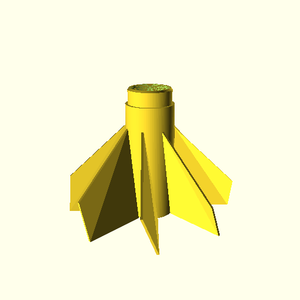

Let's increase the number of fins in our tail section from four to eight:
  • "tail": { "fin_count": 8 }
Once we save our changes, we can regenerate the pictures for this configuration by running atlas with the '-p' option:
  • $ atlas -i my_mini_engine.json -p
For a corkscrew effect, you can introduce a 4mm deflection in the fin's trajectory by adjusting the "deflection" value in the fin section of the your config file from zero to four:
  • "fin": { "deflection": 4 }

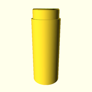

The rocket components join together using a collar. You can use any acrylic glue, but if you dial in your collar dimensions on your printer, you can achieve a friction fit. These fits are tight enough that they can survive the forces in flight without separating. If you print reserve parts, you can reconfigure or fix rockets in the field by swapping in replacements. Using a looser friction fit, you can configure easy separation in flight. This is useful for multiple engine stages and nose cone based recovery systems.
