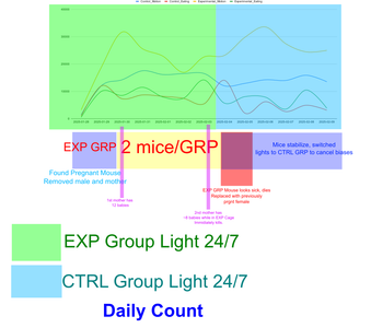

This was definitely a crazy project. I ended up with 1 male mouse that made ~18 pups, the mothers killed 15 of them, and 3 adult mice that died!

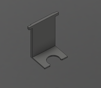

Step 3: Feeder + 3D Printed Parts
The design of the feeder allows me to access the feeder without putting my hand in the cage and interfering with the mice or getting my hands dirty. (mice poop everywhere) In addition, with the magnet pressed into the printed parts with reverse polarity makes the door close when I pull out the dish to prevent mice from escaping. It also houses the distance sensor, which counts how much the mouse is eating. For the door, I used 1.2mm music wire, but a paper clip should suffice. Simply push the wire in and bend the end of it to prevent it from sliding out.
I raised the feeder so that the mice do not trip the sensor when they are not eating. From my observations, the mice do not typically sit at the food dish and do nothing. It is a rather tight platform, so they are only on it while eating.
If you do not have any extra sensors, do not install them now. You will see why in the next step.

  4. UI shows a live counter of the movements and food that resets every hour
  5. Program counts all the movements and instances that the mice go to the food dish
  6. Program logs the count of the movements/feed at the hour into a .csv file. Example, Pi turns on at 8:30 next log happens at 9:00 not 9:30. I did this to make sure that the timing in the graph wouldn't be all over the place in times.

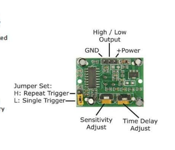

Things to adjust on the sensors:
PIR Motion sensor - Make sure that the jumper is set to repeat trigger instead of single trigger. I left the motion sensitivity to default and it worked fine.
IR Distance Sensor - Adjust the screw so that it trips around 3cm. There is a little indicator light on the IR distance sensor that shows when it is tripped.

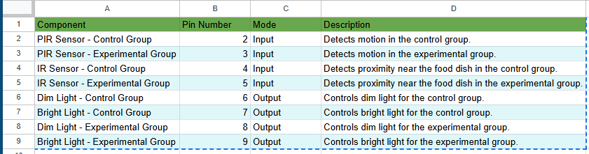

Step 6: Flashing Arduino Code
Using Arduino IDE either on the Pi or your PC flash the following code to your arduino.
// Arduino code to work with the "time-based ON/OFF" Pi script
// but use the original sensor pins and reading logic.
// ------------------------ PIN DEFINITIONS ------------------------
const int PIR_Control_Pin = 2; // HC-SR501 PIR Sensor for Control Group (motion)
const int PIR_Experimental_Pin = 3; // HC-SR501 PIR Sensor for Experimental Group (motion)
const int IR_Control_Pin = 4; // IR Sensor for Control Group (feeding)
const int IR_Experimental_Pin = 5; // IR Sensor for Experimental Group (feeding)
const int Dim_Light_Control_Pin = 6; // Control Dim Light
const int Bright_Light_Control_Pin = 7; // Control Bright Light
const int Dim_Light_Experimental_Pin = 8; // Experimental Dim Light
const int Bright_Light_Experimental_Pin = 9; // Experimental Bright Light
// We'll send sensor data at ~0.5 second intervals:

Step 10: My Observations - How Does Light Affect Mice Activity?
A lot of crazy things happened in this experiment and at the time of writing I am still not done collecting data.
I already have some basic data worth sharing.
As I mentioned above, you probably don't need to have two groups, instead you could just test them at different times. Due to pregnant mice, death, and a male, the experimental group data is pretty erratic.
After having the EXP GRP under bright 24/7 Light for several days, I switched it up and gave the CTRL GRP 24/7 Light. The conclusions of this experiment at this point will mainly come from data gathered in the Control Group cage to mitigate the mostly unusable data gathered from the Experimental Group Cage.
Unexpected happenings:
I specifically asked for 9 female mice because:
  1. Less aggressive than males
  2. More likely to express stress in ways I could measure
However, somehow when I bought them, the handler got them mixed up. I ended up with 1 male mouse that ended up in the experimental group cage. The male mouse impregnated the 2 other mice.
I purchased an extra mouse, which is the reason why I had 9. I ended up receiving 3 of the following mice colors, 3x black, 3x white, and 3x brown. The black and white mice were very similar in size and the way they socialized/acted, while the brown mice were much smaller, were less active, and more to themselves. Before I was even able to complete the circuit to track them, all 3 mice had died. When I found the male mouse, I fed it to the cat. Since the mothers were quite stressed from the light and noise, they killed the babies within a couple of days. After all that I have 2 mice in each group and am getting clean data. Whew! What a relief. Below are my current observations as of February 10, 2025. I will end up writing a final paper, making a presentation, and making a poster about my project. That will be finished in March. I plan to update this Instructable with additional information gathered and more detailed observations. This Instructable is in the Circuits category and not Biology. I hope you found this Instructable informative, as I gain more data on the mice I will update this accordingly, but as the main point was to show how to make a tracking system that logs into a csv file for graphing, I think I gave decent coverage.
I ended up with the following light schedules:
EXP GRP - Light 24hrs/day
CTRL GRP - Light 6hrs/day from 6-12
Due to the lack of time/resources, I was unable to test with a dim light, which would have been ideal for the mice because it would give them the most realistic conditions.
Observations Group With Normal Amounts of Light
  1. Predictable activity/eating times
  2. Spike in activity/eating when light turns on
  3. Significantly decreased activity/eating after 1hr of light
  4. Significant increase in activity 12 hrs after light turns off
  5. Increased food consumption for 6 hrs after the light turns off
Observations Group With Constant Light
  1. Less predictable active/eating times
  2. Activity and eating times do not perfectly correlate
  3. Activity mainly affected by external factors. (Household noise)
Observations from the Control Group Cage
  1. Noticeable decrease in activity and food consumption when under constant light
  2. Unpredictable eating times
Download the chart.svg to see a detailed view of the graphed data.
Here is the link to my Google Sheets that has all my observed data - Biology Fair Spreadsheet
Summary of my observations
In this experiment, I observed how different light conditions affected mice activity and food consumption. Although there were several challenges—such as unexpected pregnancies, mouse deaths, and erratic data from the experimental group—the control group provided valuable insights. When exposed to constant 24/7 light, the mice displayed less predictable activity and eating patterns, with behavior largely influenced by external factors like household noise. In contrast, the group with a light schedule of six hours per day, exhibited more regular activity and feeding patterns. There was a spike in activity and eating when the lights turned on, followed by a decrease after an hour. Activity significantly increased for the following 12 hours after the lights turned off, along with elevated food consumption during the following six hours. Notably, when the control group was placed under constant light, their activity and food intake became unpredictable and declined overall.
