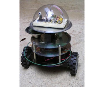

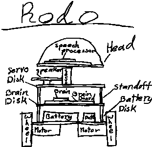

Rodo's basic construction uses several CDs mounted together with threaded standoffs. The idea was to stack up the CDs and use each to mount things (batteries, motors, etc.) We realized early on that the CDs were not very stiff, so the bottom CD was replaced with a platter from an old 5 1/4" hard drive I have been saving (I knew I was saving it for something!). It is much stiffer than a CD, providing a very solid base for everything else to mount to.
Rodo's drive motors, tail wheel, and On/Off switch are mounted on the bottom of the bottom disk. The batteries are mounted on top of this disk. The next disk up in the stack is the brain disk. It has Rodo's brain and the stud sensor. We call the next board up the servo board because it mounts the servo which allows Rodo's head to turn. And of course the top CD is the head.

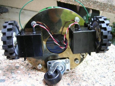

Step 2: Battery Disk

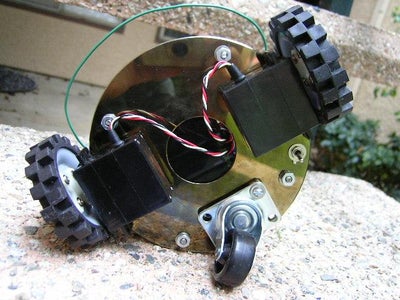

This is the base disk. The motors used for the drive wheels (mounted on the bottom) are modified R/C model servos. I've been flying model sailplanes for quite a while so I had extra servos I could sacrifice for Rodo. The modification allowed the servos to spin continuously. An unmodified servo can only move to certain positions. I debated for quite a while on how to mount the servos to the disk. I considered making a bracket and bolting them on, but time was running short (isn't it always!?) so we used servo mounting tape. It is a double-sided foam tape and quite strong. The wheels are from one of Nicole's K'nex sets. Servo control horns were screwed to the wheels and then the control horn/wheel assembly was screwed onto the servo. Also mounted on the bottom is a caster wheel we found at a surplus electronics store. The batteries were mounted on top of this disk. One battery provides power for the motors and the others power Rodo's brain. Rodo is powered-up when the switch on this battery disk is switched On.

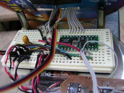

Step 3: The Brain Disk

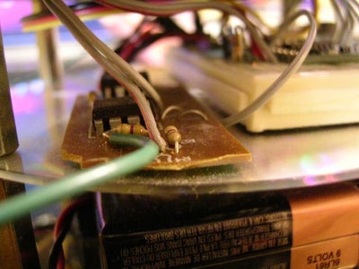

The next disk up in the stack is what we call the Brain Disk. It houses Rodo's brain and the stud sensor used to detect objects. The model of stud sensor used is a "Stud Seeker". It was the smallest stud sensor we could find. Normally, a stud sensor is used to detect wooden studs in a wall. You place it on a wall, turn it on and slide it until a stud is detected behind the wall. But if you turn it on with nothing in front of it, it will detect an object that comes within a few inches of its "antenna". I soldered a wire from the the stud sensor and looped it around the front of Rodo, providing optimal object detection. It is the green wire seen in some of the photos.
A detected object is indicated by lights on the stud sensor. For Rodo, the wire that usually connects to the light was reconnected to an input to his brain so he will know when something is in front of him. I couldn't come up with an elegant (and quick) way to mount the stud sensor to the CD, so servo tape was again used. (That stuff is almost as useful as duct tape!)
Rodo's "brain" is called a microcontroller. The microcontroller used in Rodo is a Parallax BASIC Stamp BS2. The software and documentation are free downloads. We decided (OK, I decided :) ) on the Stamp because the software is easy to write and it's quick and easy to download to the Stamp. The Stamp is programmed in a simplified version of BASIC; Parallax calls it PBASIC. The software is downloaded using a serial cable and the Parallax software. The program and variables are stored in EEPROM in the Stamp which allows instant re-programming (and the program is not lost when power is removed). So you can make a change, download it to the Stamp, and repeat continuously (and quickly!). This proved very valuable when we were trying to get Rodo to say things correctly.

And last, but certainly not least, Rodo's head disk sits on top of the head servo. It was mounted the same way the wheels were mounted to their servos: attach a control horn to the CD using screws, and then screw the assembly to the servo. The speech processor, with an audio amplifier, is mounted on the top of Rodo's head disk. The entire board on Rodo's head is just for speech (it took quite a while to get all those little wires and parts stuck in the right holes). And, yes, the board is attached to the disk with servo tape.
We wanted some kind of a dome for the head, but after much searching we could not find anything the right size/shape. Then Nicole received a gift which was a ball-shaped game. The packaging around this ball was two plastic half spheres which were just the right size! (Lesson learned: you should never throw anything away; you may need it someday for your robot!)
The clear plastic dome covers Rodo's head. It gives Rodo a cool look because you can see the electronic components in his head (and the dome keeps curious fingers out). Nicole had a couple googly eyes, so she stuck them on the front of the dome. They are a bit small, but it was all we had.
