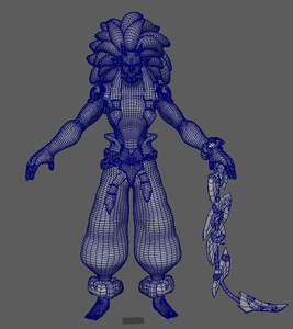

After you finish your high poly sculpt, we must retopolize it in a low poly mesh to begin animating and texturing.
I used Autodesk Maya for this step.

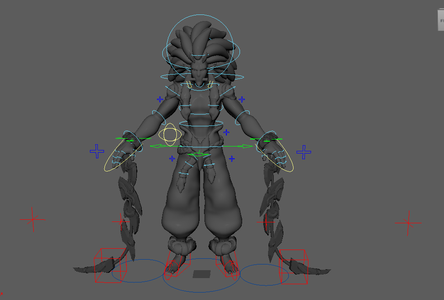

I used a free maya script called Advanced Skeleton to help rig my model. I also used NgSkin Tools, also free, to weight paint my rig.
