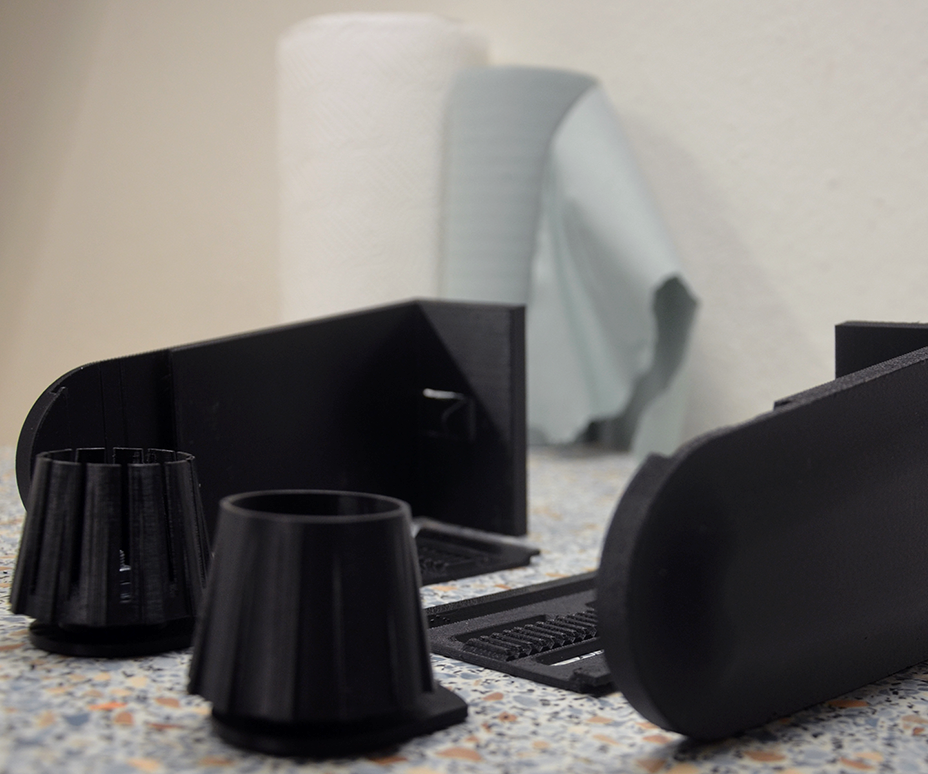

I made an optimized shape for 3D printing, especially is setup for 0.4 nozzle system.
2 times around the shape and next layer. Optimized for the nozzle, speed, material needs.
Step 1: Download and Print All Parts
all parts from annex.zip or on link:
http://www.thingiverse.com/thing:1283138
I'm render huge quantity of formats(.stl / .stp / .igs / .ipt) for adjusting for your needs!
I'm use PLA Colorfabb PLA with Layer: 0,1mm
Printing machine: Mankati Fullscale XT
All rollete was printed separatelly for best quality of print.
Temperature: between proposed temp from producer of material
Time: 1Rollette: 3,45hours, I would advise doing bigger BRIM for better sticking to bed because of length.
You can find parts:
1x Guide: rails, turns, ends (10cm)
1x Rollette: Mainpart, Holder+end, Closure End part
Only screws you have to buy!
