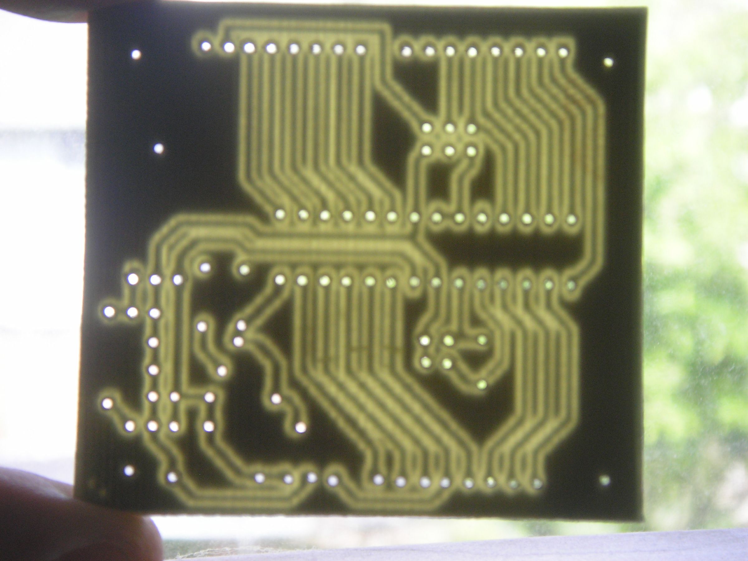

Step 44: Updating the System: IR User Interface Board
The next step is to actually build the RC5 IR board. Circuits usually look better when you don't point-to-point solder them (as I've been doing up until this point) unless you've got mad skills .
There are several options for getting a nice looking PCB, you can go to a fab house, chemically etch the board (this method alone has lots of options ). Personally for small batches or one-of's I prefer to mill out a PCB using the eagle plugin PCBgcode on my homemade CNC machine. (Working on a second, for PCBs only CNC, that will probably be my next instructable since I'm taking lots of pics). This way I don't have to deal with chemicals, or laboriously drill holes by hand either.
If you're setup with a CNC:
1. Download Eagle
2. Download PCBgcode
3. Setup PCBgcode to match your machine specs
4. Open my RC5 eagle board layout file which was available in the last step.
5. Run the PCBgcode URL to spit out code specific to your CNCs setup
6. Lay some copper clad boardFLAT to your cutting bit (I prefer a vacuum table that I painstakingly leveled but there are lots of options)
7. Mill out your PCB
8. Drill your PCB
9. Clean the PCB copper with some sandpaper
10. Prepare to solder.
.... gonna have to make an instructable on this process... The links given above should give you most everything you need until I can get one up though. Ask if you haven any questions this alone is a big subject.
Step 45: Updating the System: IR User Interface Soldered
Solder it together:
I used single sided copper clad for this board instead of double-sided so I had to jumper some wires. I would suggest always soldering in an IC socket instead of soldering the IC directly. This both protects the IC from being damaged from overheating and allows you to swap out the IC for another if you decide to upgrade it later.
Some Liquid Tin would keep the bottom nice and shiny looking, as well as make it a bit easier to solder
I hope the pictures can speak for them selves about the jumpers I made, if not, let me know and I'll give a bit more detail.
