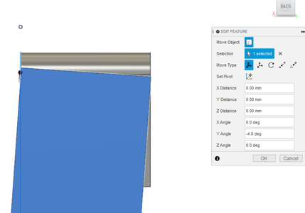

Looking at a picture of Japanese Hongawara Buki, the semi-circle part looks smooth/continuous down the roof and the flatter curve is the one that looks stepped, so we'll only angle the flatter curved piece, by about 4° and move it around so the edges still line up with the semi-circle piece.

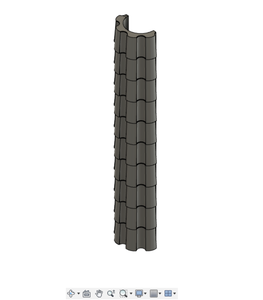

Step 17: Turning Our Patterned Half-cylinder Into a Real Cylinder
Jumping back to the SOLID workspace, we'll Construct an Axis Through A Cylinder. then click the inside of our half-cylinder.
Next, we'll open the CREATE menu and find the Boundary Fill tool. This will turn our sheet metal component into a solid which will allow Fusion360 to manipulate our model easier.
After this, we'll use the Move/Copy tool to create a copy of our half-cylinder and rotate it 180°.
Finally, we will use the Combine tool to join our two halves together to make a full cylinder.
