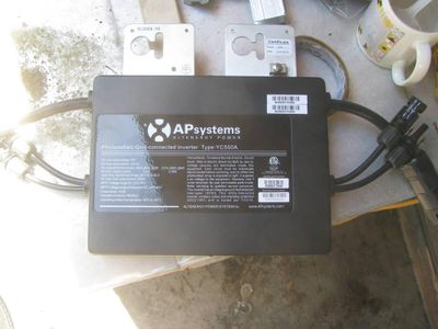

Electrical Connections
The panels that I used have a rated output of 300W each. The microinverters connect two panels and generate a maximum of 600W at 240V. They are equipped with industry-standard polarized connectors on the DC side, and a daisy-chained connector system on the AC side, so it's plug-and-play. A maximum of 7 inverters can be connected to one 20A circuit. So for every 14 panels, there needs to be a 20A breaker in an electrical panel with suitable wiring to a weatherproof box to interface to the daisy-chain. There also needs to be a separate grounding system, electrically connecting the panel frames, the rails, and the microinverters to the supply ground. Details will be given in the electrical code for your jurisdiction. Mine has an additional requirement that solar panels be connected at the opposite end of the breaker bus-bar from the supply.

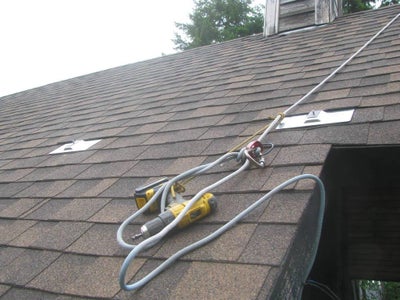

Local regulations may require the use of fall-arrest equipment when working on a roof.
Regardless of regulations, metal roofs are very slippery, particularly when sitting or kneeling, and I have some sections with a 1:1 slope. It's impossible to work without a harness. I have rock-climbing equipment including Jumar ascenders that let me stop at any place on the roof and place my full weight on the harness, with hands free. On my first house I used a belay device with a knot, but the Jumar was much easier. On the first roof, I set an eyebolt in the joist in a pony wall, and passed the rope across the ridge to work on the other side. On my second house, I tied the rope to the snow rail. Since I installed panels on both sides, I had two ropes, one in each direction.
Tools and other items can slide off a roof very easily. They might hit someone underneath, but apart from that it's just annoying having to retrieve them. Sometimes I secured tools with a lanyard, or stored them in a box that would not slide. Once you have some rails up, you can rest boxes against them.
Power cords and safety lines are a trip hazard. One time I stepped on a loose rope on the metal roof; it was like stepping on a bar of soap. I fell and hit my head; the harness stopped me sliding off the roof but my elbow hurt for months.

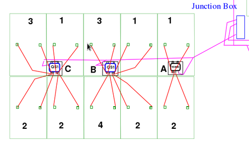

Step 4: Layout
You need to decide how many panels are going go on what roof sections, which is going to affect how many microinverters are required, and what electrical connections are needed, as well as how many rails and brackets.
The rail system is designed to have panels fitted side-by-side, separated by a clamp. So the length of rail is the width of one panel plus the width of one clamp, multiplied by the number of panels, plus one more clamp width, plus some margin at the ends. Rails can be extended with a joining piece. You need some space around the edges to safely gain access to work - a couple of feet maybe. If there are vent pipes or chimneys you need to avoid those, leave a space in the grid for instance. Brackets are usually fitted to roof trusses, which are vertical. Rails are placed horizontally across the brackets, and panels vertically across two rails. This arrangement gives most flexibility in where panels may be positioned.
Roof orientation is not especially important, except that in the Northern hemisphere a North-facing roof will not see much sun. With grid-tie, it is the cumulative annual energy that is important, not the instantaneous power. If your roof faces east, you will get more power in the morning but less in the afternoon. If it has a steeper pitch, you will get more power in winter but less in summer. The dominant effect is that the panel produces little power if the sun drops below its horizon. I have panels facing east, south and west on pitches of 1:3 and 1:1, and they all generate power; see graph.
If you are working from architectural plans, do not forget to allow for foreshortening of the panels due to the pitch of the roof. My panels are 65 inches long on a 1:1 pitch roof, but on a floorplan they will appear only 46 inches long. The two PDF drawings show panels and rails on a floorplan, and panels at real aspect ratio on a distorted floorplan.
The panels come with a pair of pigtail wires with pre-assembled connectors. The microinverters also come with pairs of pigtails so that they just snap together. I have some inverters that take two panels, and some that take four. The inverters mount to the rails underneath the panels. Since the pigtail wires are only so long, the inverters have to be positioned appropriately else wire extensions must be used. I found it useful to place a group of panels face-down (on a firm flat surface so they won't be damaged) and mock up a connection to determine the best location. For the quad inverters, I could wire three panels directly and use one extension wire on the fourth. The connector spacing on the daisy-chain AC cable also comes into play, since each group of two or four panels must be connected with that. On one roof, I had to skip one panel on each pitch to avoid a vent, which left an odd number of panels on each pitch. One panel is connected across the ridge to an inverter on the other side.

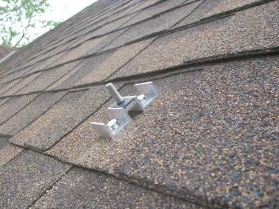

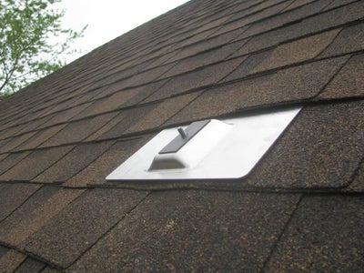

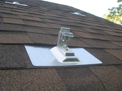

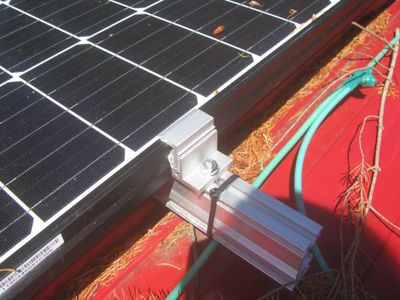

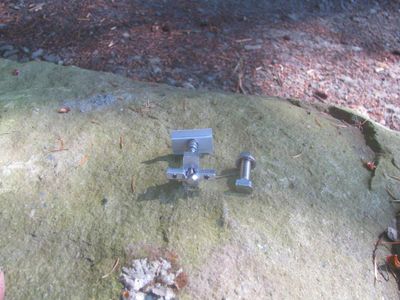

Step 5: Mounting Brackets

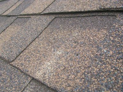

The mounting brackets hold the rails to the roof. There are different kinds of brackets intended for different types of roofing material. Usually, the bracket is secured to a roof truss with a bolt piercing the roof membrane. There are also brackets designed to clamp on to the seams of a metal roof.
My first house had a "duroid" tar/paper roof with composite shingles. The brackets are secured with lag bolts into the roof trusses, then covered with a metal shield which slides under the shingle to deflect rainwater. In order to locate the trusses, since I had access to the attic space, I drilled pilot holes either side of the truss from underneath, then drilled a hole from above between them to take the lag bolt. I then sealed the pilot holes, though they were protected by the shield.

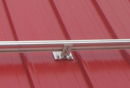

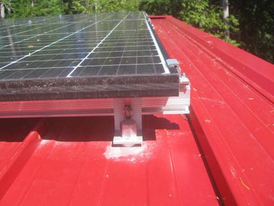

For the second house, I had intended to use clamp-on brackets on the seams. The first brackets I tried, based on written specifications and pictures, did not fit the roofing material. The second brackets fit perfectly on a test piece of roofing, but not when the roof was actually nailed in place with the seams overlapped. I realized that the clamp depended on the seam compressing and snapping back into place when the clamp was hammered on, and with the mounting nails inserted, it could not move. I switched to a membrane-piercing type with a rubber gasket. On one roof I had access to the underneath, so I could locate the trusses and transfer measurements to the top. The brackets used a single lag bolt screwed into the truss. On other roofs I had no access to the underneath, so I used a different bracket designed to be secured onto plywood sheathing with four smaller lag bolts, shown in the photo. Again there is a rubber gasket, but I used sealant on the holes as well. I found it useful to make a jig to drill the four pilot holes in the metal roof for the lag bolts.
While it's possible to mount the panel clamps or the inverters on top of a roof clamp, it's much easier if you don't. So the bracket spacing should reflect that.

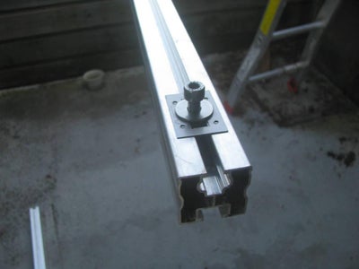

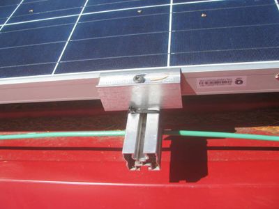

Step 6: Rails
The rails come next, secured to the mounting brackets. I had two different types of rail, probably two generations from the same manufacturer. These are aluminium extrusions with slots for captive stainless nuts and bolts. The earlier rail had a locating piece to centre the bolt in the rail, with bolts that had to be slid along the rail from one end. The later rails have cam bolts that can be inserted in a slot then twisted to bear on the rail before being tightened. The brackets have some adjustment for height so that the roof does not have to be perfectly even. All the parts are either aluminium or stainless steel, to prevent corrosion and rust staining. If you lose nuts or washers, replace with stainless. Make sure you fully understand how the brackets and rails are assembled and positioned before drilling holes in anything. When cutting rails, make sure there is sufficient extension beyond the panels to safely secure the outside clamps.

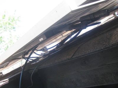

Step 7: Mounting and Wiring the Microinverters
Since the microinverters are mounted underneath the panels, they need to be fastened to the rails before the panels are placed. Using the previously worked-out layout, bolt the inverters to the rails with the supplied captive bolts. Mine had washers with oxide-piercing sharps, designed to make a good ground connection between the inverter body and the aluminium rails. There are similar sharps on the panel clamps, to make a connection to the panel frames. Since the inverter connectors are only waterproof when assembled, I placed plastic bags over the inverters in case of rain.
Connect the 240V daisy-chain cable to the inverters and secure with cable ties. Also run a grounding wire to the rails. My kit included grounding lugs with sharps for the purpose.

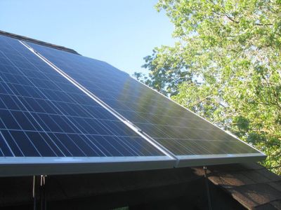

Step 8: Lifting and Positioning the Panels

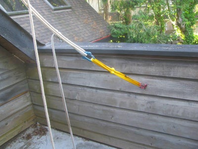

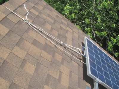

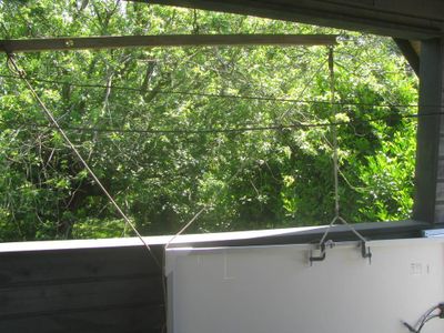

Industry-standard panels are a convenient size for one person to lift and carry, but not up a ladder in one hand. For my first roof, I used G-clamps to hoist the panels with a rope. Later, I drilled a hole at one end of each panel frame and attached a temporary lifting bolt and lug, with a carabiner secured to a rope. I was able to lean a panel against the side of the house, then drop a rope down from the roof and secure it, then lift the panel straight up and lower it onto the rails.
Once approximately in position, I moved the carabiner to a fixed rope on the roof to hold it. This rope was either secured to the safety rope at the roof apex, or secured separately to snow rails on the other side. Then I fitted the panel clamps. Since the clamps hold two panels, starting at one end of a rail I tightened the end clamps fully to hold the panel and fitted the mid clamps loosely. Then I moved the rope to the next panel, positioned that in turn, tightened the first mid clamps fully now holding two panels, added two more loose mid clamps, and so on. Connect the panels to the microinverters as you go. Sometimes that requires moving and re-positioning panels and inverters. In some cases, I found it convenient to lay a sheet of plywood across a panel in order to lie on it to work on a panel further away. Half-inch ply should be rigid enough not to put pressure on the glass, and can often rest on the clamps and not touch the panel at all.
On the steep pitched roof, I used a pulley block at the apex, which made it easier to adjust the position of the panel. On the shallow pitches, the panels are more-or-less held by friction and the rope is just a precaution.
If you place the lower panels first, it's simple to slide the upper ones into place till they butt against the lower ones.
When wiring the microinverters, keep a note of which panels connect to which inputs of which microinverters - the serial numbers are required for monitoring.

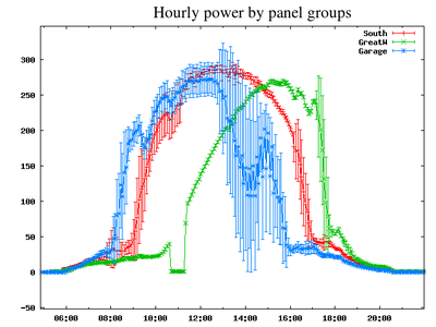

Step 10: Monitoring
The monitoring systems track the cumulative energy over time, per day, week or month, and also show instantaneous power for each panel. I wrote some software to collect the instantaneous power figures at regular intervals, easy enough on the old ethernet-connected monitor but somewhat complicated on the newer one.
The graphs show average panel power during a day from three different roof pitches, a shallow pitched garage facing southwest, a shallow pitch facing south, and a steep pitch facing west. The garage starts to get shaded by trees in the afternoon.
The graphic shows the power in false colour at one particular time (11:40 AM); the west-facing pitch (in blue) has not yet got much sun.
