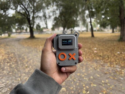

Step 1: PREVIOUS PROJECT—PORTABLE AIR QUALITY METER
Here's a quick recap of how this project got started:In order to monitor the AQI levels in my locale, I made a very basic version of an air quality meter that uses an MQ135 gas sensor to monitor air data such as the detection of smoke, CO₂, nitrogen oxide, ammonia, etc. in the atmosphere. The data is then displayed on an SSD1306 OLED display. This setup worked, but it only showed the amount of harmful gases suspended in our environment, not the actual AQI readings.
https://www.instructables.com/Portable-Air-Quality-Meter/
After revisiting our approach, we found the SGP40, a top-notch AQI sensor that provides real-time air quality readings and excels at detecting Total Volatile Organic Compounds (TVOC).

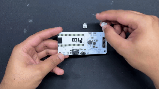

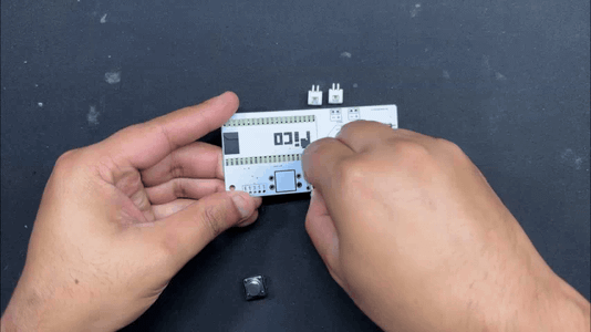

Step 5: DRIVER BOARD ASSEMBLY PROCESS
- Using the solder paste dispensing syringe, solder paste is applied to each SMD component pad to start the driver board's PCB assembly process. Here, 63/37 Sn/Pb solder paste is being used.
- We pick all of the SMD components, including the IP5306 IC setup, using our ESD Tweezers and position them correctly in their position.
- After that, the PCB is set on a reflow hotplate, which heats it from below to the melting point of solder paste, causing all of the SMD components to be connected to their pads.
- The next step is the through-hole component assembly, which starts with the creation of a large HUB75 16 pin connector by aligning two con8 male header pins side by side.
- After that, a type C port is installed in its place, and then a push button.
- Next, we place two CON2 JST connections, which are used to add a lithium cell to our driver board. In order to increase the battery capacity of our arrangement, we added two connectors so that we could utilize a different battery board.
- Finally, two CON20 female header pins are attached to the Raspberry Pi Pico's footprint. We then flip the board over and use a soldering iron to secure all of the through-hole components in place between the pads.
- Once the assembly process is finished, we can place the PICO W into the two CON20 header pins to position it.

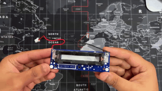

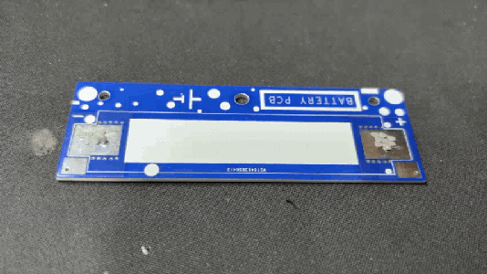

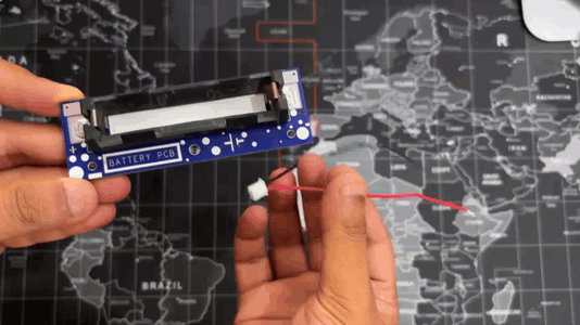

Step 6: PCB ASSEMBLY-BATTERY BOARD
- We start the process by applying solder paste to both of the SMD cell holder's pads, much like we do with the driver board assembly.
- After positioning the lithium cell holder over its designated spot, the entire board is placed over the reflow hotplate, which melts the solder paste and joins the PCB and lithium cell holder.
- We soldered the positive and negative wires of the JST connector to the positive and negative of the battery board to complete the assembly.

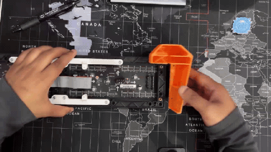

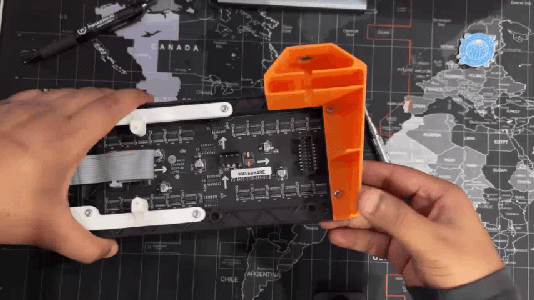

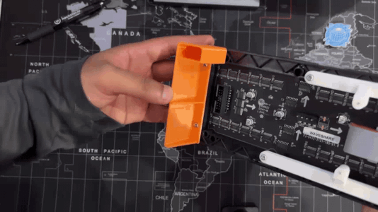

Step 8: FRAME ASSEMBLY PROCESS
- Mounting the top-side frame holder part with the display is the first step in the Frame Assembly process. The holder part is then positioned over its mounting location and fastened with two M2.5 bolts using our RGB Matrix.
- Likewise, we positioned the bottom side frame holder over its location and fastened it with the RGB Matrix using two M2.5 bolts.

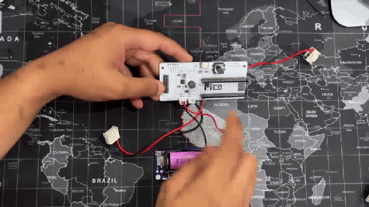

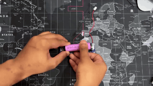

Step 9: POWER SOURCE
A 2200mAh 3.7V 18650 Lithium Ion cell will be used as the project's power source. It will be connected to our Driver board to provide a steady 5V 2A to both panels and our PICO setup.
After positioning the cell in its holder with the proper polarity, we connect the battery board's wire harness to the driver board's JST connector.
The device switches on and provides a steady 5V output when the onboard push button is pressed once. Indicator LED turns ON meaning our setup is functioning.
We only need to double-press the push button to switch the setup off.
Step 10: MATRIX SETUP & BATTERY BOARD ASSEMBLY

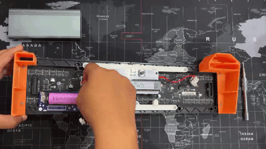

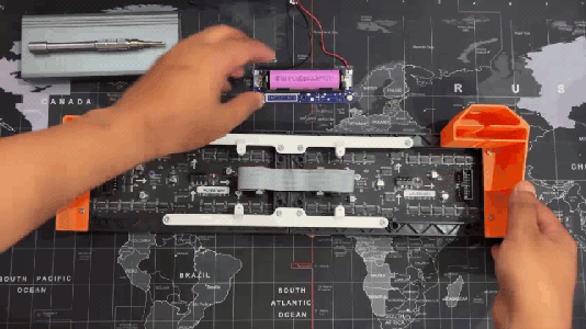

We begin the battery board assembly and matrix setup by positioning the battery board over the Frame Holder part's mounting hole and using the M2.5 Bolt to secure it in place with the matrix setup.

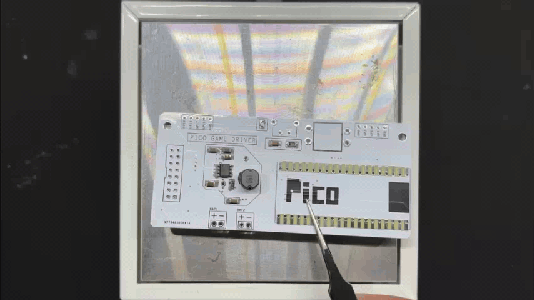

Step 11: MATRIX SETUP & DRIVER BOARD ASSEMBLY

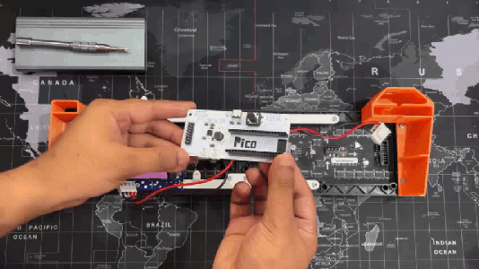

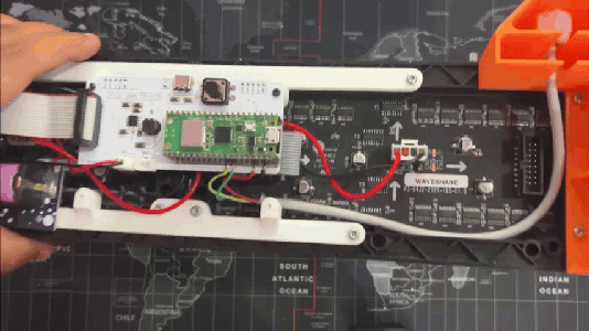

- The driver board placement with matrix configuration follows, which starts with the driver board being positioned over its mounting holes and fastened with two M2 screws to the frame holder portion.
- After the battery board's JST wire harness is connected to the driver board's JST connector, the driver board's two power connectors are plugged into both matrix power connectors.
- Subsequently, we linked our driver board and matrix by using a long ribbon cable connector with a hub75 connector on both ends.
- We then place PICO W in its place and the basic assembly is now completed.

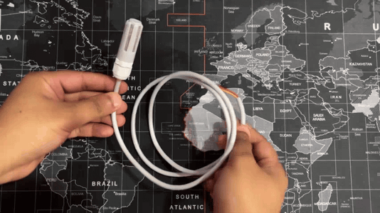

Step 13: SGP40 VOC AQI SENSOR PROBE
We utilize a unique Air Sensor Proble with the SGP40 Sensor for air quality monitoring.
The SGP40 sensor was created especially to measure Total Volatile Organic Compounds (TVOC) and evaluate pollution levels in enclosed areas in order to monitor indoor air quality. It works best in regulated interior spaces with consistent ventilation, humidity, and temperature.
Because external environmental factors, including extreme temperature swings, humidity swings, and direct contact with pollutants, can significantly affect the sensor's accuracy and reliability, it is not appropriate for outdoor use.
It's best to use the SGP40 indoors, where air quality testing is crucial, such as in homes, offices, and industrial settings, for optimal results.
Below is the SGP40 Datasheet for more thorough details about the project.
https://evelta.com/content/datasheets/011-SGP40-Datasheet.pdf
Our probe is a PG7 Cable Gland, a specialized connector used to seal and fasten electrical cables when they enter panels, housings, or enclosures. A circuit with the SGP40 is part of the Probe and is located in our PG7 Cable Gland.
Step 14: MATRIX SETUP & SGP40 PROBE ASSEMBLY

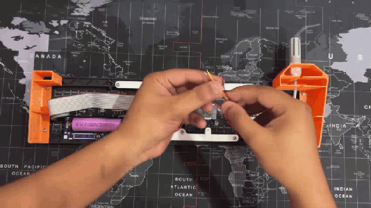

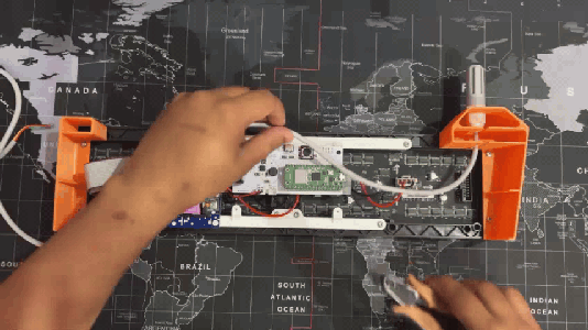

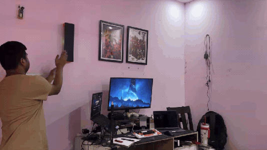

In order to secure the entire sensor in its mounting position, we remove the nut of the PG7 connector, insert its wire through the mounting hole, and then replace the plastic nut on the connector. Finally, we tighten this nut.
Following that, we cut off the PG7 connector's extra-long wire and stripped all of the wires that will be soldered to the PICO Board.
We connect the SDA and SCL Pins of the SGP40 to GPIO26 and GPIO27 of the PICO W since the SGP40 Sensor needs an I2C connection for data transfer. The VCC pin is connected to the PICO W's 5V pin, and GND is connected to GND.
We have finished assembling our room air quality monitor.

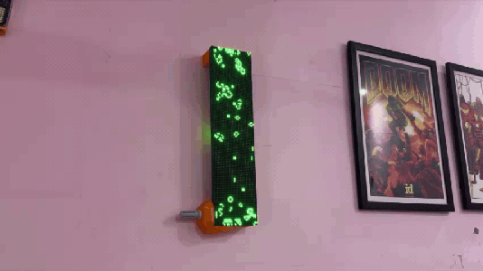

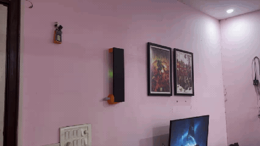

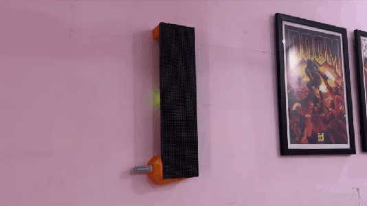

Step 16: RESULT

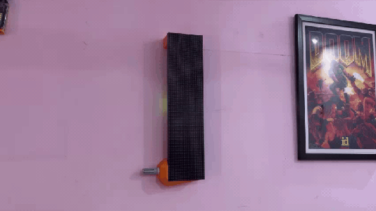

The result of this straightforward but incredibly useful build is the ROOM AIR QUALITY MONITOR, a device that uses Connoways' game of life in a clever way to offer real-time TVOC readings. When air quality is great, simulation runs green; when air quality is low and poor, simulation becomes yellow and red.

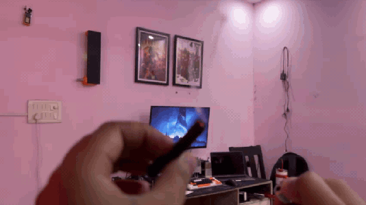

After mounting the Air Qualit monitor on a wall, we ignited an incense.
A mixture of chemicals and particles, including volatile organic compounds like benzene, toluene, and formaldehyde, particulate debris like ash, and even carbon monoxide, is released into the air when the incense burns.
VOCs linger and amass in the absence of airflow, leading the sensor to record higher readings. The Game of Life simulation changed from green to yellow and later red as a result; Our Device was correctly capturing the deteriorating air quality.
The story's lesson is to avoid burning incense in a restricted space. This demonstration shows how our air quality monitor is a useful environmental monitor that responds to actual changes in the environment.

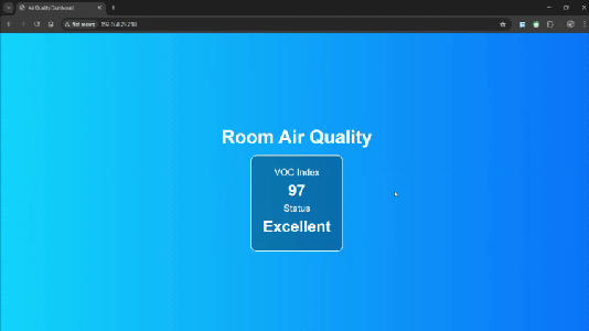

Step 17: WEB INTERFACE
Let's now examine the project's webapp, which functions as a sleek and responsive dashboard for monitoring VOC levels in real time.
It displays the data in an aesthetically appealing way and is hosted directly on the Raspberry Pi Pico W. It automatically refreshes every two seconds.
The interface shows the current VOC index, and we added a gradient background and centered layout. The readings are highlighted by a bordered card-style design that makes them easily accessible on both desktop and mobile devices.
After the PICO has been connected to our local network, we can access the web application that will display the room VOC data by using the IP address we obtained during the code upload process.
