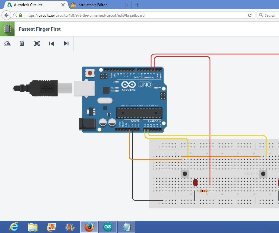

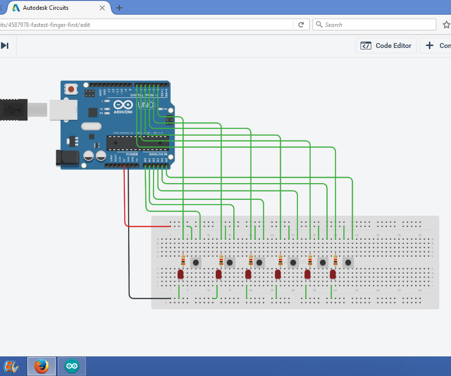

Step 1: Setup
1. Wire everything , see the image for connections
2. Choose four buttons of your ir remote
3. Run the code and write the hex digits of your remote buttons
4. Insert the hex digits in the code (you will find something like "//write the hex digits here" in the code)
5. Run the code and the circuit is done
Disclaimer : I did not use the relays in the circuit but you can find tutorials on how to use a relay board on internet and connect the relay pins where the L.E.Ds were connected
if you have any questions ask them in the comments below
