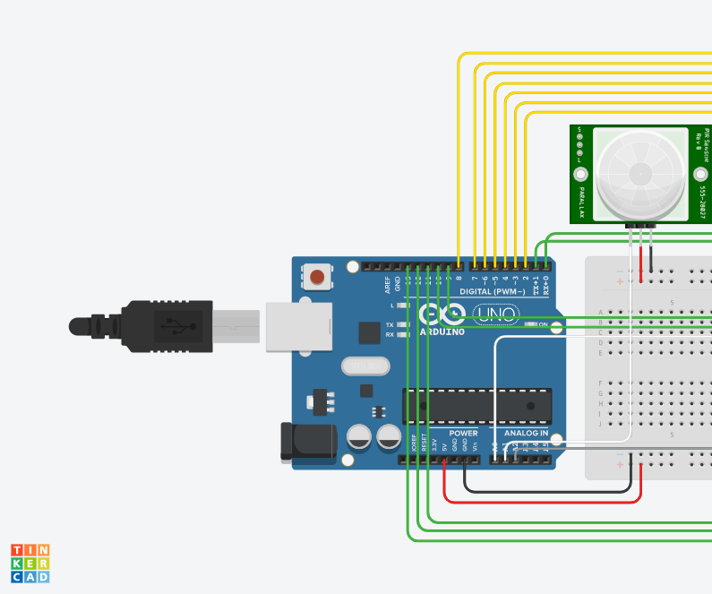

Step 3: Setting Up the Relay
Now we are going to set up the relay and connect it with the Arduino, but before we go ahead with the relay lets understand what a relay is and what it is used for. A relay is basically another form of a switch which is electrically operated, they control one electrical circuit by opening and closing contacts in another circuit. In most cases a relay basically allows a relatively low voltage to easily control higher power circuits, which is what we are doing in this project. Ok, now let's get to the part where we connect the relay!!!
There are 5 pins on the relay, common, normally open (NO), normally closed (NC), and 2 coils, refer to the diagram above for the pins. First, we need to connect one of the coil pins of the relay to the VCC rail on the breadboard, then connect a diode to the other coil and attach it to the VCC rail. The diode is in place to prevent voltage spikes or backward flow of current.
Now grab the NPN transistor and connect the collector of the transistor to the coil where the diode is connected to. Then connect the emitter side of the NPN transistor to the ground rail on the breadboard. Finally, using a 1KΩ connect the base of the transistor to the digital pin 2 of the Arduino.
Finally, we are going to do a really important connection. Take the extension cord we prepared and connect one black wire to the common pin in the relay and secure the connection with electrical tape. Then connect the other end to the NO pin of the relay.
Step 4: Connecting the PIR Motion Sensor
We also almost done, now we are going to connect the PIR motion sensor into the circuit but before we do lets understand what a PIR sensor is. The PIR sensor stands for Passive Infrared sensor, this sensor can detect the presence of human beings or animals, and send a signal saying it detected motion. The PIR sensor has 3 pins, VCC, Output and Ground.
First, we need to connect the VCC pin of the PIR sensor to VCC rail on the breadboard and connect the ground pin of the PIR sensor to the ground rail. Then we are going to connect the output pin to one of the Arduino pins, I used pin 4. You have successfully connected the PIR sensor now!!
