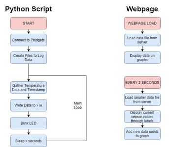

Step 2: Overview
The goals of this project are as follows:
  1. Create a Python program that connects to sensors and logs data to a file every X seconds (your choice on how much data you want to collect)
  2. Host a webpage on the Raspberry Pi that displays the collected data.
The flowcharts above show what each program should look like.

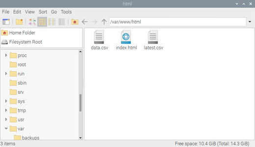

#Write Headers if file doesn't exist
if(not os.path.isfile('/var/www/html/data.csv')):
    with open ('/var/www/html/data.csv','a') as datafile:
        datafile.write("Date,Temperature(°C),Light(lx),Humidity(%RH),Pressure(kPa),Sound(dB)\n")

Infinite loop that gathers data from sensors and stores it to a file. Writing data in a CSV format here. If you have never used a CSV before, this project has some good information. In this section, we are writing data to two files:
  • data.csv is the primary data file that will hold the main information.
  • latest.csv is a small data file used to pass current information to the website.
More on these later.

Step 6: Website Review
Previously, we mentioned using the Raspberry Pi documentation to set up an Apache webserver. This information is also covered in this project.
It may sound complicated, but there are only two commands to run:
  1. sudo apt update
  2. sudo apt install apache2 -y
After running the commands in your terminal, you are ready to view/edit your webpage. There will be a folder under /var/www/html that holds all of your web files. In this next step, we will be editing the index.html file to create graphs and labels that display the Phidgets data. Note: /var/www/html is also where your Python script is now logging data. This is so that it can be served by the webserver and used by the website.

Main Flow
The website has two main parts:
  • Webpage load: when the webpage loads the main data file (data.csv) is loaded and the contents of the file are displayed on graphs
  • Every 2 seconds: there is a function that runs every 2 seconds (you can change this frequency) that grabs the small data file (latest.csv) and displays the latest data on the webpage AND updates the graphs.
