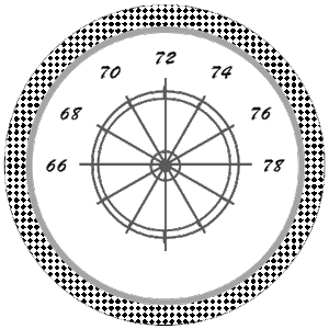

Step 3: Create Gauge Graphics
I created the gauge face using SmartDraw. I printed it on paper a few times to get it to print the right size.
Once I was satisfied with the size, I positioned the plain paper printed gauge face onto the brass plate and marked the center position of the gauge face.
I printed the same size gauge face onto parchment paper, cut it out, and added glue to the back.

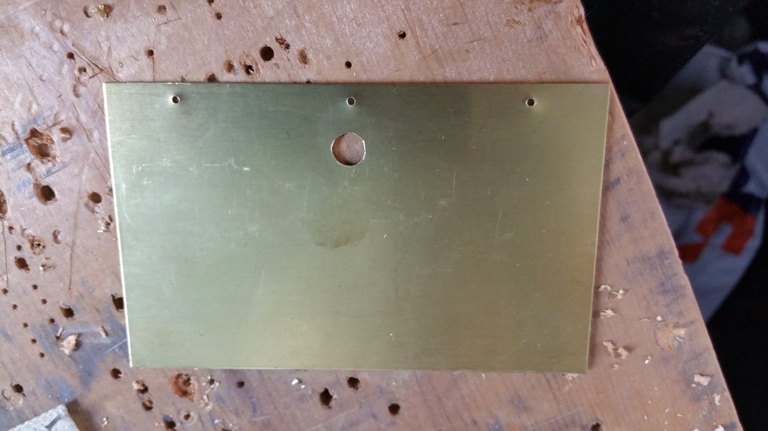

Step 4: Drill Holes in Brass Sheet
I marked the brass plate for the microservo hole, as well as three holes for the brads.
Using a hammer and a punch, I dented the brass. This divot keeps the drill bit from dancing all over the brass plate.
I drilled the three 1/16" brad holes.
I selected a 9/32" drill bit for the hole for the shaft of the servo. This gave plenty of room for the servo to turn, without touching brass and binding up.

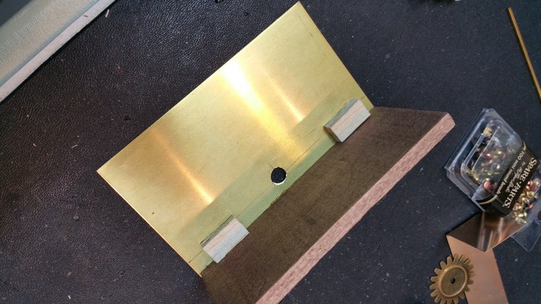

Step 5: Glue Brass Sheet to Wood
I mounted the brass onto the wood base. First I added a thin bead of glue, and then I secured it with the three brass brads.
To make sure that the brass plate was stiffly at a 90 degree angle, I added little stop blocks. They were glued.
When the glue was dry I added the felt feet.

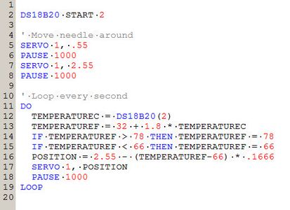

The program that runs this device couldn't be simpler.
DS18B20 START 2
This line starts up the measurement action of the DS18B20 on pin 2
' Move needle around
Servo 1, .55
Pause 1000
These lines move the needle completely to one end of the scale for a second.
SERVO 1, 2.55
Pause 1000
' Loop every second
DO
TEMPERATUREC = DS18B20(2)
At the start of the loop the temperature is measured from the DS18B20 on pin 2.
TEMPERATUREF = 32 + 1.8 * TEMPERATUREC
This converts the values that the temperature sends from C to F.
IF TEMPERATUREF > 78 THEN TEMPERATUREF = 78
IF TEMPERATUREF < 66 THEN TEMPERATUREF = 66
These two lines limit the temperature to 66 to 78 to keep the needle/gnomon on the gauge face.
POSITION = 2.55 - (TEMPERATUREF-66) * .1666
This line converts 66 degrees to 2.55 milliseconds and 78 degrees to .55 milliseconds to position temperature into the range that the microservo can move.
SERVO 1, POSITION
PAUSE 1000
LOOP
The SERVO command actually directs the microservo. After a 1 second pause everything is perpetually repeated.
If you break out of this perpetual loop (^C) and issue the command:
OPTION AUTORUN ON
then this program will run on powerup.
