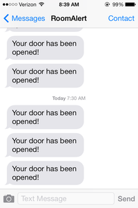

RoomAlert was the product I made that was designed for life in the dorms but could be adapted for other situations. RoomAlert would sit above the door it was monitoring and had a switch that was flipped when the door opened and reset when the door was closed. When the switch is flicked on it sends a signal to the arduino that is the heart of this project. The arduino is connected to a GSM cellular shield that sends a text message to a pre-saved phone number of the person whose room it is. Once the user receives the text message notifying him that his room has been entered he is able to call RoomAlert and it will use a microphone with an amplifier to listen in on whatever is going on in the room.

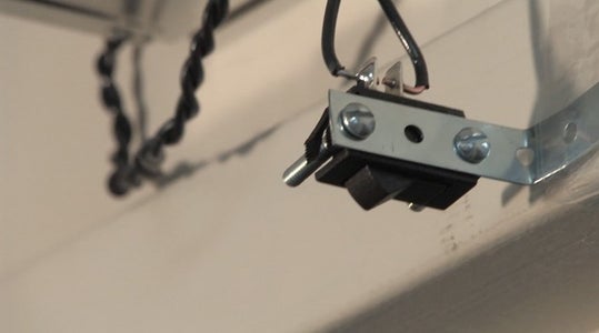

The device is attached above the door to the wall and has a rocker switch that is mounted with an L bracket so that it sits above the door (see picture in extras). The rocker switch is mounted so that the rocker part is just flush with the edge of the door. The plan is that the door will swing open, activating the switch, then that will signal to the arduino. Next, the arduino will communicate with the GSM shield and tell it to send a text message to the given number. When the door swings back it will flip the rocker switch back the other way so it deactivates the switch and the arduino will then reset. While all of this is going on the arduino is constantly testing the switch to see what position it is in and testing the GSM shield to see if it is receiving a call. If the GSM receives a call it will connect the user to the input from the microphone mounted on the enclosure of RoomAlert. The GSM shield takes this signal from the mic directly and send it to the user. The impedance of the mic must be correct so I found some links that showed how to set that up. See the Hardware: Microphone step for more details. As the device takes a while to connect I also installed a small LED to signal once the device is connected.

Step 5: Hardware: the Switch
One might wonder how we will make the arduino detect that a switch has been flipped. We have set a pin to read digital high or low in our software so we will use the switch to either connect the ground (low) to the pin or 5v (high) to the pin.
A great example of how to do this is on the arduino site at http://arduino.cc/en/tutorial/button. We will use this method to detect the switch.
In short, what happens is that the pin is connected to one side of the switch as well as a resistor going to ground. The other side of the switch is connected to the 5v pin. When the switch opens, the pin is connected only to the ground (through the resistor). When the switch is closed the pin is connected directly to the 5v pin. The huge ohm resistor keeps the current draw low when the switch is open though.
Solder two ~12" sections of the 18 gauge wire to the middle pin and one of the side pins on the switch. Twist the two wires together to create a thicker cable that looks neater and more compact. Route this through the enclosure sidewall (see Hardware: Enclosure for more details).
Use one of the jumper wires to connect a lead from the switch to the 5v pin. Attach a jumper wire and a lead of the 100K-ohm resistor to the other wire from the switch. The jumper wire is connected to pin 4 on the GSM shield.
Finally, solder a final jumper wire to the other end of the 100K-ohm resistor and connect that to the ground pin.

Step 9: Final Test
You have assembled everything correctly and everything appears to be working, let's put it to the test! Connect the arduino and GSM shield, make sure the circiutry is connected properly and give the arduino power. Wait for the LED to turn on so you know you have service and are connected. Be aware this can take a while (usually a minute or two for me but you have to move around a bit to find decent service). Once you get service try flipping the switch a few times and checking to make sure you are receiving text messages. Once this is all working try calling RoomAlert and if it picks up try making noise in front of the mic then slowly get further from it to see the mic's range. If any of these aren't working your best friend will be writing new code using what I gave you and the examples arduino gives you to try and figure out the problem. A useful tool for trouble shooting is using the serial port in the arduino IDE to figure out the problem; see the arduino examples for this as most of them use it.
