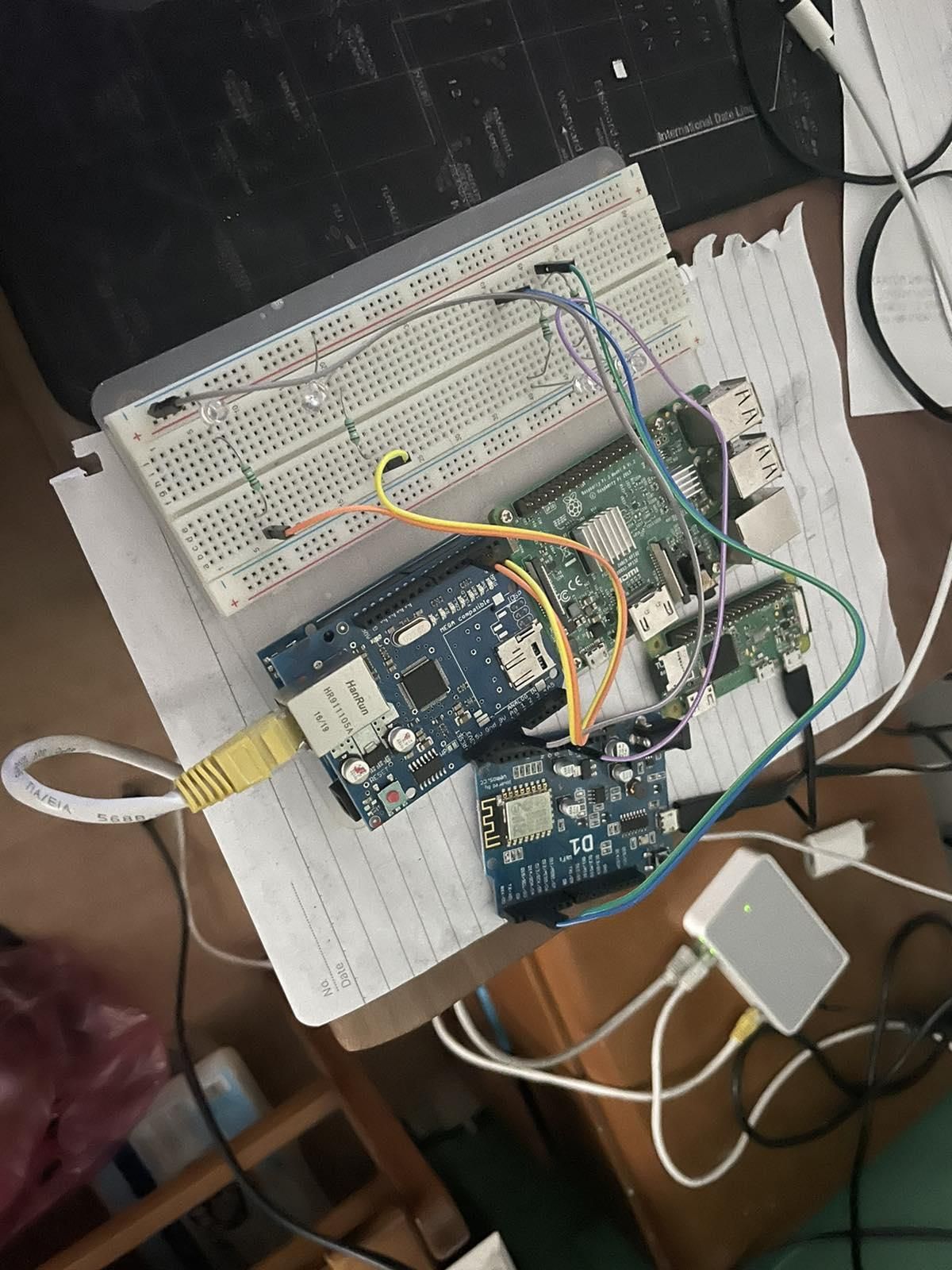

Step 2: With Simple Words What Is Make All Project
In the Arduino pins we can see were we connect every sensor.
  • Light
PIR in PIN analog A5
Photo resistor connect in PIN analog A4
Also have GND and get 5volt power from Arduino
Use PIR and Ligth resistor sensor together. When the room is dark and the sensor detect movement opens the light and notification the smart phone application for the movement and the light on.
The light is a led strip which connect in the relay and 12 volt charger and is put on the floor to light for a second the room. Also if the sun goes up and the light is useful and west electric power then Arduino is turn of the light.
  • Temperature and Humidity
Temperature/humidity in PIN analog A3 NEED 3.3VOLT not 5volt Attetion
The DHT sensor send in phone the temperature and the humidity when user ask it from the app. I have a small fan which when the temperature get higher than the 30 Celsius degrees is tern of the fan when cool down to 30 Celsius degree is turn off the fan. The fan connects to relay in same 12volt power supply which connect and the led strip.
  • IR
IR connect in PIN 9 and GND
I have save all the code of the 24 key from the led-strip. The app is control the led strip remote using the IR.
  • Ethernet shield
The Ethernet shield is connects with the router and communicate via UDP with the app of smart phone. This give as the flexibility to open light from the app, open and change the color of led strip , get the temperature, humidity , gas if exist in room, if exist motion and other.
  • Push Button
Push Button connect in Pin 2 GND and 5volt
The push Button is used to open the light from the button
Step 3: Ethernet Conection and Code
The UDP is work like the second image when the sender have the message then put the UDP header after the IP header make the frame and send it to the receiver the receiver remove the headers IP and UDP and get the message and replay with same way. For this reason we need the IP and the port of the Arduino to send the firt message from the app and from this message the Arduino get ip and port of app to replay
First connect the Arduino Mega with the Ethernet Shield.
You need to do the Include libraries SPI.h Ethermet.h EhernetUdp.h and SD.h
After set MAC of Shield the mac is in an sticker in the Ethernet shield or you can use the mac i write bellow and a Port.
// Enter a MAC address and IP address for your controller below.
byte mac[] = { 0xDE, 0xAD, 0xBE, 0xEF, 0xFE, 0xED };
// The IP address will be dependent on your local network:
IPAddress ip(192, 168, 1, 15); use this IP to work the app
int localPort = 8888; // local port to listen on
