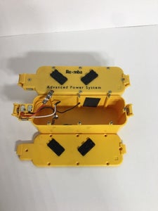

Step 1: Bottom Plate Surgery
First thing is to get a bottom plate. Then cut the battery box off. I did this with my hack saw and then cleaned it up with my Dremel. Make sure that you keep the battery connectors and connector cover with screws.
