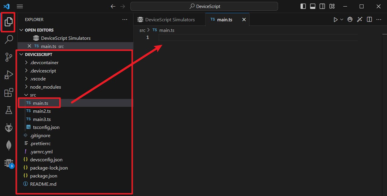

Open the "main.ts" file in the DeviceScript environment.

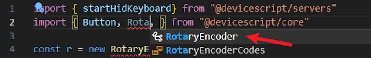

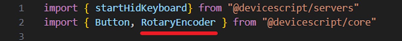

Prior to importing the RotaryButton, it is necessary to bring it into consideration. As for the decision to use a RotaryEncoder, you can refer to the documentation provided here for further information. RotaryEncoderServer | Jacdac TypeScript - v1.33.4 (microsoft.github.io)
A helpful suggestion: You can also utilize code completion feature to aid your understanding.

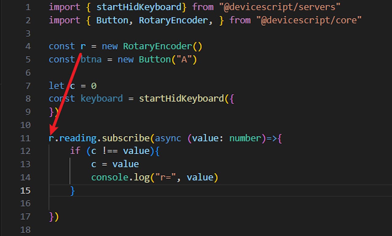

We endeavor to compose a program that aims to retrieve the numerical alterations triggered by the rotary encoder.
import { startHidKeyboard} from "@devicescript/servers"
import { Button, RotaryEncoder, } from "@devicescript/core"
const r = new RotaryEncoder()
const btna = new Button("A")
let c = 0
const keyboard = startHidKeyboard({
r.reading.subscribe(async (value: number)=>{
if (c !== value){
c = value
console.log("r=", value)

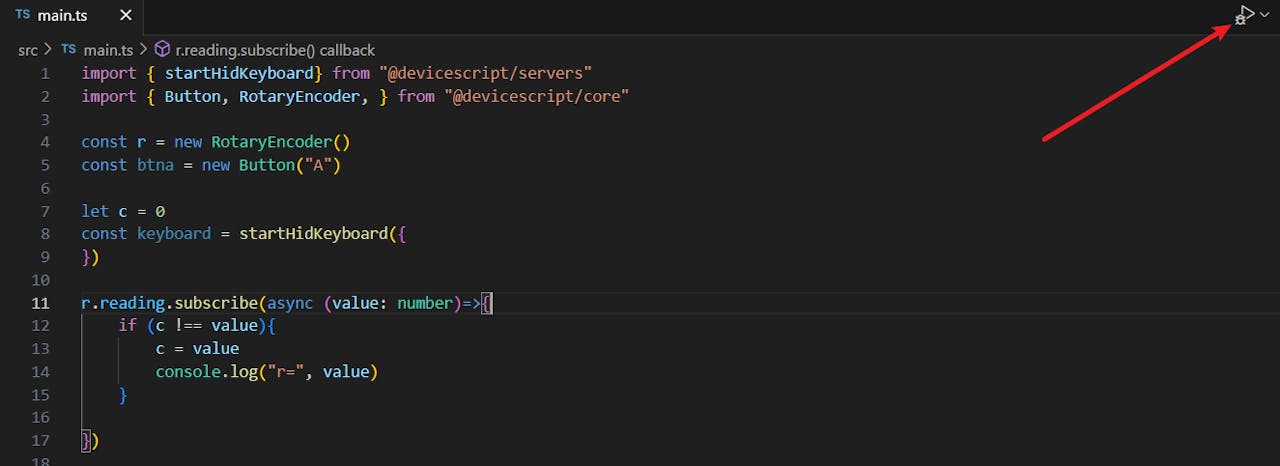

Click to execute.

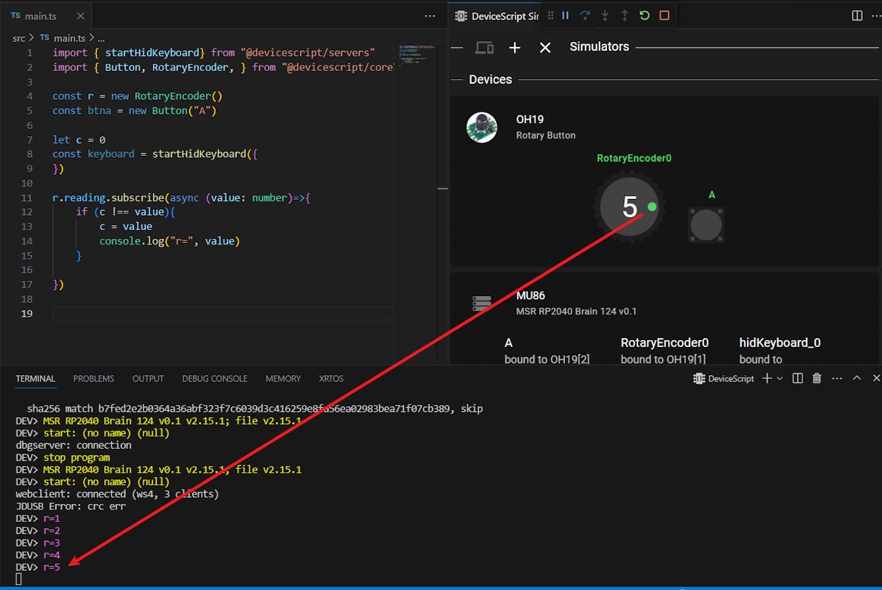

Upon execution, observable is the alignment between the values returned by console.log and the outcomes procured from the simulator.
