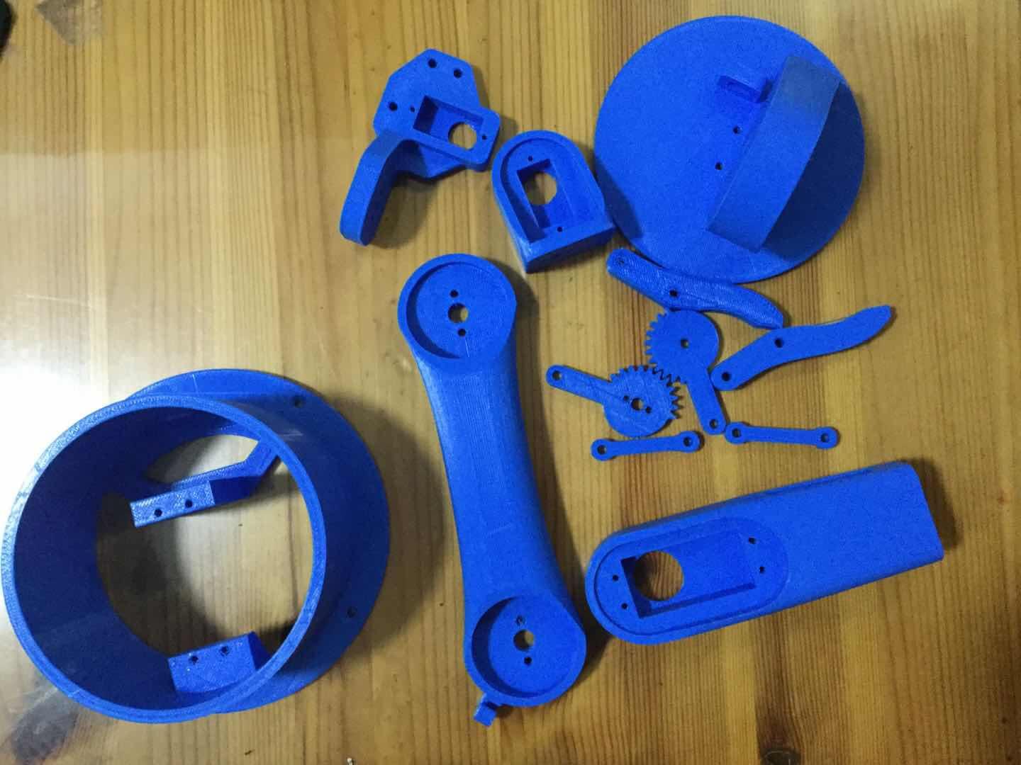

Step 4: The the STL Files
The STL files I got from online and did a bit editing.
