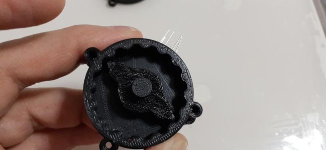

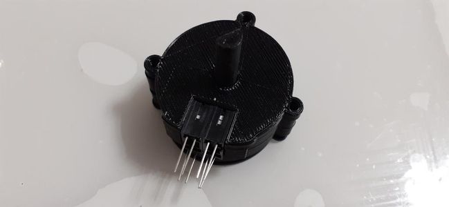

3D printed optical rotary encoder using cheap 3d printer.
It cost you almost nothing if you have the optical sensors ..
Rest of the components are just cheap.
I prefer you use small metal balls .. I don't have it so I printed them. But using small balls might make the clicking-mechanism smoother.
Step 1: 3D Print the Parts
Print all parts as shown .. Don't print the sensor :)
I have the files at
https://www.thingiverse.com/thing:4704519
You need a spring and some glue and screws.
look at the video for more info.
