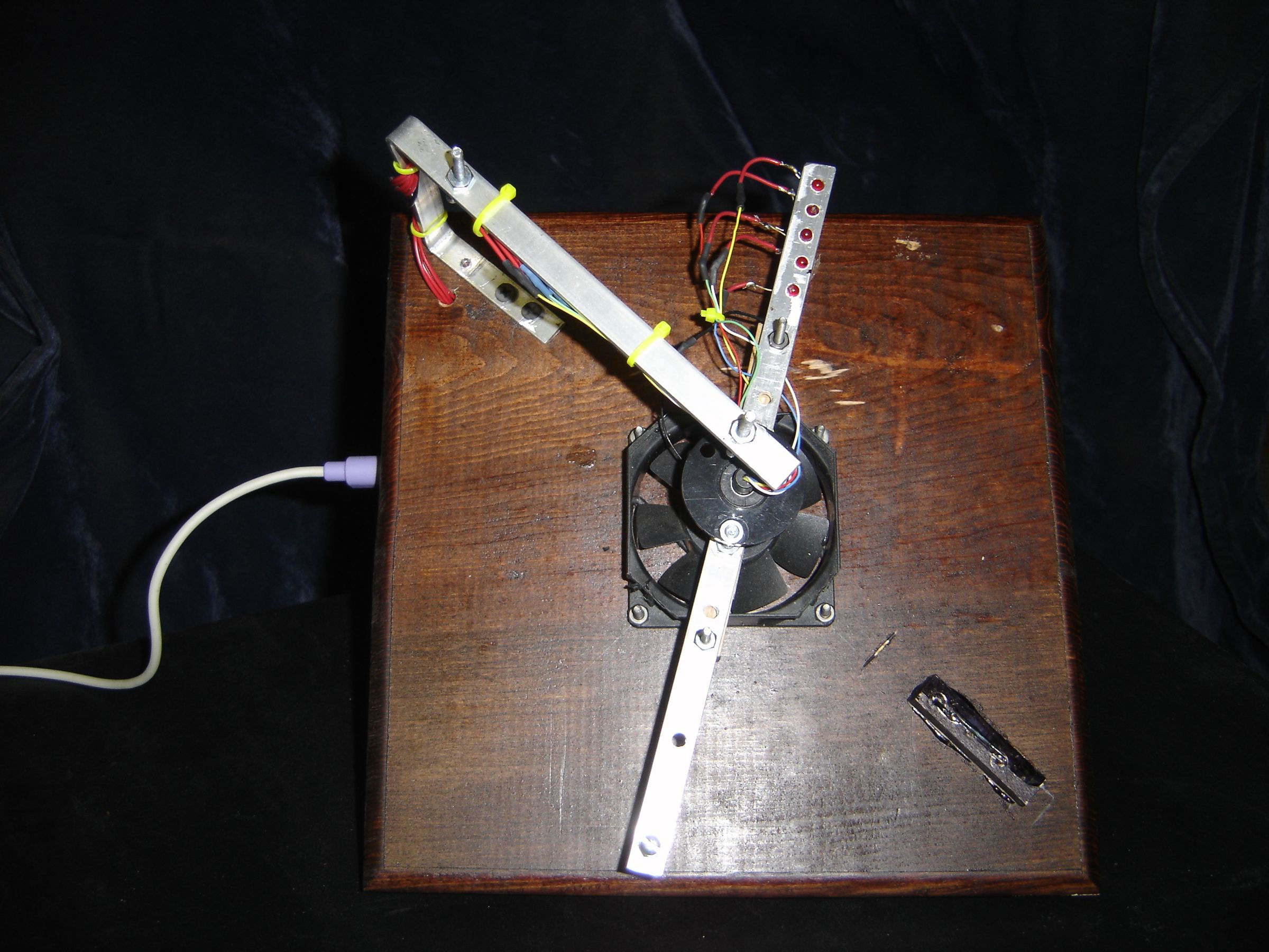

- But if the correct sequence is dialed, in this case my daughters name, the arduino will play the "Happy Birthday song" , spin the metal screen and light the UV leds. This will reveal the "Happy Birthday message I wrote on the screen with the invisible ink pen.
video to follow
So basically what I have is:
The Arduino records the rotary phone input as a string and then the code checks for a particular string.
If it is not that string, it then plays one of 5 songs that are encoded in the sketch.
If it is the correct string then the arduino instructs the servo to turn and lights the UV lights and plays the birthday song.
The code follows:
I found pieces of it here and there. The tone function is used along with a pitches.h file.
