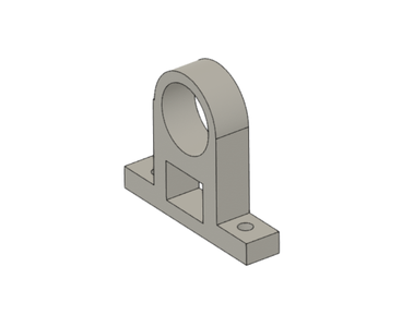

Step 1: Design Clamp and Cutting Table
  • Start your computer and design your part Using Tinkercad.
  • I use the INGCO Rotary tool to make this project.
  • You can Buy it on Amazon for $50.
  • The first measure Diameter of thread on top is around 22mm and the diameter of the center Round part is 48.5 mm.
  • According to your Rotary tool Measure it and make a clamp design to fix the rotary tool on Board.
As in Image
1> INGCO Mini Grinder Rotary Tool.
2> Big Clamp To Fix tool From the center
3> Small Clamp to fix tool from the front
4> cutting Table to place material and Cut.
