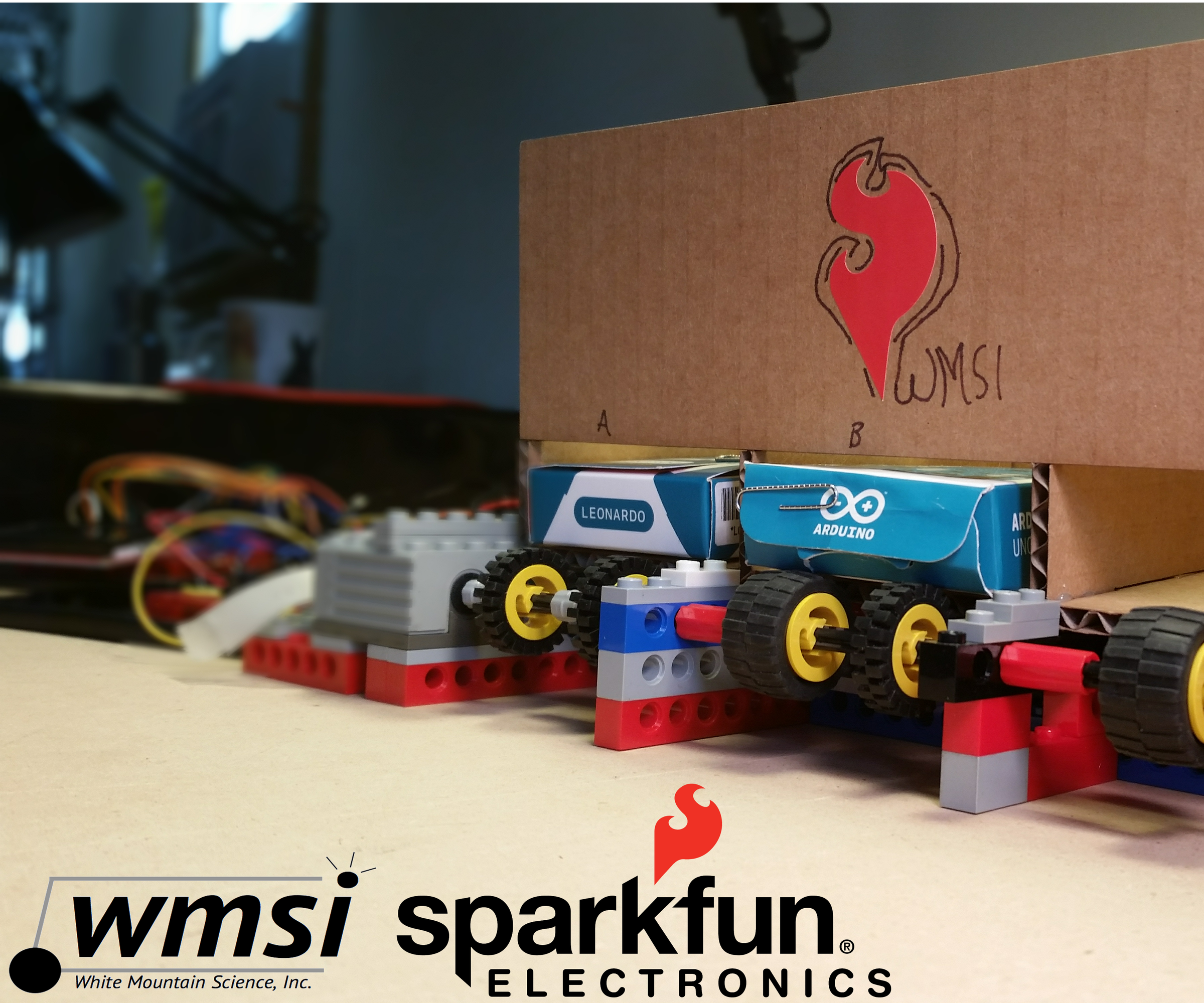

Step 7: Building the Machine: Product Bins
For most of our testing we continued to design around the idea of vending a arduino-ish sized box. As it turns out the part of our design that has gone through the most iterations is the design for the product bins and in the end they are still nothing special. We stuck to cutting ours from cardboard. Makercase, a pretty awesome website if you haven't checked it out, was used to generate the .svg files for our boxes that we were dispensing. You can visit their website here.
