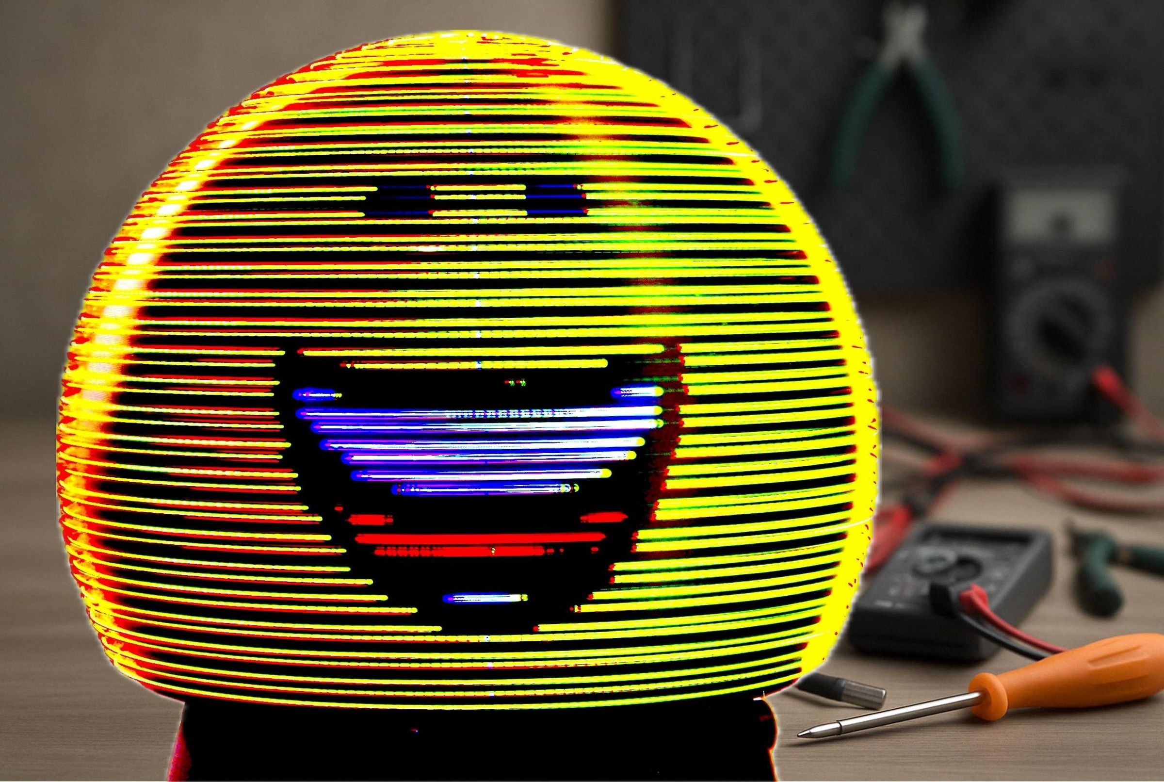

The Rotating Color LED Display is a compact disc-sized display with 56 color LEDs. It displays animated images as well as time and weather data from the Internet. The device is wirelessly powered and controlled via a user-friendly web interface. It uses ESP32 and RP2040 microcontrollers.

The display board is equipped with a row of 56 color LEDs. The LED operations are controlled by a RP2040 microcontroller, while an ESP32 microcontroller generates the display content. Images (including animated images) can be stored on and loaded from a micro SMD card. The ESP32 maintains a Wi-Fi connection to the internet, which allows the device to retrieve the time from a time server, ensuring time accuracy. It also allows for the acquisition of weather data.
An important requirement for the display board is that the center of mass of the unit is exactly in the middle, on the axis of rotation of the motor. This is the only way to ensure smooth and vibration-free running of the display. To achieve this, the electronic components are arranged largely symmetrically. Residual asymmetries are compensated for by balancing weights (M3 screws and nuts).
