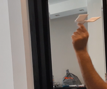

Step 5: Prepare the Kite to Flight
decorate kite using spray paint or use colorful stickers
insert the wing to the will
tie for each paper clip short string 70 cm long
tie both strings at other end and make small loop for main string
