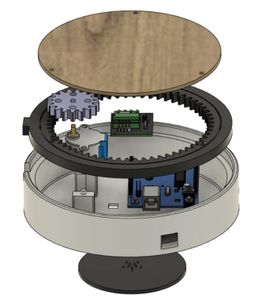

Step 1: 3D Model (CAD)

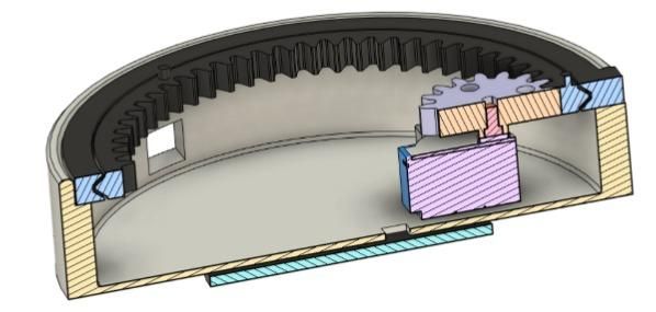

We used CATIA V5 Software to design the system. The model is composed of a plate, an internal gear with a stator, a pinion and the structure (casing). We took into consideration the space required by the electronics and we added some features to have an easier assembly.

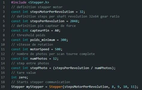

The Arduino code is divided into three parts.
  • The first part is used to define all the constants and PIN behaviors in the system.

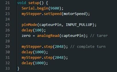

  • The second part is used to initialize the motor, using the library "Stepper.h". We have also included two complete rotations, to ensure the functionality of the system.

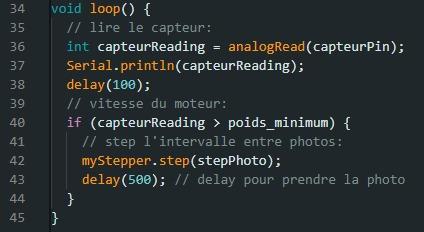

  • The third part is used to read the value of the sensor, comparing this value with the calibration value "poids minimum". If the analog value read by the sensor is greater than the calibration value, the system turns.
The code file can be found here below, feel free to improve it!!

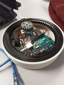

Step 4: Assembly
To do the assembly, the electronic connections are represented in the different schemas in this step. The Force sensor was glued close to the center of the lower face of the structure so that the terminals could be inserted into the lower casing hole. We used tape to put the Arduino in the box, and scotch tape to fix the presionador in the external face under the structure touching in this way the force sensor.
Step 5: Turn on the System
To start the system you only need to connect the Arduino to a 5V source, for example, your PC !!!
