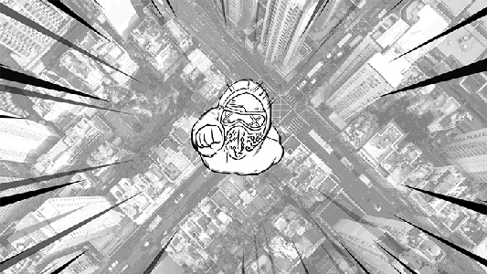

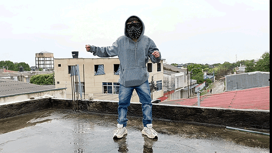

Step 11: Scene 7
In scene 7 the character flies towards the camera demonstrating his power.
You can compare the original and post-processed scenes to see the respective edits made.

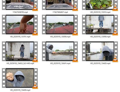

After recording our scenes and selecting the final ones, you will have to precompose them. For this, I will use Adobe Premiere, but you can use any video composition software of your choice.
To compose your scenes, drag your files into your favorite video editing program, and organize them according to the script you created.

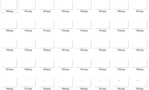

Step 17: Timeline
After composing your video, you will need to export it. In order to work on it in the rotoscoping style, you need to export it in jpg, which will create a folder where each frame will be an image in jpg format,
so in the file tab select export and then media
Open the image sequence in photoshop, there a timeline will be created, in which you must choose the speed of the frames FPS
The FPS are, basically, the number of images joined together that are needed to create a second of video. The number of images that fit in a second will be the number of frames per second that a video has. Check the animation video indicating how to adjust the fps, although my program is in Spanish it is quite intuitive

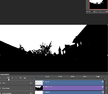

For some scenes I used filters from the Photoshop filters and effects gallery to speed up the work, I mostly use them in the backgrounds or in static scenes, in scene number one I used a filter from the sketch gallery called stamp to separate the sky from the buildings.
So I can edit the background separately and make a glow effect using a dark layer and lowering its opacity with a keyframe. A keyframe marks the point in time at which a value is specified for a layer property such as position in space, opacity, or audio volume.
in this case controlling the opacity from 0 to 100 on the dark sky.

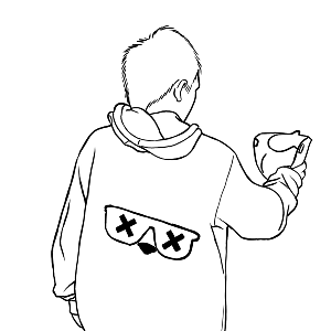

Step 19: Keyframe
Now in the composition select a frame where our object or main character is clear, in this case
the meteorite where the mask is supposed to come from.
Keep in mind the frame number and when saving your illustrated frame, make sure to keep the same number of the respective frame.

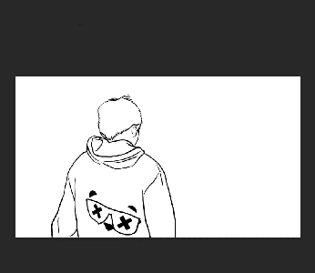

Step 20: Example of Keyframe Scene 2
select the best frame of the original clip, the most detailed and clean frame to illustrate, this will be our keyframe, keep on mind Ebsynth will use this keyframe as a default style for the other frames, then illustrate it and add the desired details and style, and then save it as a jpg in high quality.
When you are going to save the frame illustration, locate the respective original frame, and give it the same number name, to distinguish it, put an extra name like in my case "illustrated"

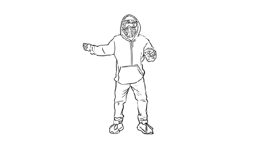

The style I will work with will be outlines, as it gives me more freedom to modify details such as shadows and backgrounds. It is also easier for post-production editing for the final product.

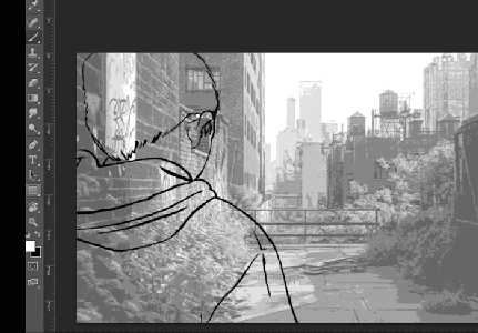

Step 21: Draw the Frame
For long scenes you will need to illustrate more than one keyframe, so try to locate in the scene where the exponentially sharpest changes occur and make an illustration of those frames.

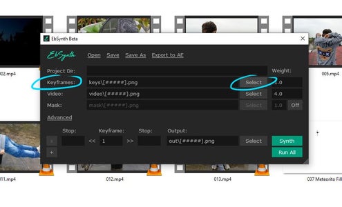

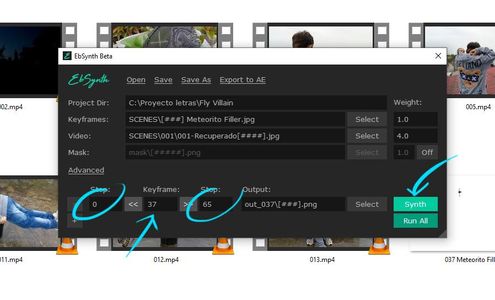

Step 22: Ebsynth
Now we will open ebsynth, its interface is very simple but efficient.
The most important thing is to keep in mind the following boxes: keyframes and video.
In the keyframe box, always drag the illustrated keyframes with the style applied.
And in the video box, drag the sequence image folder from our original video.
*The other boxes like mask and advanced options will not be covered in this instructable, but as its name indicates it generates a mask to separate the character from the pre-recorded background.
Step 23: Ebsynth
Now select the illustrated frame, or the one with a style applied, and drag it to the Keyframe box
Then drag the original frame from its respective folder to the Video box.
You can select them from the browser or drag them to the indicated box.
Step 24: Output
Now click on sync to start the program, based on the original frame, the illustrated frame will modify the rest of the frames, in this case from 37 backwards and forwards. This is where the complexity begins, because if the video has a lot of detail, in some cases the initial image will be deformed, so we will have to draw, edit frame by frame and retrace.
The program will create an output folder, where the new frames based on the illustrated image will be created.

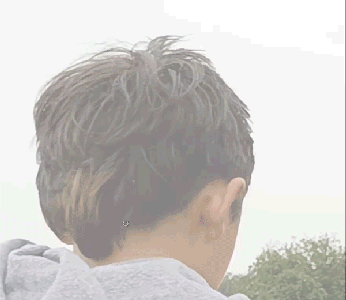

Step 26: Edit
To edit the resulting images from ebsynth, import them into Photoshop, select the folder where they are located and clicking on the first image (000) and checking the image sequence box will open it, which will generate a consolidated video on a timeline, remember to select the specific frame rate for your project. As I indicated in this project, I am working with a time base of 12 frames per second.
The resulting timeline will allow you to move frame by frame and draw on it, but first you will have to create a new video layer with the original recordings which will go below the illustration layer.

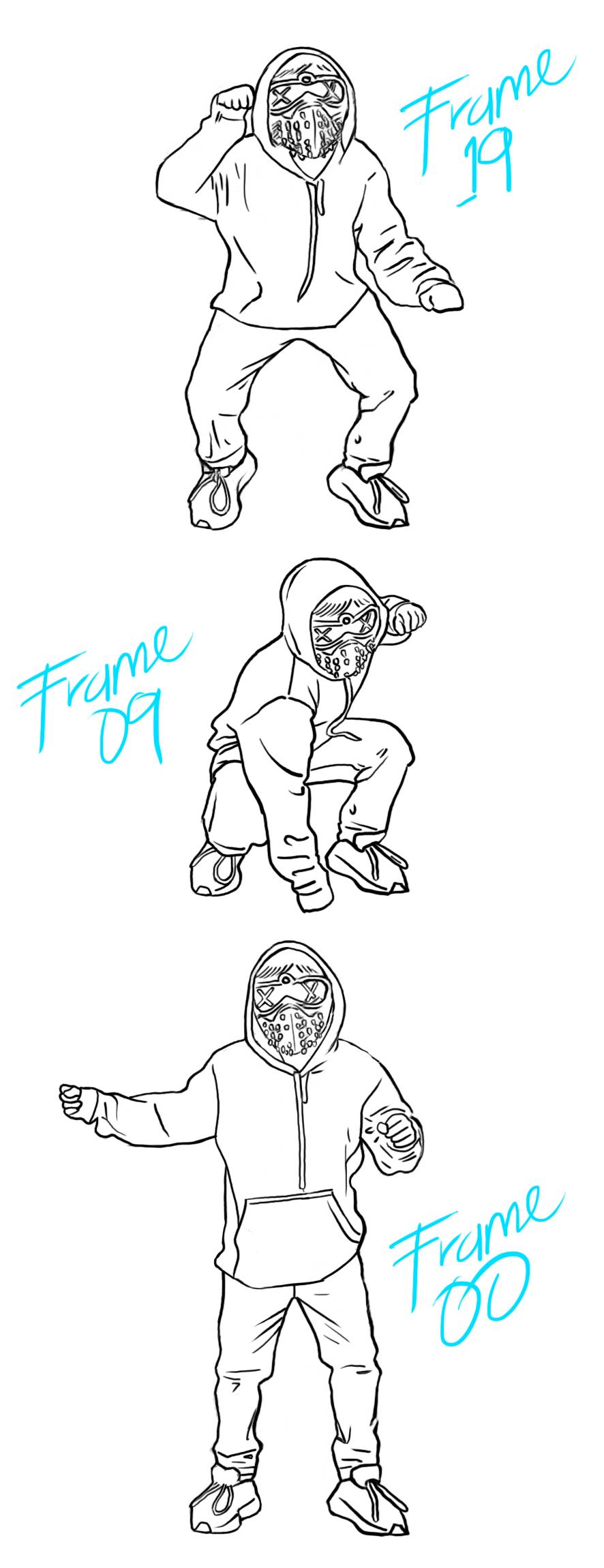

What I recommend, as I said at the beginning, is to work on each scene separately. Each scene means the creation of hundreds, even thousands of jpg files since the sequences are generated which can sometimes exceed 100 frames. That is why it is better to start a scene and finish it, to avoid confusion.
Step 28:
Ebsynth is not completely perfect, if you prefer to do the animation frame by frame you will not need Ebsynth, but by using it you will speed up the animation process by 40%, although in styles with more detail it generates more errors, and when editing in post production it will be a complete mess.
Here is an example of how even making 3 different frames, the results of Ebsynth are not as expected.

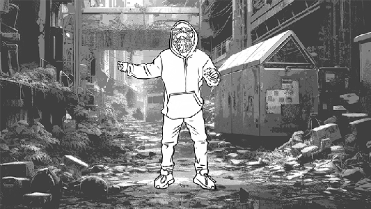

For the scene backgrounds, I searched on Google for post-apocalyptic images of an abandoned world. Although I was able to use the locations from the original videos I filmed, in some cases I decided to change the backgrounds for more realism, and in the flight to the sky I used the background of a bird's eye view of the city.
Image credits to all respective owners.
Step 31: In Shot Background
If you want to work with the backgrounds of the environment in which you recorded the original videos, you can give it your own style. In my case, I added a Photoshop filter to make it look illustrated.
Step 32: Details

To finish the scenes, a final revision must be made, where small details that Ebsynth cannot recognize are retouched, as you could see in the previous step.
So in this step you should go frame by frame editing errors and anomalies that may exist in the results.
This process is arduous and the time it will take you to edit depends on the complexity of your scenes, in my case and in this short it will take me more than 7 days.

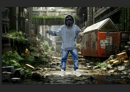

(like in scene 7 where the character flies over the city.)
In this case, I reflected the character to give realism to the water on the floor.
