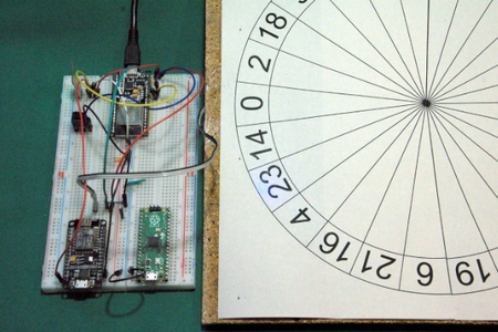

From the 1M LED strip with 30 LEDs per meter, we need 25 pieces for the roulette circle and one for the status display. We also solve the stubborn supply lines (red, green, white) on the strip input and replace the cables with flexible, thinner.
illustration 1: Connection of the strip
The strip section with the 25 LED segments has a length of 100 cm / 30 x 25 = 83.3 cm. As the strip of the strip, I chose a square chipboard of 9 mm thickness and 30cm edge length. From this, a circle of 83.3 cm / (2 x 3.1415) = 26.5 cm diameter is cut out so that the strip fits precisely. The end of the strip is isolated with adhesive film. A three -pin pin strip is soldered to the end of the supply cable.
illustration 2: Frame dimensions 300mm x 300mm
To cover the frame, I printed out a rosette with the numbers from 0 to 24 on two DIN A 4 leaves, which are glued together and attached to the frame (Part 1, Part 2). Incidentally, I decided to reduce the original figures from 0 to 36, as can be found in the original roulette, to 0 to 24, because I get By with a single LED strip of 1m length and the whole thing does not become so large (26.5 cm instead of just under 40 cm diameter!)
I also soldered a three -pole pen strip on the strip segment with the individual LED. To see in Figure 3 left under the ESP32. On the collected Breadboards, all three controllers with which I tested the circuit are peacefully united. The service is the ESP8266-Amica bottom right.
illustration 3: Test setup with the three controllers

The circuit is not very demanding and for the ESP32 ESP8266 and Raspberry Pi Pico- Families running. If the structure is to run without a PC connection, we naturally still need a voltage source of 5V for operation. This can be a plug-in power supply or, for example, a battery owner with lithium-battery of the 18650 type.

The extended program is now under rouled3.py Saved and runs on all three controller families without further adjustments.
So that this works without a USB connection to the PC, we have to use the program under the name main.py Upload it into the flash of the controller. The controller starts autonomously at the next restart or reset.
