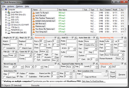

You need the Arduino code to be able to construct the full path of your songs on a random basis. This means the file names need to have an incrementing numerical component and be otherwise identical. The simplest way to to do this is to rename all the files (or more conveniently, copies of the files) as just a number starting at 01 and incrementing through the last file. The result is: "01.mp3, 02.mp3, ..., 099.mp3, 0100.mp3" (The proceding 0 is necessary because of the code). Just be aware that you need to know where your bad songs are and they need to be in one block. For me songs 1-75 are good and 76-100 are bad. I used a program called Bulk Rename Utility which is powerful but not especially user friendly.
With your files renamed, transfer them to the root level of your micro SD card. The card should be formatted using the FAT16 format prior to transferring any files.
