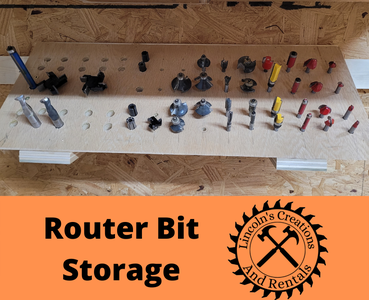

So I have been slowly accumulating router bits in a drawer and decided it was time to get organized so I can see everything I have. I made this storage rack using french cleats to match my storage wall and used nothing but scrap wood (plywood and 1x4s). I did use some random screws, my brad nailer, and some wood glue.

Step 3: Plot Your Organizational Needs
We set out by developing a grid across our board and then organized all our router bits to make sure we had enough spots and a few for potential new pieces we acquire in the future.

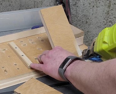

Step 4: Cut 45 Degree Angle at Top of Storage Block
We use the table saw to cut a 45 degree angle cut across the top of the storage board.
Step 5: Drill Holes and Sand
We drilled 1/4th inch and 1/2 inch holes to match our organizational needs then sanded both sides. Be sure to drill them a little loose (oversized) so that the bits slide in and out easily.
Step 6: Add 45 Degree Cut to Bottom of Storage Surface
We also cut a 45 degree angle to the bottom of the storage board.
Step 7: Attach a Stopper for Collet Reducers
We have a handful of collet reducers for using 1/4th inch bits in a 1/2 inch collet router. Since they have no shape that would hold them in the slot, we added a stop block using some scrap wood and screws.
Step 8: Trim and Attach Cleat
Trim the top cleat to the width of the storage board and attach it using wood glue and the brad nailer.

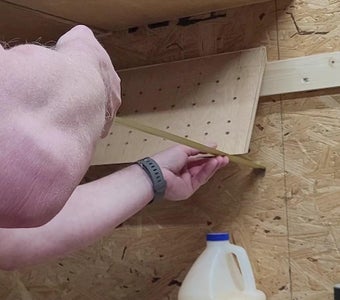

Step 9: Cut Support Braces
Measure the depth of the unit as it's mounted loosely on the wall cleat and cut out at least two support braces
Step 10: Attach Support Braces
Using wood glue and the brad nailer, attach the support braces to the bottom of the board, flush at the 45 degree cut.
Step 11: Mount and Enjoy!!!
Just hang it up on the cleat and you're good to go.
