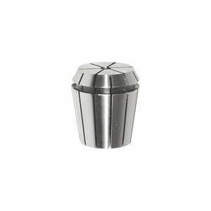

Once you have your Industrial CNC Router running, you're ready to start thinking about your router bits. The Industrial CNC Machines use an ER-20 Spring collett (unless you have an Auto ToolChanger in which case you'll use BT-30's) These collett's are available in a variety of Imperial and Metric sizes, which you'll match up with the shank of the bits you're using. If you're using a 1/4" collett, you'll need bits with a 1/4" shank.

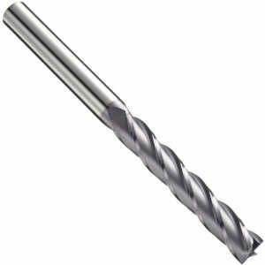

For cutting, you'll most likely be using End Mill bits. They're similar in design to drill bits, except the have blades on the side to allow for horizontal cutting, rather than simply plunging up and down. The two parts of the bit are the shank and the cutting area. Insert the shank only into the collett leaving the cutting area exposed. For ideal results you'll want to use the shortest bit possible for the job as the longer it is, the more tension is taken up by the bit and the more likely it is to snap.
There are many varieties of bits available, and specialized bits for any material you'll be cutting. For long bit life and the best cutting, you may want to consider some good carbide bits. In a pinch, the bits at your local Home Depot will work, but they won't last as long or cut as cleanly.
You'll find that there are many types of end mills available. The two main types are upcut and downcut. The upcut pulls waste out of the cut, while the downcut does the opposite. The downcut type leaves the top surface cleaner, while the downcut leaves the bottom cleaner. It should also be noted that the upcut endmill bit pulls up on your material so it's more important to have it held down securely.
For cutting wood, either can work, but for plastics and other materials you may want to go with an upcut to prevent wasted from melting into the path it left. There are also different flute patterns (single, double, etc.) which are useful for better cleanup and finishes.
A straight end mill bit is useful for most cutting, but if you're planning to do any relief or 3D work, you can also consider a ball nose endmill bit. This is simply an endmill with a rounded tip, producing a smoother finish than the flat tip of the traditional endmill.

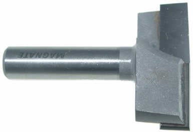

You may also want to fave a fly cutting/planing bit on hand if you have a lot of surfacing planned. This bit has a flat bottom designed for skimming the surface of your material. You can get them in very wide diameters, cutting down your work time, but again, it is not an endmill bit, and not for deep cutting.

3) Tighten the cap over the collett, after the bit is inserted. Make sure the collett is flush with the bottom of the cap.
