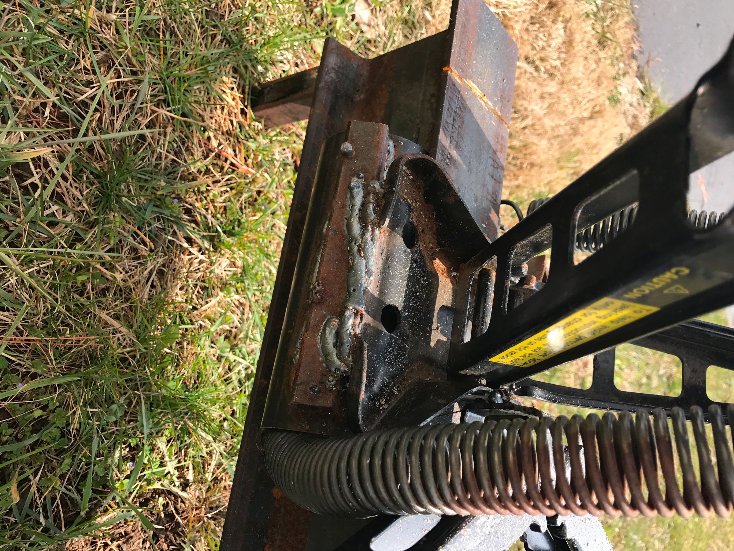

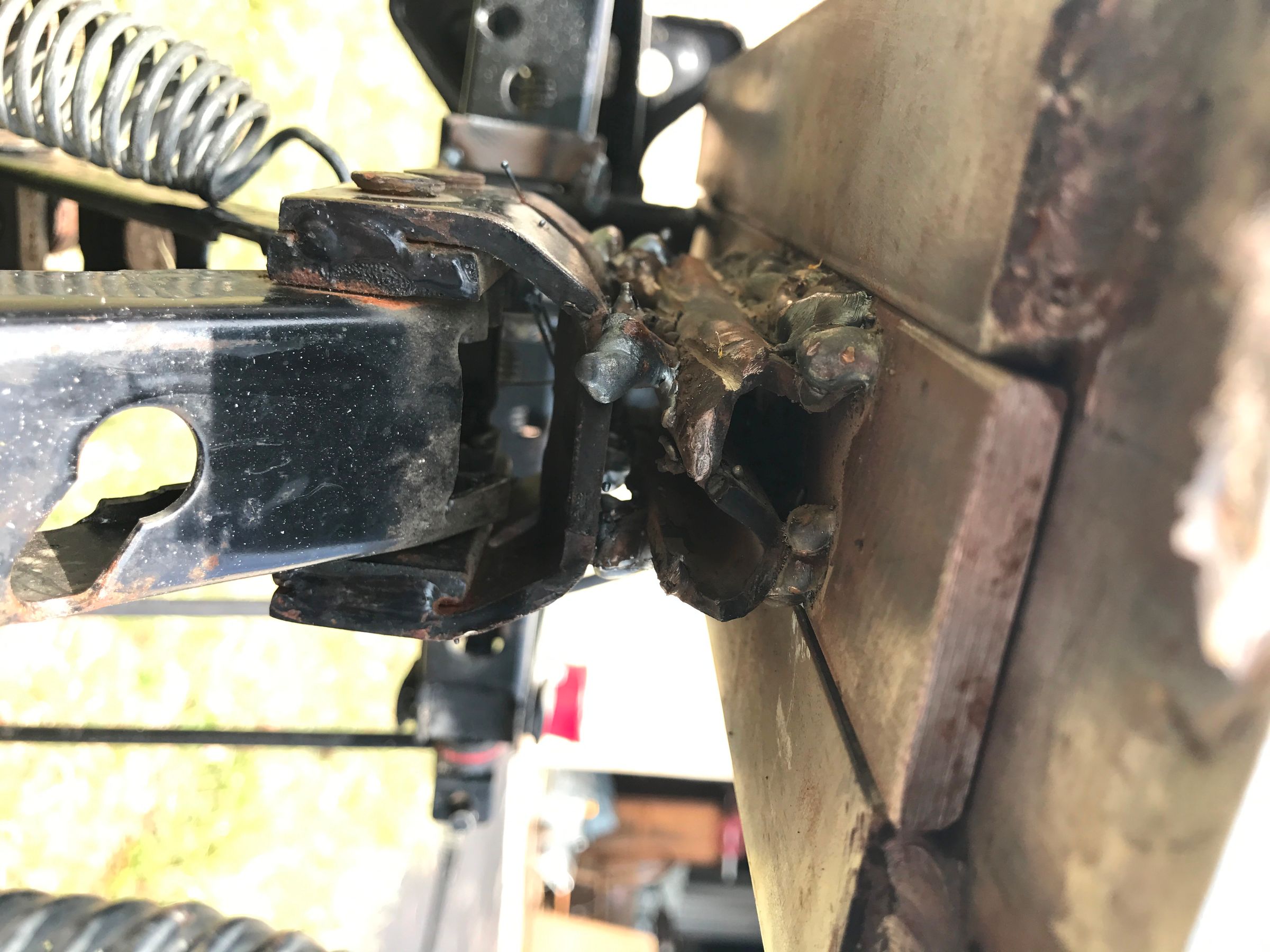

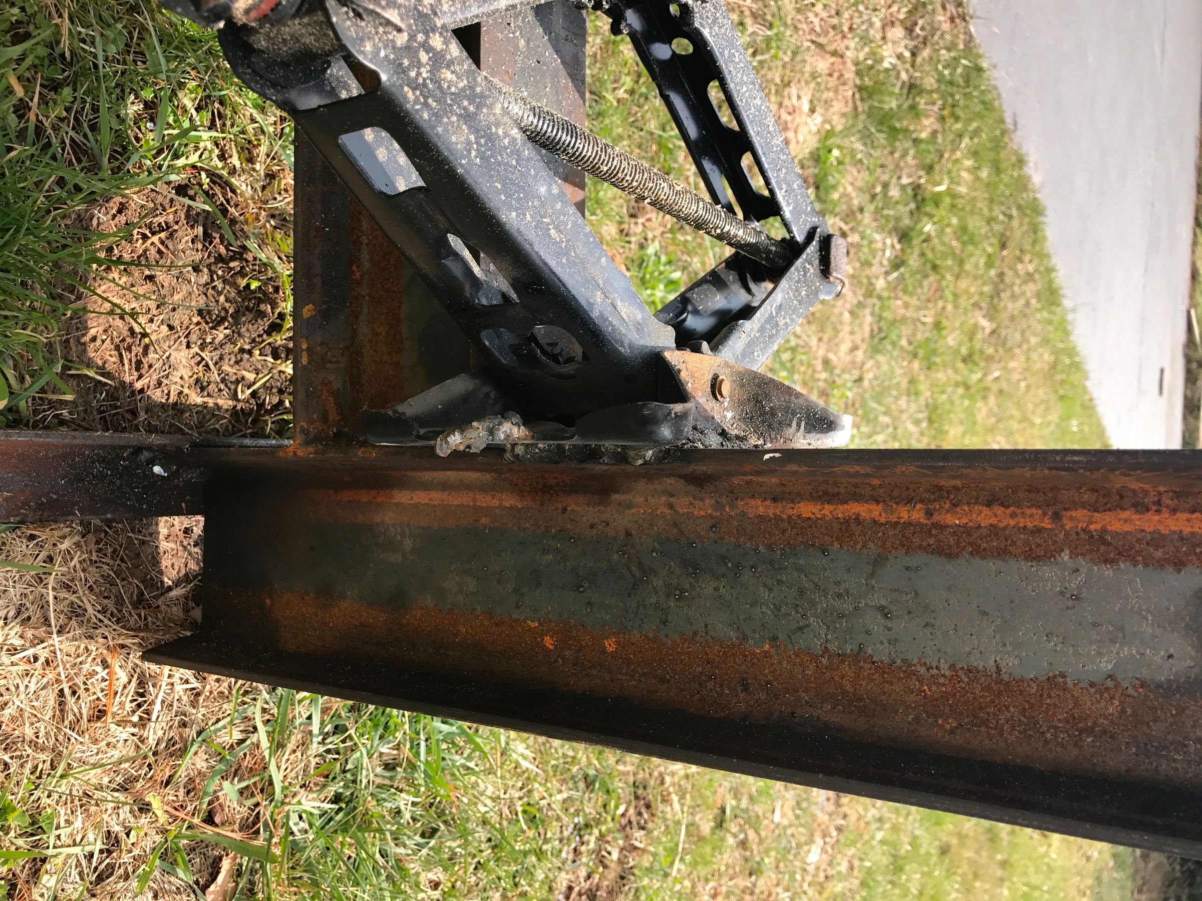

Step 3: Weld
First, Weld the shorter I-beam piece a half inch above the bottom of the longer I-beam then weld the 18 in. circular pipe to the I-beam at the top.
Next, weld a 4 in. circular metal pipe to a 4 in. square metal pipe and do that again.
Then put the pieces on the inside edge of the "knee" and weld the square part to a scissor jack so that it slides.
After that, weld a jack to the "base" I-beam right next to the "knee"
Next, weld the top of that scissor jack to the bottom of the 2nd scissor jack
Then weld two 1 ft. pieces to a 5 in. x 1.5 ft. rectangle with enough space in the middle for another 1 ft piece
After that weld the bottom of the third jack to the piece that was just welded and then slide a 1 ft. piece between the two other ones and weld the top of the 3rd scissor jack onto that piece.
Next weld the top of the 2nd scissor jack to the 1 ft. piece
