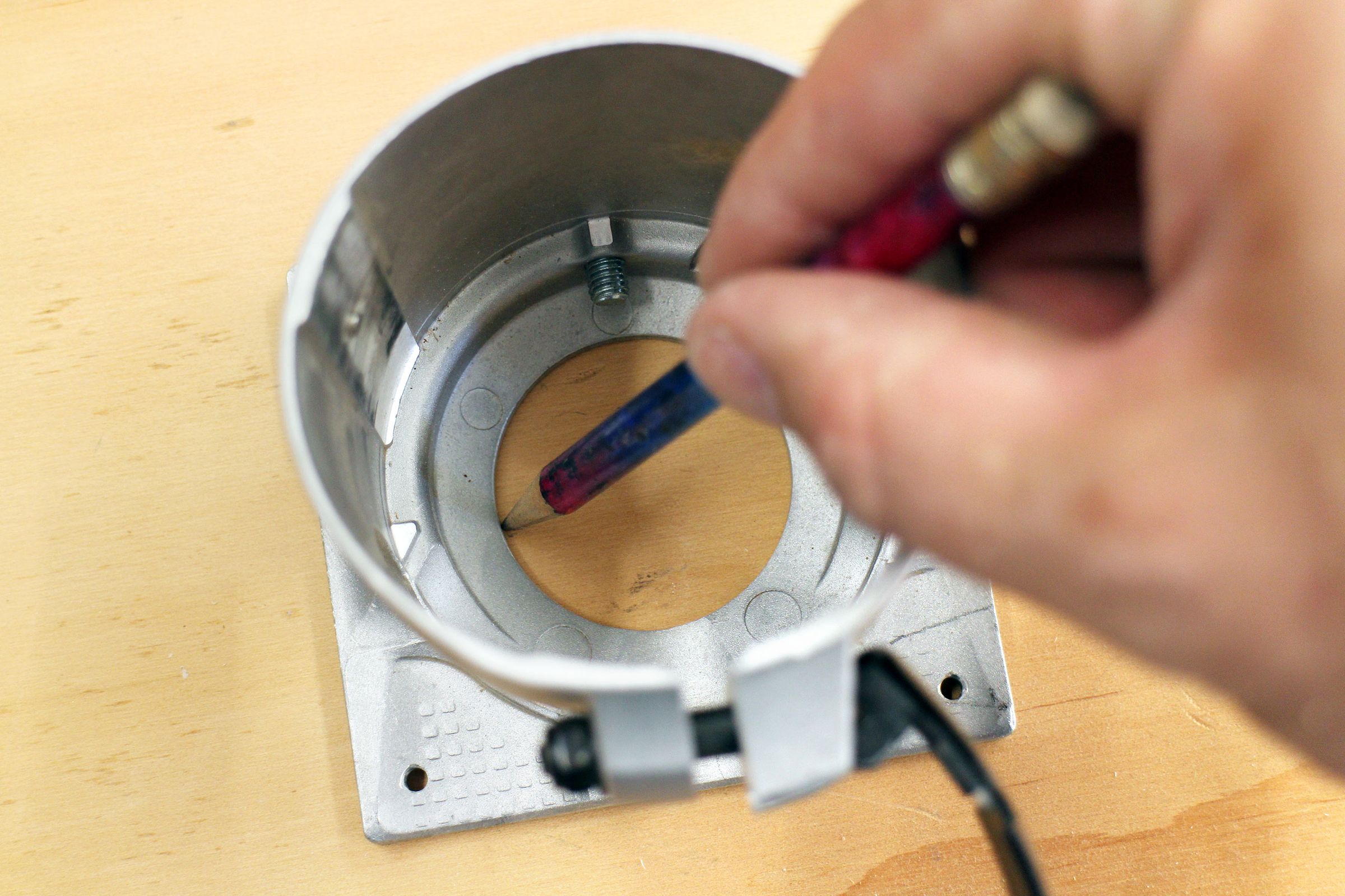

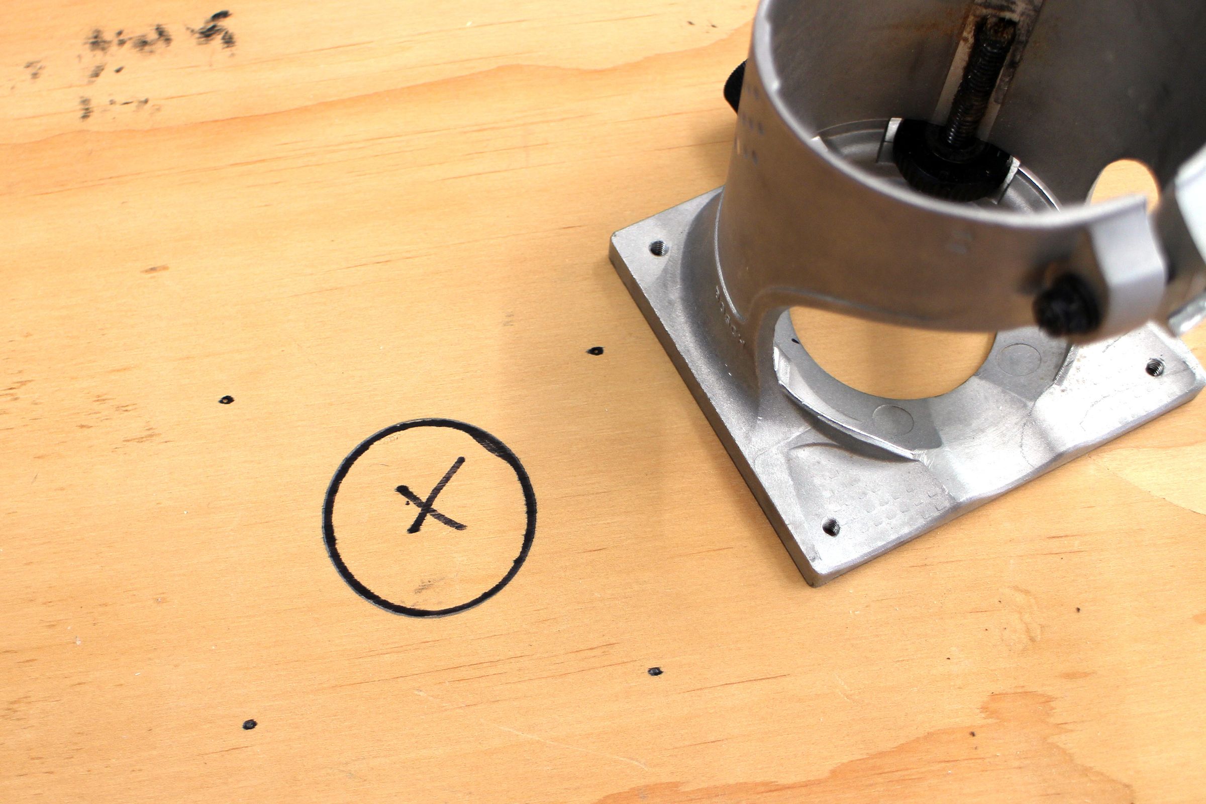

Remove the base of the router and place in the center of the plywood. Use a pencil to scribe the interior opening for the router, and the connection holes, onto the plywood. For clarity, I went over the markings again in marker to make them visible.

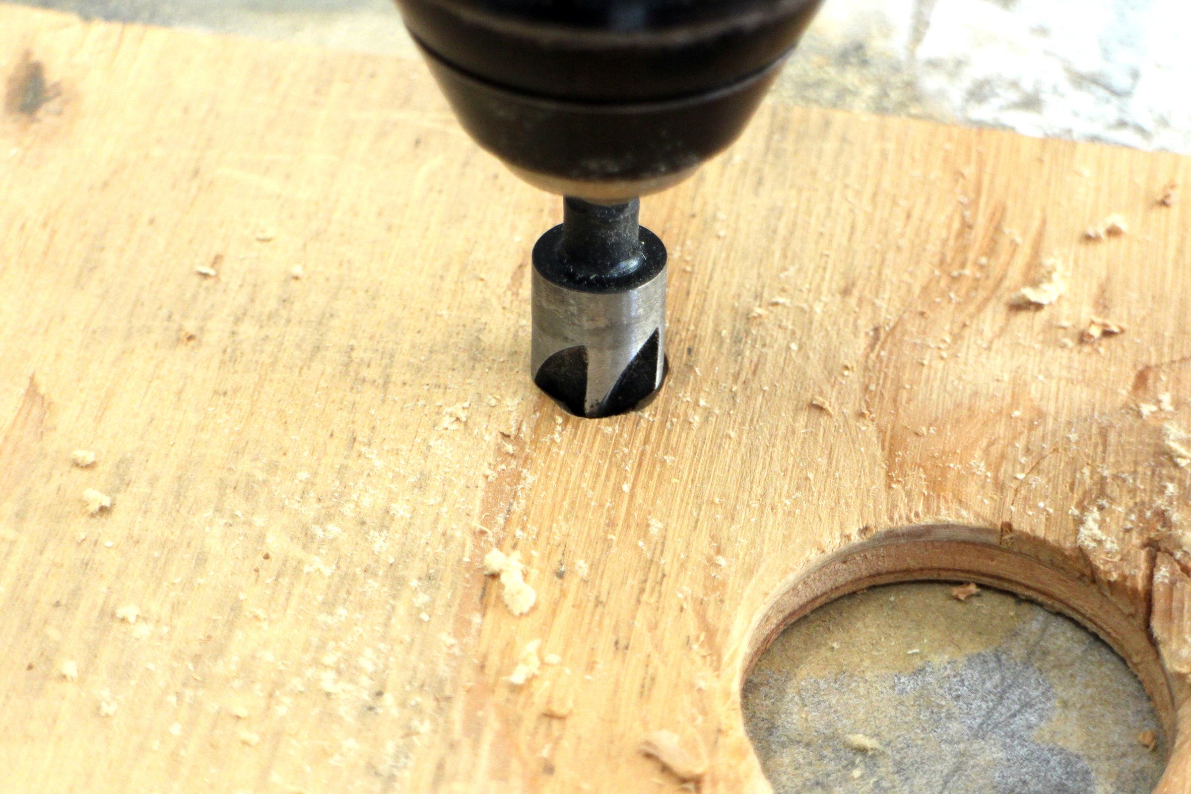

Use an appropriately sized hole saw to remove the router opening and then drill openings for the mounting hardware, countersinking them on one side.
The openings should match the existing base plate removed earlier.
