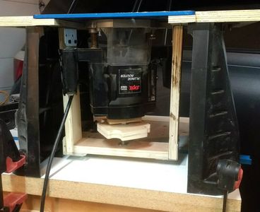

The concept is simple:
- There's a U-shape frame built around the router from scrap 3/4" plywood
- In the center of the bottom of the U, a carriage bolt in bolted into a T-nut
- The round head of the carriage bolt nestles in the opening of another T-nut that is fixed upside-down to the router itself
- Turning the bolt raises or lowers the router
And as you will see, the execution was just as simple - the whole project took me less than 3 hours and that included the trip to HD.
What I bought:
- 2 3/8" T-nuts
- 1 3/8" 4" carriage bolt
- 3/8" nut
I did buy 4 brackets but in hindsight, could easily have gone with pocket hole screws and glue, which would have been cheaper and probably stronger.
The 3/4" ply was scrap I had lying around and the Jenga block I 'borrowed' from my daughter's games.
Step 2: The Frame
The frame was built with 3/4" ply ripped to 2" width. Overall dimensions were specific to my router but as you can see from the pictures, none of this has to be super accurate.
The only place you have to be accurate is when aligning the 2 T-nuts (more on that shortly).
Step 3: Router Attachment
The 2nd T-nut is hammered into a Jenga block, which is stuck to the top (bottom?) of the router with double-sided tape. With this solution, there was no concern with blocking the air vents either.
Step 4: The Knob
I made the knob from 3"x3" 3/4" ply and attached the carriage bolt to it.
Step 5: The End Product
And that's all there is to it:
- The frame's attached to the underside of the router table
- The carriage bolt with the knob/handle gets bolted into the T-nut in the frame
- The head of the carriage bolt is centered in the T-nut fixed to the Jenga block stuck to the router
