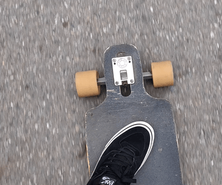

When I first started riding to work regularly I found that my board would get quite dirty, especially since I work in San Francisco (those of you who live or work here know what I mean). In order to make sure that I properly maintained my longboard I started researching online for methods and best practices. This instructable is a culmination of my findings.
Typically I will clean my bearings once every four to six weeks, depending upon usage. I have definitely noticed a difference in speed and smoothness of my ride when the bearings are clean (I liken it to the feeling you notice when you just had your oil changed in your vehicle). Either way, a routine cleaning will help to maintain the longevity of your skateboard or longboard and allow it to perform at its best.
