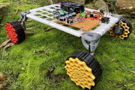

And I came up with the Roverling. I’m attempting to make a wheeled platform, mainly from these bits, that can be used in a multitasking environment and for further development. I’m designing and making it on the fly so I don’t have an overall picture or plan.
The basic design consists of 4 independently driven wheels using stepper motors. The plan is to use differential drive to maneuver and steer (untested). I would use servos for steering, except I’m trying to use just what’s available as much as possible. I intend to develop some micropython modules that will allow easy control via an RC remote. I’ll probably stick a bunch of sensors on board too.

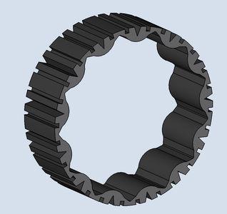

Step 8: Tyres
This is (was) my first attempt ever at printing with FLEX. Same as designing a tyre.
Using Bilby 1.75mm black FLEX.
Originally I used the ‘SemiFlex’ profile, however my first one took 17 hours to print at a volumetric rate of 1.35 m/s/s with a 25% fill.
I now use ‘SemiFlex’ and ‘0.3mm draft’ settings on my Prusa with only the followings mods:
  1. Bottom solid layers: 5
  2. Top Solid layers: 7 (because of internal invisible bridge)
  3. Perimeters: 3
  4. Fill: 0%. Note the hollow cross section in the simulation pic - important
  5. Max volumetric speed: 2.7 mm^3/sec - This is the critical parameter, speed will take care of itself.
Just press tyres onto wheels, I use CA to secure them.

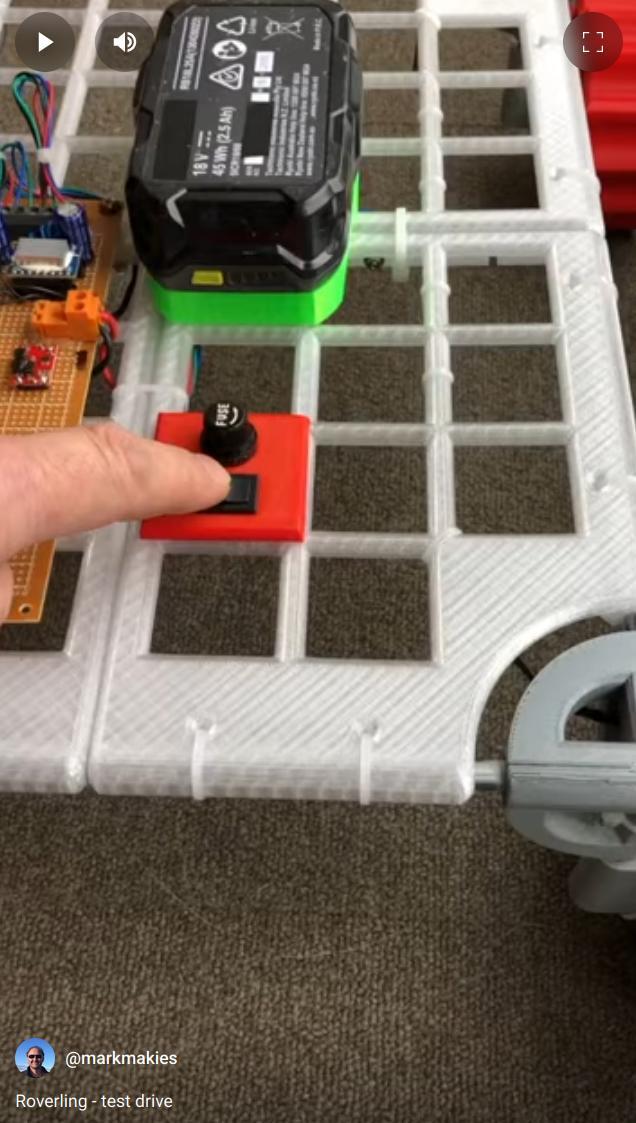

Switch and fuse holder is press fit and/or glued to the platform.
Wire up the battery, switch, fuse and power cables to PCB. Use fat wires. Then test for correct voltage / polarity. Also wire up the LED switch (if there is one).
Then use heat shrink and a lot of hot glue to ensure all exposed wires are fully insulated.
DANGER: ensure battery is disconnected whilst performing these steps. You really really don't want to short out a LiPo power source!

Install and connect up RC receiver. I have used an old 6 channel RC receiver for testing and future learning functions.
I’ve used hot glue on the screw connectors and MCU so that disconnecting / reconnecting during testing won’t dislodge / break anything.

Step 16: Flash and Test
Flash your RP2040 MCU with Micropython
Load up the code StepperTest.py to /pyboard/main.py
Plug in battery, power up
And it should start moving, like so….
https://youtube.com/shorts/3ybkzSui_iU

Step 20: Conclusions
The challenge I set for myself was to make something out of the old 3D printer, rather than fully design, simulate and fabricate a proper robotics platform - to that end I have succeeded. However, there are numerous problems I will need to address before getting onto the next steps:
  1. Power to weight ratio is not good however, properly specced steppers & drivers would go a long way to addressing this.
  2. Without wheel feedback or shaft encoders, steppers are probably not the best choice. I’ve got a couple of 25 year old Maxon DC motors with gearing and encoders which I may try.
  3. Way too heavy. Next I would get rid of the steel and use aluminum instead, if really needed.
  4. I was overconfident that differential steering would work. I’ll need to rethink steering as it is very ineffective.
  5. The tyres didn’t work as expected. Great on a smooth floor, but I need it to go up and down my steep 200m unsealed drive. Next I’ll go for thinner perimeters and greatly increase the section height.
  6. I should probably use a metal hub adapter, as hot motor shafts affect the very tight fitting PLA wheel.
