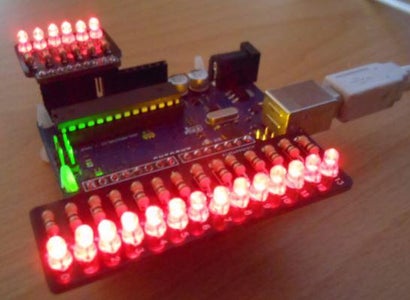

Introduction: Row 20 Leds
This is a very practical board that I always use, it has different purposes for example: Fast board to test our codes, board output checker and led sequence maker. The board is compatible with Arduino (any arduino board), but you can use it with a breadboard and in this way also able to work with the microcontroller that you prefer or you are familiar with. We are going to build it from scratch to the pcb. From idea to desing.

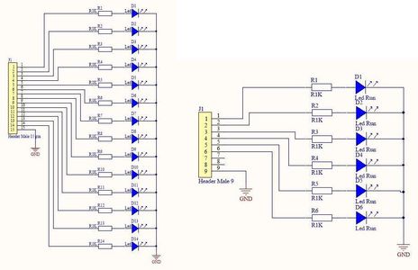

Step 2: ​SCHEMATIC DIAGRAM
The schematic diagram is very simple and flexible. For example in the case of the resistors you can use values from 220 Ohms until 10k Ohms, if you are planning to make a video with the board, I recommend you to use 10k Ohms value so the led will not shine a lot. In the oposive situation if you want the diode led shines a lot, so use the low value 220 Ohms. In the case of the diode led 3mm, you can choose different colors (red, blue, yellow, orange or other), the point is that the dimension has to be 3mm, there is no space for diode led 5mm. the pcb is very compact.Also We have the pin headers, the original desing is with male pin header so the pcb will a shield for Arduino or Breadboard, but the option to use cables or female pin header is also welcome and will work efficiently.

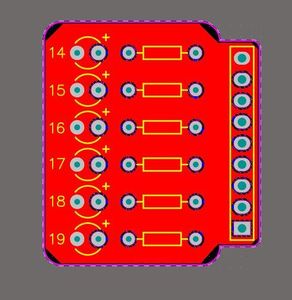

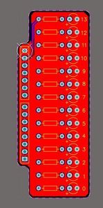

Step 3: ​PCB LAYOUT
Before We continue with the PCB layout, it is important to indicate that You can use any software for PCB Desing, believe me there are many options, even if you use the best software it will not mean that you are the best pcb desinger, so in this case We are going to use The Altium Designer highly recommended if you want to enter in the pcb desing world like a professional. So after We finished and check our schematic circuit We need to switch from schematic to PCB layout. We can see the PCB with the Ground Plane, this helps for noise filter on the pcb.
Here after we finish the pcb layout We can get the Gerber files, there are two kind of gerber files we have to pay attention to it, the first GerberX2 and the other Gerber RS274X, most of the manufacturer use the second one Gerber RS274X, in some software we can get both GerberX2 and Gerber (In the case of Altium Designer).

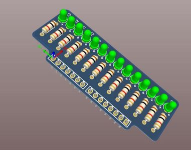

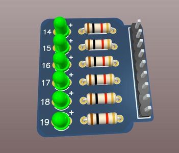

Step 4: ​3D MODEL
One of the features of Altium Designer is the 3D visualization, the 3d visualization is important and it give us the posibility to see and check our PCB and how it would be in real, also it can show us the components distribution and dimensions. Before I did not consider this feature so important at all, but the 3d visualization can show us if our footprint dimensions are ok, if all the components will be places without touching each other by mistake, it does not matter if your components are SMT or PTH (small or big), it is always better to see that every component will fit correctly. ► Also very important to remember, if you are going to add 3d models, be carefull that you add in the Step AP214 format, the others extensions and formats can not work correctly.

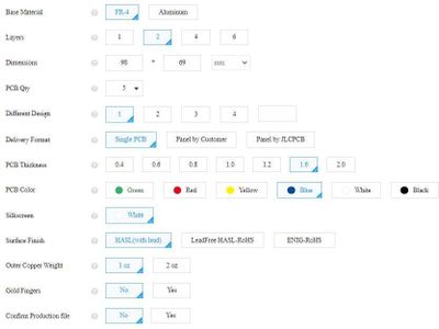

Indicate the features
After the upload of our gerber files, We need to indicate the features of the board, in the next picture you can see the options available.

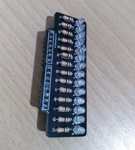

Receive your PCB
Days later, 7 days or few more, according to your location and custom broker process, You will receive your pcb prototypes.

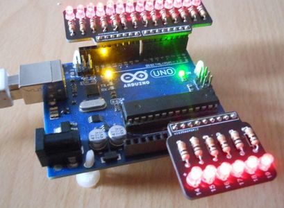

Step 7: TESTING THE BOARD
Now our Digital Output shield board is ready, and we can test it as well. So in order to do that first we need to mount in our Arduino board or breadboard.
Let's make the test with an Arduino Uno board, because it is the most used board and I am almost sure that you must have this board too. Now just we need to upload a sketch. Attached you will find and example, and other examples.
