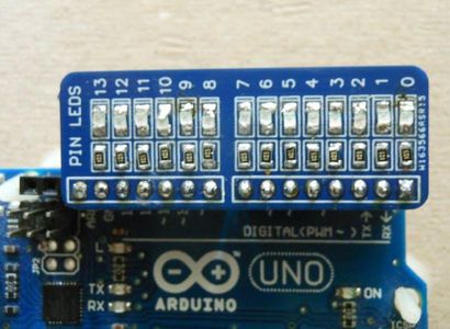

Introduction: Row 20 Leds SMD

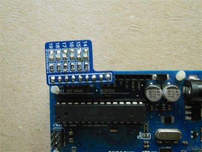

This Led Row, consist in two parts the first of 14 leds and the second consist in 6 leds (both 3mm led). They are shields for Arduino Uno.

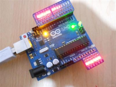

This is a very practical board that I always use, it has different purposes for example: Fast board to test our codes, board output checker and led sequence maker. The board is compatible with Arduino (any arduino board), but you can use it with a breadboard and in this way also able to work with the microcontroller that you prefer or you are familiar with. We are going to build it from scratch to the pcb. From idea to desing.

  • In total 20 digital outpus, which means 20 diodes led, ready to use.
  • Common components, very easy to find in our local electronic store.
  • Contains a row of male header for the practical conection.
  • Compatible with all Arduino board (The same pinout)
  • Possible to use in a breadboard and work with other microcontrollers.
  • Save a lot of time for making the conections the board is ready.
  • Very practical to see the function of your codes.

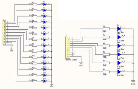

Step 2: SCHEMATIC DIAGRAM
The schematic diagram is very simple and flexible. For example in the case of the resistors you can use values from 220 Ohms until 10k Ohms, if you are planning to make a video with the board, I recommend you to use 10k Ohms value so the led will not shine a lot. In the oposive situation if you want the diode led shines a lot, so use the low value 220 Ohms.
In the case of the diode led 3mm, you can choose different colors (red, blue, yellow, orange or other), the point is that the dimension has to be 3mm, there is no space for diode led 5mm. the pcb is very compact.Also We have the pin headers, the original desing is with male pin header so the pcb will a shield for Arduino or Breadboard, but the option to use cables or female pin header is also welcome and will work efficiently.

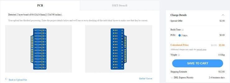

How to Order our PCB in JLCPCB ?Once We are register, and We logged in our account, We are ready to submit an order and receive our board in a very short time. In this case We need to update first the gerber files, which contains all the necesary information to build the pcb, You can get the gerber files in the link bellow.
Upload your gerber files
This is the first step, after we have ready our schematic and pcb layout, and after we generated the gerber files, We should upload this files to the JLCPCB website service.
Indicate the features
After the upload of our gerber files, We need to indicate the features of the board, in the next picture you can see the options available.
Add your shipping address
This part is very important, here you should write your currently address, where you would like to receive your pcb prototypes. It is not common but sometimes very rarely, you will need to pay extra feeds, but as I told you, it is very rarely.
Make the payment and finish the order
After you indicates this information, We continue with the payment section, These is the section where you can apply your coupons or discount codes. Basically We can complete the paymente by two general ways, Paypal or Credit card.
