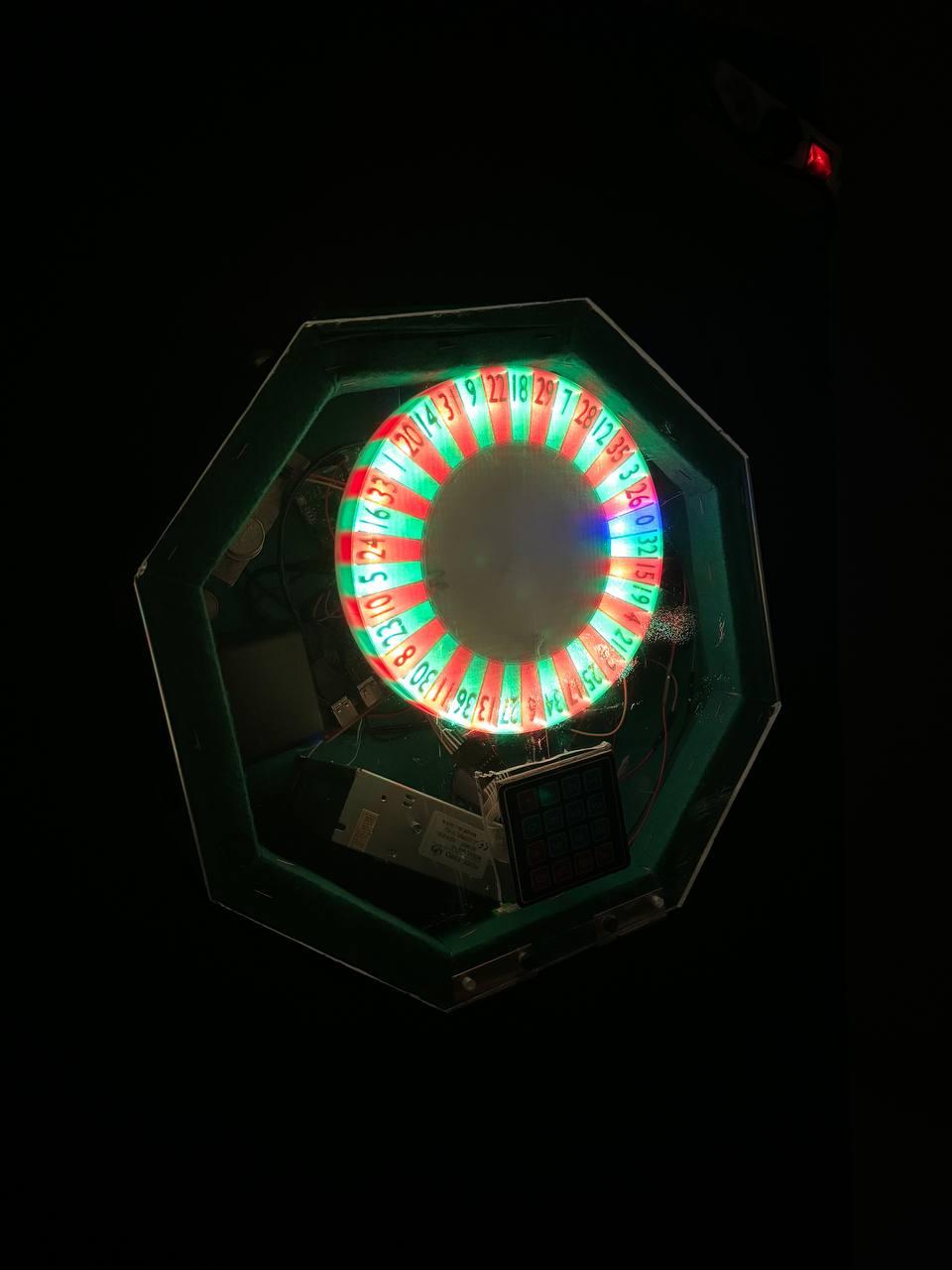

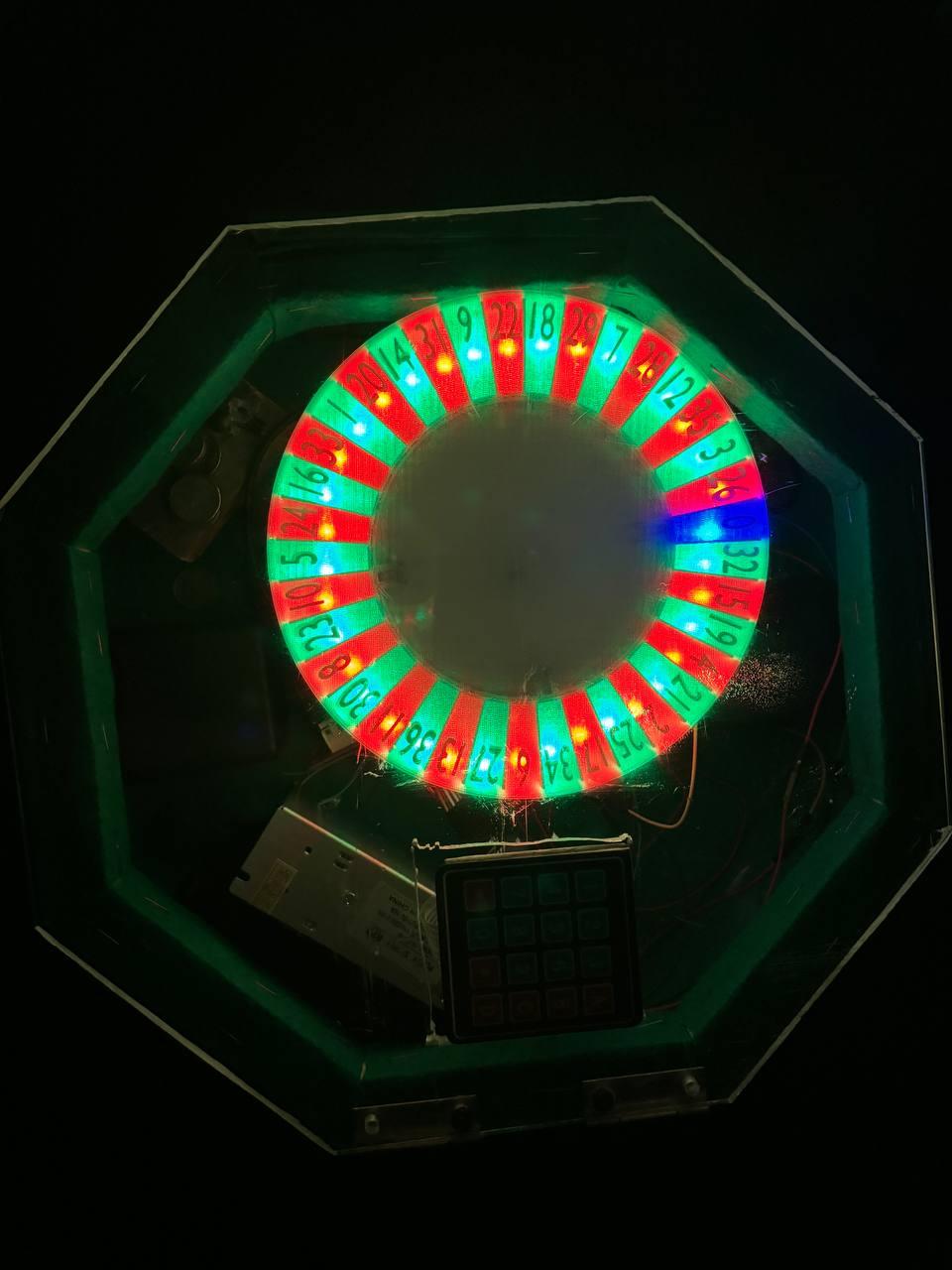

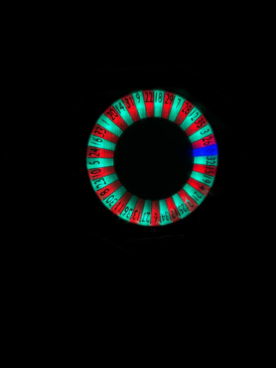

Nowadays, it is well-known that the roulettes in casinos are used to being tricked in order to make their owners to earn lots of money, so, our aim is to make a full digital (and non-tricked) roulette in which the ball is replaced by a white led passing through the led strip.
Last but not least, the whole project has been done with the purpose of being able to be easily detachable and reparable.

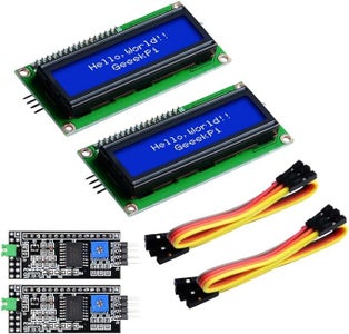

  • LCD screen (GeekPi).

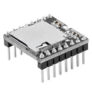

  • Mini MP3 Arduino-reader with micro SD card reader (BricoGeek).

Program performance. First of all, set up of all devices is done, after that the roulette will star working.It is posibble to single or multiple bet, introducing a "coin" into the slot. After selecting the number of bets, it is necessary to introduce a number of coins iqual to the number of bets we have selected. When proper coins have been introduced the led oscillation will become, and after that our bets will be checked. There are two possible behaviours, the winning one and the losing, it is easy visible by the animation the roulette does, and the music heard (the winning behaviours have an extra animation while the other is default). Finally all the parameters are reset and it is possible to keep playing. In our code, after playing for first time the roulette colours keep in the idle state, if you want them set to roulette default, just use the InicioRuleta() function.

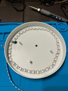

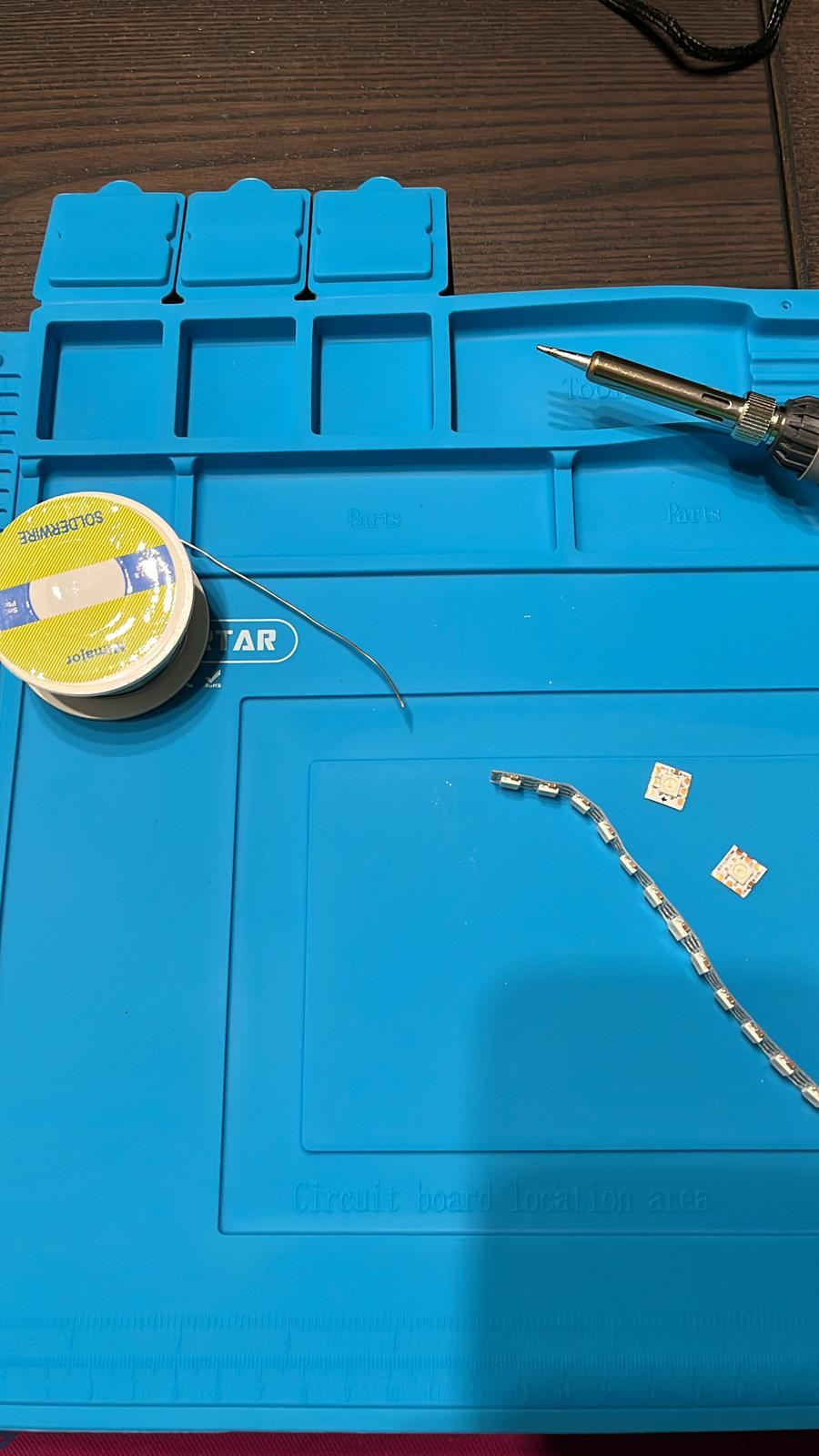

Cut the different NeoPixels. First of all, it is necessary to cut the Neopixels strip in order to have them separated.
Weld the wires. Once we have all the Neopixels separated from each other, they must be welded with the distance of the wire that is necessary for occupying the different holes of the 3D printing.It may be a difficult task since the holes are in a circle, so the upper wire must be longer than the lower one. Even in some cases, when the wire is longer, it should be fixed with the next one. As a trick, we recommend to put a little bit of tin in their pads and then put the wire helping yourself with the tweezers (if you see there is not enough tin, add a little bit more in order to make it as strong as possible).
Find out everything is going as it should. For making sure it works properly, it is recommended to try all the Neopixels every time a new one is welded.
All the NeoPixels are working properly. The final step is to assemble all the welded Neopixels in the 3D printing with their sticky part (even if it is necessary, silicone might be used) and make sure that each led is inside its own hole.

Devices. In order to the communication that each device makes, they must be connected to their respective pin. The speakers are connected to the Mini MP3 Arduino-reader with micro SD card reader and that device is connected to the Tx and Rx Arduino's pins. The Neopixels strip is connected to the Arduino too. The Matrix Keyboard is connected directly to 8 digital pins of the Arduino. Optionally, if it is possible to use a LCD screen it will be connected to the Arduino through I2C connection so, it must be connected to its own pins.
