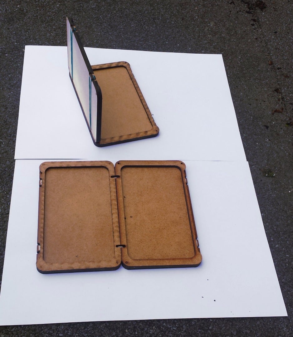

"Please notice the rubber-band-holes in the sides are cut out through the back of the box so that it will stay open and even half open, instead of the rubber bands just trying to close the box all the time. This is the part where I really felt like I had figured something out!"

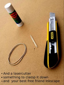

Tools and materials:
Tools:
Lazercutter
- Clamps (i used an old ironpot to keep with the design manifest)
- Knife
Materials:
- MDF/Acryl/Cardboard/Whatever you want
- Rubber Band (2)
- Glue (I used a gluestick, again, the design manifest)
- Toothpicks, round (4-8)
Software:
- Inkscape

- Now is the time to contemplate whether you glued the top and bottom halves together or not! If you did, remove whatever holds it down and give it a tap with a hammer at the end of the box to get the glue to let go.
- After 20 min. the glue is hardend enough.

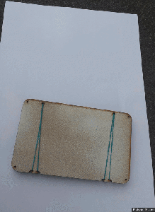

- Put the rubber bands through the holes and hook them on the Cleat (I learned a new word and so can you).
- When you have done so, with both rubber bands, on both sides, you should be finished.
- To lock the box, simply take the rubber band from one cleat and attach it on the other side of the front.
- WELL DONE YOU.
