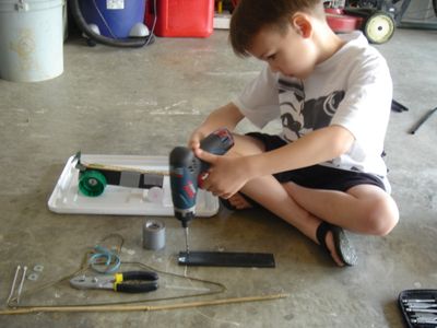

Step 2: Basic Design and Wheels
I had intended to put the larger "wheels" in the back but my son thought it would look better them in front. I also thought if I reversed the propeller it would work as a pusher. It turned out that the propeller was designed as a puller type and only worked efficiently when used that way.
A layout of materials to determine spacing is recommended to prevent re-working.
Safety first!!! Drill carefully, trying to keep the bit perpendicular to the surface being drilled. Be sure that the surface beneath your project is safe to drill on/ into.
Big Wheels:
Drill holes in the center of your large wheels, cut a straight piece of hanger for an axle,.
Insert in the car body, attach the large wheels, then washers and zip-ties cut to fit.
Smaller wheels, (push-pop pushers):
Drill the hole in the body slightly larger than the push rod.
Attach the small wheels to both end of the rod and center it in the car.
Now cut the straw to fit evenly on both sides of the small wheel axle to act as spacers to keep the wheels from sliding up against the car body.
