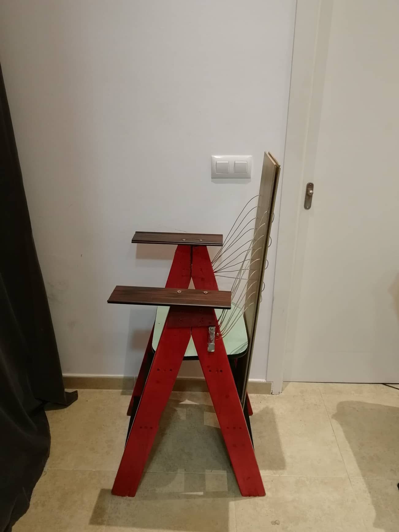

The ladder I found was not level so had to be taken apart and leveled.. sorry I don't have any pics of this, but you basically have to unscrew the 2 parts of the ladder, level the top, then secure the sides with blocks (circled in red), before putting the base on.

You don't want the seat to be too straight, it's good if it can recline a bit.. To do this without risking the back snapping I supported it with some cable.

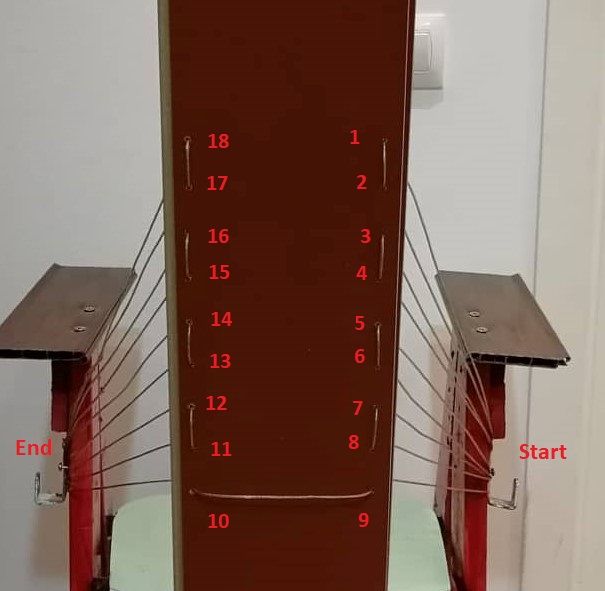

- Drill 9 holes in the back (for me 2cm in from the edge, 4cm spaced vertically worked) Before drilling I tested the design out with some string.
- Put the cable through one of the clamps in the sides of the chair then weave it in and out of the back in the order shown below

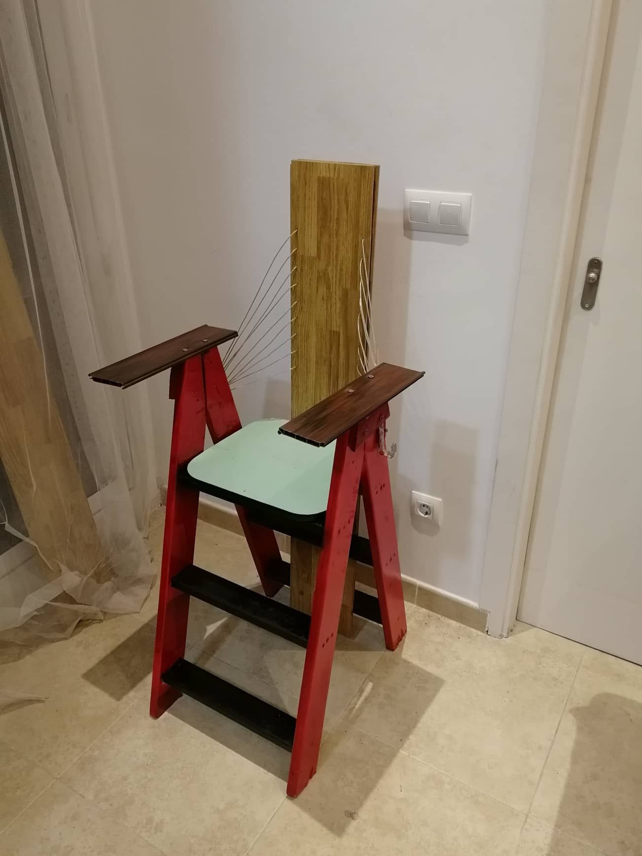

After the back is in place you can position the arms so they don't get in the way of the cables
- Screw them into the tops of the ladder.
- All that's left to do is to paint the steps and sides..
