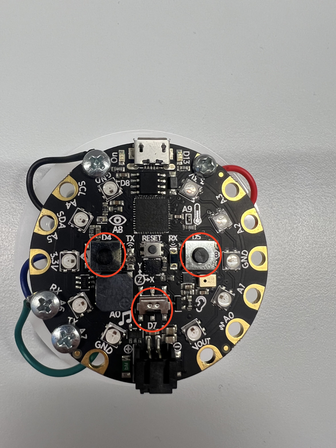

Operation Mode - the slide switch on the board chooses between two modes, normal operating mode and manual operating mode. In normal operating mode the board will activate his functions when light value measured on the board is larger than a certain value, defined for each room, while the manual operating mode allows the basic function manual using the board buttons.
Normal operating mode:
  1. Toilet paper dispenser - using the make.com interface and app, when a button on the app is pressed the board will activate a servo which will dispense toilet paper along with a short jingle.
  2. Toilet paper retrieve - when in need the user presses the left button on the board which will activate the servo to retrieve the dispensed toilet paper. There will be a moving LED multi color indicator on he board of this process.
  3. The board LEDs will display the temperature difference from a defined ideal temp. in celsius. If the temp. is higher than the ideal temp the LEDs will indicate the difference with red LEDs and if the temp is lower than the ideal temp. the LEDs will indicate the difference with blue LEDs. Green LEDs indicate we are at ideal room temp.
Manual operating mode:
  1. Normal operations are disabled, dispensing of toilet paper is done by pressing the right button on the board.
  2. LEDs will show purple light to indicate this mode is active.

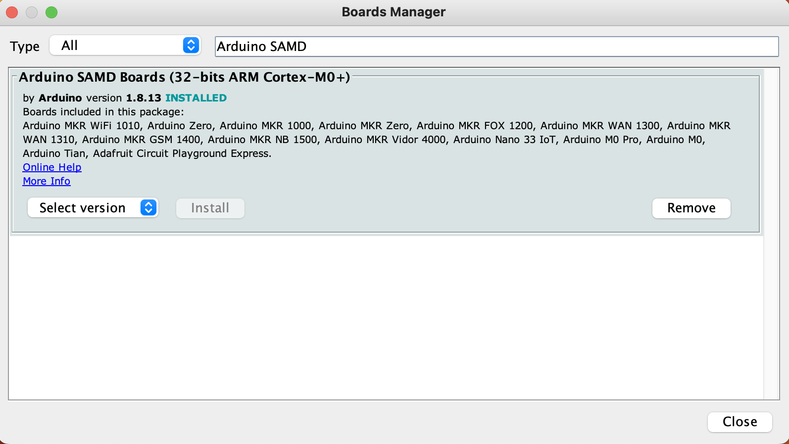

The process of downloading this is through the IDE itself, open the IDE on your computer.
Navigate to the tab "Tools" -> "Board" -> "Boards Manager"
In the window that opened type in the search bar "Arduino SAMD", once found click the install button.
Once the program finishes to install navigate again to "Tools" -> "Board" but now choose the board and so:
"Tools" -> "Board" -> "Arduino SAMD" -> "Adafruit Circuit Playground Express".

The next step is constructing the board and getting it ready to use, for this machine to work we need to combine the CPX with ESP8266 chip which enables the board to connect to the internet.
In order to connect the two boards we use the 4 metal wires, each has a specific place it must connect on each board. Notice that the names of the pins are clearly written on both boards.
Pin Connection
G (ESP8266) -> GND (CPX)
3v3 (ESP8266) -> 3.3V (CPX)
TX (ESP8266) -> TX (CPX, also labeled A7)
RX (ESP8266) -> RX (CPX, also labeled A6)

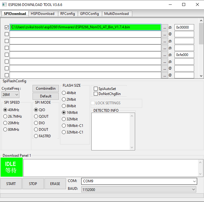

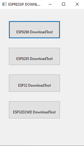

In the case where the settings of the ESP8266 board are not set correctly by default (all links lead to the manufacturer site):
  1. Download ESP8266 Flash Download Tool. Can be found in this link.
  2. Now you will need to download the latest firmware, *PLEASE NOTICE TO DOWNLOAD THE NONOS VERSION* - found here.
  3. Now open the flash download tool, connect the computer to the ESP8266 board directly via the USB to micro USB cable and now press the top option corresponding to the ESP8266 download tool.
  4. The final stage is to select the firmware from the folder, check the box next to it and start the start button.
NOTICE
*It is the only time in which we will connect directly to the ESP8266 board, all future connections will be done to the CPX*

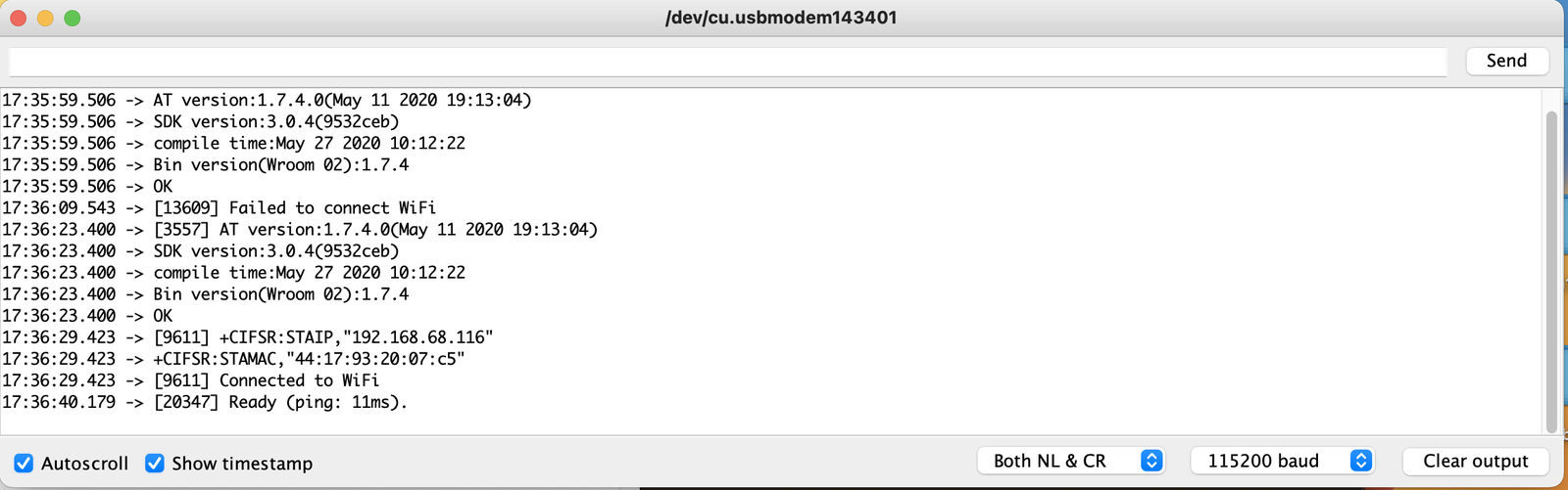

Testing
The following Arduino code will test the internet connection, it is from the examples library and the output will be displayed in the serial monitor found in the IDE under the "Tools" tab.
The only change to the code that needs to be done is inserting your network credentials into the code and then activate it after connecting the CPX to the computer. The output should be as such, notice the various success messages:

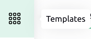

For the setup of the template use the computer as it is much easier than the app. Once in your account navigate to the "Templates" icon and enter that section.
We will create a new template, name it whatever you want for convenience, in the field of "Hardware" select Arduino and in the field of "Connection Type" select wifi. Enter the template you have created. You will see many optional tabs which you will need to go to the datastreams tab. Now we will create a few datastreams for the project, by pressing the edit button on the top right of the page:

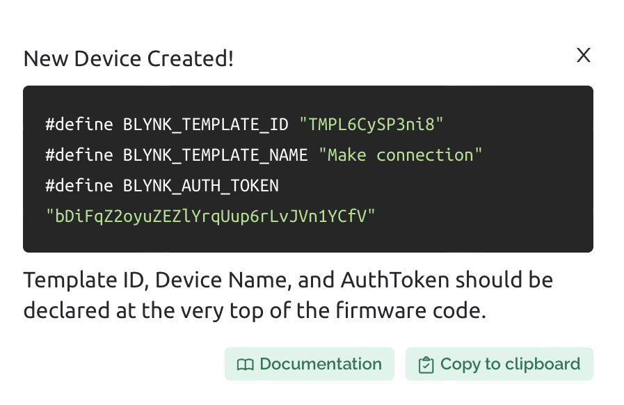

*In this part I will provide a simple Arduino code which will print out to the serial monitor both light level values and temp values for you to figure out the correct values in the datastreams, note that these can be changed at any point and also that light levels should be measured in the middle of the day to account for the outside light from windows while recording light levels when the light is turned on and off for future use*
This video at the beginning will show a quick creation of a datastream.
After the datastreams have been created we head over to the "Search" icon on the left (magnifying glass) and there we create a new device, in the pop up window choose from template and specify the template which you have created and give the device a name. The device will be created and show a window with the device information for later use, you can access that information at a later time or cop it to a handy place.

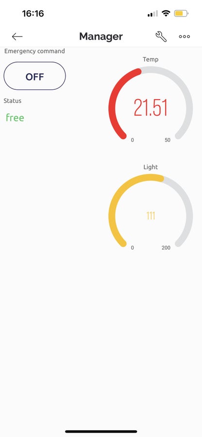

Now we will create the dashboard, head over to the app on your phone. Make sure you are logged into the same account, and select the device which you have created. Press the edit button (wrench icon) and start adding the following widgets by pressing the plus icon and connecting a datastream to each (after it is displayed press on it and a pop up window will appear to connect a datastream):
  1. Button - connect to "Emergency command(v1)", in settings select PUSH.
  2. Value Display - connect to "Status(v3)".
  3. Gauge - connect to "Temp(v2)".
  4. Gauge - connect to "Light(v4)".
You can setup the location and size of each widget by a long press on it.
Now exit to the main device page and that's it!

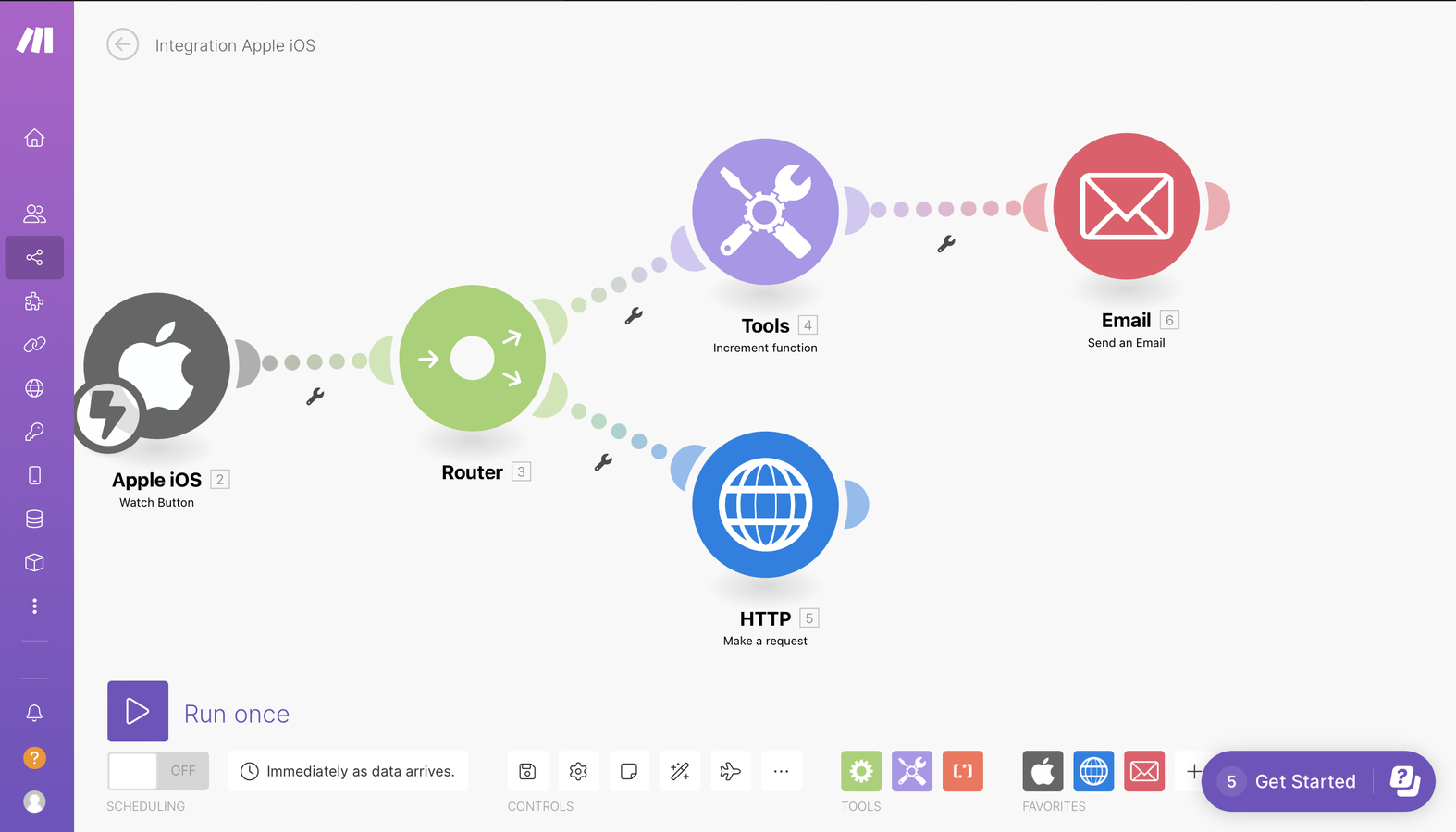

Navigate to the "scenarios" tab and create a anew scenario.

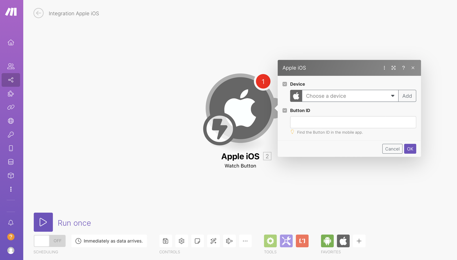

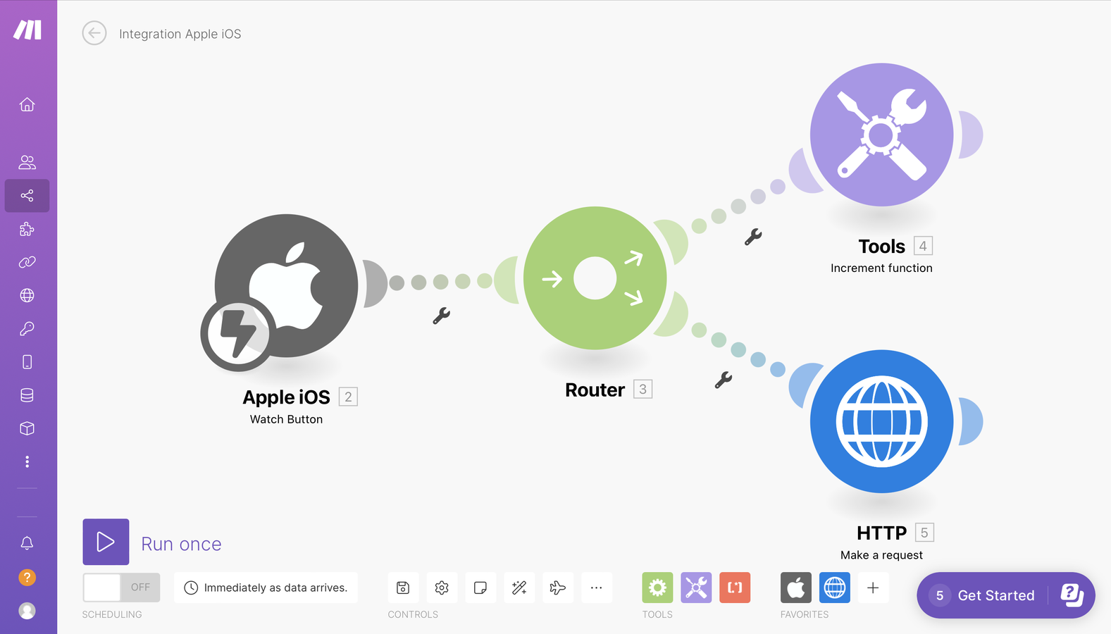

The first step is to set up your trigger module which is the first one displayed on the screen, once you press on the plus a list of applications will open up and a search field. The trigger in out case would be a button in the app and so we need to find the operating system of the phone, in my case IOS but Android has this same feature. Once found press the operating system app in the list and next choose the watch button option.
Now that the module is set, add your device name and also a button id of your choice.
Double clicking on the screen would create a new module, in the same way set a new module to be "Flow Control" -> "Router" and then two new modules would appear.
The top one we set to be "Tools" -> "Increment Function" and in the pop up window select rest value never.
The bottom module set to be "HTTP" -> "Make A Request". Now the interesting part which connects this to Blynk, we set the URL to the one which updates datastream values in Blynk. The following URL comes from the Blynk HTTPs REST API (link):
https://{server_address}/external/api/update?token={token}&{pin}={value}
Setting the correct values is important:

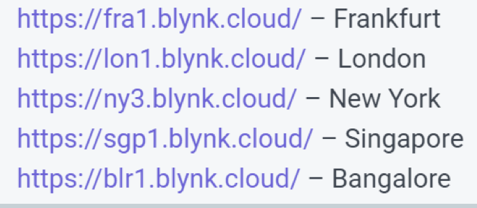

  1. {server_address} - depends on your location, you can see the following list of server:
  2. {token} - the token in the information page which we stated earlier.
  3. {pin} - pin you would like to update, in our case V0 (capital V).
  4. {value} - just write the word "roll".
example: https://sgp1.blynk.cloud/external/api/update?token=Dt6FIwrdhLXA5BAgjKNQ5jOyRKPXSlxZ&V0=roll
Back to the module, we paste the URL into the URL field and make sure the request is GET.
Next we create a module next to the Tools module and set it as an "email" -> "Send An Email" module. Follow the instructions on how to add an email address (*NOTICE* - personal gmail accounts do not work, Microsoft accounts work ok). Fill in the to, subject, and content fields with the message you would like to get when you run out of toilet paper.
The last step is to set up the filter, on the connecting dotted line between the "Tools" module and "Email" there is a wrench icon which sets up a filter, set up a filter which receives the increment value from "Tools" and does mod operation on it with the value of how many sheets of toilet paper the roll has divided by the amount of sheets in each operation (in my case 31). This would be numeric equal to 0. This step is a little bit tricky so the video at the beginning shows how to do it.
Finally save the following scenario, and activate by switching the button on the left bottom corner from OFF to ON.

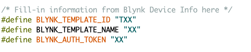

  1. In the top of the page the Blynk device information (the one we said to keep handy) needs to be pasted into the code with your information.

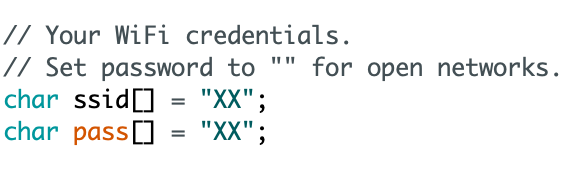

  2. In the section of the wifi credentials fill in the wifi name and password, case sensitive.

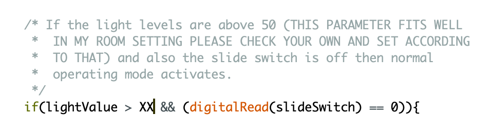

  3. The light value threshold which decides if the light is on in the room or not must be between the light measurements done in step 3, fill in a value between those values with a little bit of spare on each side.

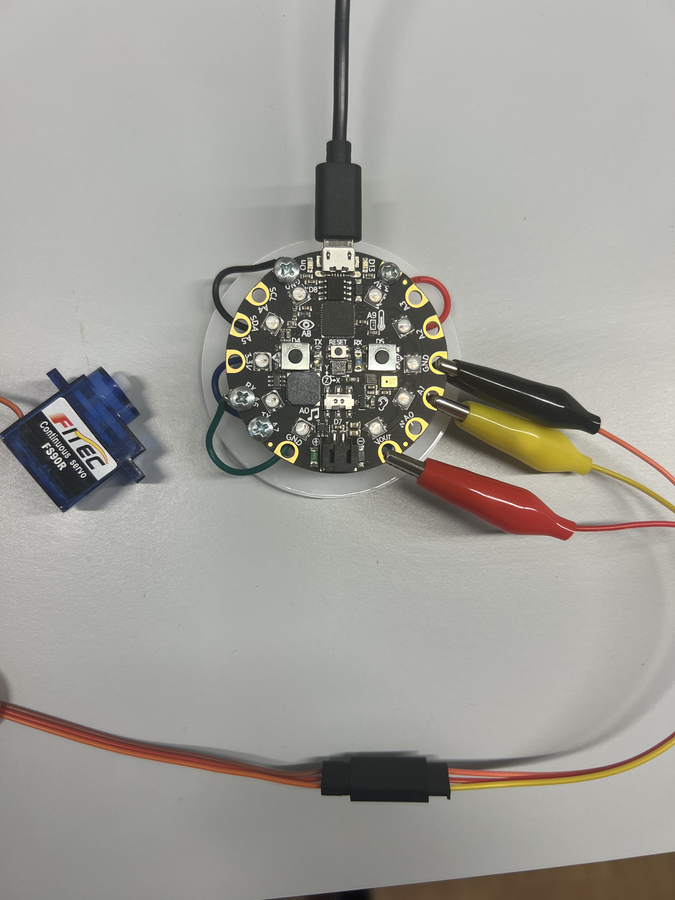

Now comes the stage where we connect all the parts together, first connect the servo connection cable to the servo. The color of the wires coming out of the servo does matter and so we would get back to that in a bit.
We position the board in a clear space on the wall using double sided tape such that the alligator clips would reach the board. Make sure the left button (labeled D4) is on the left side, another indication is the battery package connection would be facing down.
Position the battery package on the all below the board using double sided tape for easy use.
The final connection is the alligator clips, the wires coming out of the servo have the colors brown, red, and orange. The cables on the servo to alligator clips might have different color but just make sure that the wire corresponding to the colors from the servo are connected as such:
  1. brown - GND.
  2. red - 3.3V.
  3. orange - A1.
The machine is ready for use.
