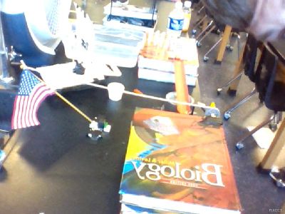

Step 10: Pivot Arm Knocks Marble Into Cup
The swing arm knocks the marble into a cup, which is attached to the flag. The marble is held by a lego piece.
Step 11: Cup Pulley Raises Flag
The weight of the marble pulls the pulley down, which is attached to the flag. As the pulley moves down, it pulls the flag up. The pulley is made of a condiment cup, yarn, and a pulley wheel, which was a k'nex piece. The flag is attached to a lego and k'nex base.
