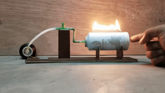

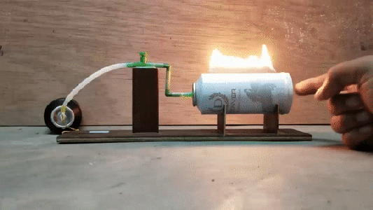

So, here we will be first making our Metal pipe. For the pipe you can use any kind of metal pipe of any thermal proof material. In my case I will instead use a empty Deodorant can for the same.
Now we need to make some holes along the top for our flames to lit. Here I marked 14 holes of 0.5mm diameter spaced evenly along 1/4 inch distance each.
For making I used my drawing compass to punch the holes and then I hammered the holes with 0.5mm Nail Pins. Thus it makes very tiny and perfect straight holes for my can.
Later,
I simply cut the bottom of the can with the help of my mini hacksaw. So, that later on we can fit our Diaphragm on this end. Then I removed the spraying pipe attached to it from the top and leave the hole as it is, so that we can use this end as our Gas Inlet system.

So, now is the time for fitting the Diaphragm to the opening end of our can. In this case I used a Balloon as an elastic membrane, which will produce a vibration inside the can and hence we will notice sudden changes in our flame.
As shown in the pictures cut the balloon and bind it tightly to the end with extra thread protection so that no air leakage can occur.
Note: Remember to choose a material so that it can be heat resistive, as when the flames will lit the metal pipe gets heated & so membrane should not break away.

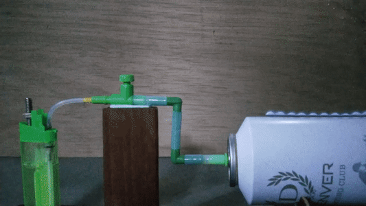

Step 5: Gas Inlet Pipe System
Here is the time for making the Gas input system. You can use any gas like propane tank, butane tank or any other flammable gas.
I made the Gas intake system with the help of 6mm aquarium pipes and plastic joints. I also used 2 L-joints, 2 I-joints and a pressure regulator valve for controlling the gas flow.
I used a I-joint and some Teflon tape and then I inserted in the opening of our Deodorant can, it easily fits in there. Use some super glue to permanently fix the joint so that no movement can happen and no gas leaks.
As shown in the pictures I cut 3 pieces of 6mm pipe and joined all the L-joints to the regulator end. Then I used another 2mm pipe with a I-joint and attached to the other end of the regulator. This pipe will be connected to the Lighter head.
Step 6: The Lighter Mechanism
A Lighter is a cheap and easily available tool that contains flammable gases and is suitable for our demonstration. I already mentioned using a butane or propane tank is much recommended.
This step is really simple I only used a small nut and bolt to fix the gas flow lever.
First I disassembled the Lighter and take out other non necessary parts. Then I fitted the nut through a piece of hard plastic and then super glued the assembly to the Lighter. And hence, when we lower our bolt it will push and hold our trigger lever so that a continuous gas flow may occur.
Now, install the 2mm pipe to the Lighter nozzle and connect to the regulator.

The base is made with Plywood of thickness 2mm and 6mm. I had a few scrap pieces of ply, though I used them to get a durable stand for my experiment.
Or, you can simply use pieces of cardboard to make the same. It will be much easier and cost effective too.
Here, I used a long piece of 6mm ply as the bottom plate. Then I took another two vertical pieces of 2mm ply and cut them in quarter circle in top, so that our metal pipe can easily rest in there. Also I used a 6mm stand for the pressure valve to sit on.
I used regular wood glue (fevicol) to fix them all and lastly, I coated the base with Varnish.
Step 8: Assemble
All our major parts are completed, now lets put them together in the base. For this I used double sided tape to fix the regulator, lighter and the can to the stand.
So, our mechanism is completed and we are ready to begin our experiment now.

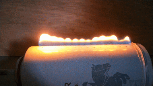

Step 9: Experiment
Now I released the gas form the Lighter and lit the can, what I see is the flow of flame are too small due to a low pressure. Suddenly I noticed that gas was leaking from the nozzle of the lighter and at this flow we can not run our experiment.
So, I need to replace the lighter and use another source of gas. I knew a filled deodorant can contains alcochol as an ingredient, hence it is also flammable and that time I had the only choice available in my home.
Therefore I made a hole in my Deo can and connected to the regulator and now there is no gas leakage and the flames are higher than before. And I can now easily control the gas flow by turning the valve regulator. Also suddenly I got fire in my regulator too as it was fully open and gas leaked through the hole.
Therefore,
Now if you place a frequency generator or a speaker near the Diaphragm, you can see a change in pattern to the flame with the change in frequency. At the pressure nodes, the flames are higher and vice-versa.
Also if you tap the Diaphragm with your finger you will be able to see the same change instantly. Hence it is confirmed that the standing wave will create points with oscillating (higher and lower) pressure and points with constant pressure (pressure nodes) along the tube. Thus we will see the formation of nodes and anti-nodes among the flame.

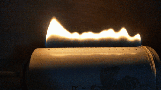

Step 10: The Result
The result is in front of you now. At the pressure nodes, the flames are higher. At the end of the tube gas molecule velocity is zero and oscillating pressure is maximal, thus low flames are observed. It is possible to determine the wavelength from the flame minimum and maximum by simply measuring with a ruler.
