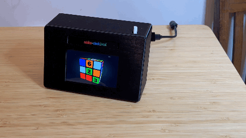

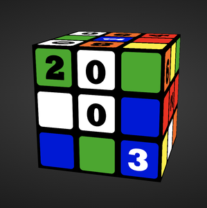

My friend and I built this really cool clock. We thought it would be awesome to share it with you. These are instructions on how to build a clock that shows the time of day on the face of a Rubik's Cube.

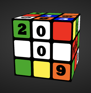

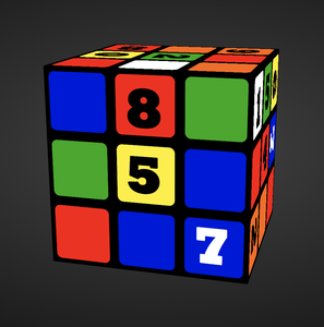

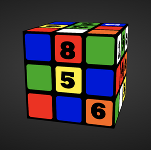

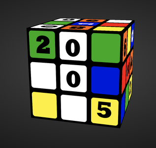

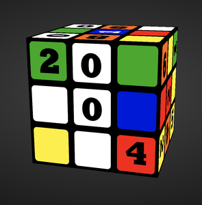

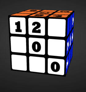

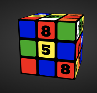

Every minute all day long the cube executes a few simple twists. At the end of each twist sequence, a new 3- or 4-digit number appears on the front of the clock displaying the current time of day. We call it the Rubik's Clock!
Our clock can be configured to show a 12-hour (am/pm) clock or a 24-hour clock.
It is very simple to use. Just set it on your desk, plug it in, and sit back to watch time slide by!

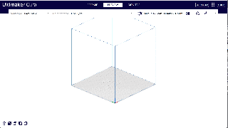

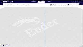

  2. print the case on your 3D printer

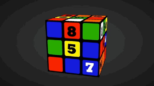

It is also a Web Server
Even better, this clock is a web server. When the clock is running, you and your friends can open up your smartphones, go to http://rubiks-clock.local (or maybe http://rubiks-clock), and have a clock in your pocket.

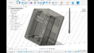

The Case is Unique Too

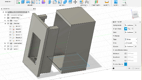

The case itself is also rather unique (if in fact all you need is a nice case for your own cool project). I found a few examples of printable cases on Thingiverse that are designed for the Muizy 4-inch display. They look great, but not quite what I was looking for. I wanted a clock-like cube thing that sits nicely on my desk. Nothing like that could be found, so I went ahead and designed my own. I kind of like the final result. It is rather rugged, easy to assemble, and sits pretty in any room of our house.
I've attached the Fusion 360 file in the section that explains the case design. Feel free to customize however you like. If you do, let me know: I'd love to hear what you make!

  14. Print the case (Technically this should be the first step since it take a long time to 3d print)

Perfect for my "kiosk" project, I found this little display on Amazon. I was a little nervous about installation because it takes effort to install. (Minimal effort actually.) But the steps are simple and everything went well for me. I am very happy about the choice.
The Miuzei 4-inch display requires a special driver to run on a Raspberry Pi. I suggest doing these steps only after:
  1. Make sure VNC works properly
  2. Make sure SSH works properly
I recommend doing the following steps before mounting the 4-inch display onto the Raspberry Pi. Do these steps from any one of the following interfaces:
  • Keyboard, mouse, and standard HDMI monitor.
  • VNC connection
  • SSH login
There are several choices you can pick from on the Miuzei website. Choose any that you like. I did the following:
cd /home/pi/Downloads
rm -rf LCD-show
git clone https://github.com/goodtft/LCD-show.git
chmod -R 755 LCD-show
cd LCD-show/
sudo ./MPI4008-show
The Raspberry Pi will automatically reboot. Also, assuming you did this step while connected to a normal monitor, everything will now be rotated 90 degrees. That's ok. Now just shut down the Raspberry Pi (or simply remove power).
When you are done with the above:
  1. Shutdown your Raspberry Pi 4b
  2. Remove the power supply connector.
  3. Remove the original monitor HDMI cable.
  4. Add all heat sinks that came with the display. They stick onto various chips on the Raspberry Pi.
  5. Peel off the red plastic that protects the sticky tape on the connector and attach the fan that came with the display.
  6. From the fan, connect the black wire to the "-" terminal and the red wire to the "+" terminal on the display.
  7. Connect the 4-inch display
  8. Connect the 180 degree HDMI connector from the display to the Raspberry Pi.
  9. Plug in the USB-C to power.
  10. Turn on your Raspberry Pi.
  11. For me, the screen did not work first time I powered on the display. It was mostly black but flickered a bunch. Some people say it comes up all blue the first time. So I toggled power again and everything works great now.
  12. switch off power (yet again)
  13. switch on power
  14. Now All is good. The screen is in landscape and up is in the direction of the HDMI and power connectors.
There is a button on upper-right edge of the touch-screen if you want to dim the display.
Pretty nice, actually!

Step 6: Web Page Clock Options
Interesting URLs
By default, if you simply view the file index.html from you browser, you will get a medium size cube that shows the time on a 21-hour clock. But there are plenty of options if you want a different clock (or different cube altogether). Here is a short list of interesting URLs you might like:
  • 12-hour medium size clock (default)
  • file:///home/pi/rubiks-clock/index.html
  • http://rubiks-clock.local
  • file:///home/pi/rubiks-clock/index.html#clock12
  • http://rubiks-clock.local#clock12
  • 24-hour medium size clock
  • file:///home/pi/rubiks-clock/index.html#clock24
  • http://rubiks-clock.local#clock24
  • 12-hour giant clock that fills the screen (default value for the clock on the desk)
  • file:///home/pi/rubiks-clock/index.html#giantclock12
  • http://rubiks-clock.local#giantclock12
  • 24-hour giant size clock (kiosk 24-hour clock)
  • file:///home/pi/rubiks-clock/index.html#giantclock24
  • http://rubiks-clock.local#giantclock24
Note: the above URLs assume that you domain name is .local . Some home routers don't set a domain name so maybe for you house it is http://rubiks-clock instead of http://rubiks-clock.local. If you are at a business, the domain might be something totally different. Like perhaps http://rubiks-clock.internal.mybusiness.com. Poke around, hopefully you will find what works for you.
#something runs presetSomething()
For a full list, search the file cubes.js for any function that begins with the word preset. Everything after the word would be the same word after # in the URL. For instance presetClock12() is run when index.html#clock12 is typed into the browser.

Notice that media/clock12/front.png has the numbers 1200 on the front.

Step 9: Case Fusion 360
There are a few things interesting about this case design:
  • The front and back faces tilt at a 20 degree angle. Because of this, I used loft instead of extrude to produce horizontal faces.
  • I built numerous offset planes to help place new sketches
  • I (minimally) modelled the Raspberry Pi 4b and the 4-inch screen as separate components. This helps with placement of holes and other features.
  • I used joints in various places to make sure components are properly aligned.
The five components are:
  1. The case Front
  2. The case Back
  3. A tab "keeper" to lock the touch screen onto the front face. (Sorry, I don't know what to call it. Something like a bracket.)
  4. A stylus holder provides storage for the stylus that comes with the touch screen. It's a hole in the top of the case.
  5. An extra stylus if you need it.
Here are the steps. You can refer to the screen shots above or open up the attached Fusion 360 file to help follow along.
  1. Create sketch plane -110 degrees from horizontal
  2. Create a sketch for the front on the angled sketch plane
  3. Extrude the front from the new sketch
  4. Create offset plane 50mm from the original angled plane
  5. Create sketch for the back on the new offset angled plane
  6. Use loft to extrude the back so it meets the front
  7. Modify the back using shell to hollow it out
  8. Use loft to extrude the front in the direction of the back
  9. Modify the front using shell to hollow it out.
  10. Depending on the order of previous steps, you may need to do some cleanup (like I did):
  11. Offset face is helpful shortening some extrudes (in the correct direction
  12. Use Combine to combine objects into one component if for instance you have two or more bodies that should be joint together to the front be one component.
  13. Maybe you have some temporary body you don't need anymore. You can delete it or suppress it (but be careful if you think you might need it sometime again).
  14. Create sketches and extrude holes and other items as needed.
  15. Now might be a good time to align the front and back cases.
  16. Create an as-built joint between touching faces of the front and back.
  17. It is fun to watch the animation so click Preview Motion and watch the front slide in and out of the back of the case.
  18. It is always good to round off all the outside edges using the fillet tool.
  19. Use the Chamfer Tool to put some angle on some of the edges on the inside of the case front, to help guide insertion during assembly. Much easier to put it together after everything is completely printed.

Screen Tab (Keeper)
Now we need to create our final component -- a small piece of plastic that holds the screen firmly onto the front of the case. I call it a tab. Maybe it could be called a bracket.
The bracket screws into the case. It overhangs the touch-screen and locks it into place. All you need is one of these. It holds nice and snug.
  1. Make a sketch
  2. Plan your placement and avoid all electronics that stick up from the circuit board.
  3. A couple of rectangles and a couple of circles is all you need.
  4. Extrude a new component aligned from the case to the back of the touch screen.
  5. Make the hole the same size as the cylinder it fits over the top of
  6. Extrude (join) a section on top of this so it overhangs the back of the display. And leave a 3mm hole to thread a screw through.
  7. (Originally I copied one of these to another part of the screen but it interfered with my stylus holder so I suppress that feature. And anyway experiments show that one is plenty! )
Screw Holes
You will need a couple of 3mm holes in the bottom of you case to hold the halves together.
  1. Create a sketch on the bottom plane of one of the halves of the case.
  2. 3mm circle
  3. 6mm circle
  4. and copy those two circle so you hve a place for two screws
  5. Extrude (cut) two 6mm holes in the bottom of the case-back. Make them deep enough to hide your screw heads. 3.1mm worked for me.
  6. Extrude (cut) two 3mm holes all the way through the case-back.
  7. Extrude (cut) two 3mm holes all the way through the case front, aligned with the two holes we made in the last step.

  • Take measurements using the Inspect tool. Make sure everything makes sense, especially where the components interact (touch) each other.
  • Zoom in and out and look through all the holes. Make sure things are aligned perfectly.
Hopefully you have been saving you project periodically between key steps. But make sure to save now!
Save As Mesh
Now all we need to do is save all four components as .stl files.
  1. From the browser menu on the left, right-click on the component named front. That assumes you named the front half as front.
  2. Select Save As Mesh
  3. The defaults should be fine.
  4. The format should be either STL (Binary) . Or you can select STL (ASCII) if you prefer. Shouldn't matter.
Repeat the above steps for all components:
  1. Front
  2. Back
  3. stylist-holder
  4. screen-tab
  5. stylus
  6. rtc-DS3231-holder
(No need to save the reference electronics components: raspberry pi4 and 4 inch touch screen)

Cura, Orient to the Build Plate
The front face of the case tilts at a 20 degree angle. Because of this, various component STL files result in a 3D part that lands on the slicer build plate at strange angles. You will need to reorient the part before slicing.
Fortunately the application Ultimaker Cura makes this easy. There is a feature to orient a part by simply selecting the face that you want to be sitting on the build plate. I included a couple of quick videos above. These are the steps:
  1. Select the part you want to rotate.
  2. Select the Rotate tool (a circular arrow)
  3. Zoom in if you need to.
  4. Click on the face that you want to reorient downward. For instance: the top face on the stylus holder Tee. This is the face that you want to be printed sitting on the build plate.
  5. The part will immediately jump to a new orientation. Hopefully the orientation that you like.
  6. If the part is still not oriented correctly, just repeat the above steps until you are happy.
  7. But you shouldn't completely trust that everything is perfect. Cura may not have placed the part correctly. Sometimes Cura makes a mistake and drops a part above or below the build plate. These steps are probably not needed, but can't hurt:
  8. Select the Move tool
  9. Grab the arrow that points up. The Z arrow.
  10. Drag the part up.
  11. Drop it.
  12. It should land correctly on the build plate.
